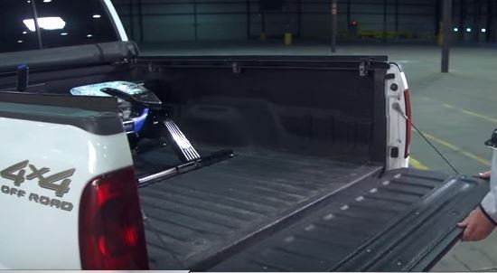

Step 1 – Lower the tailgate
The first thing you want to do is lower the tailgate on the Tacoma.
lowering tailgate
Figure 1. Lower the tailgate.

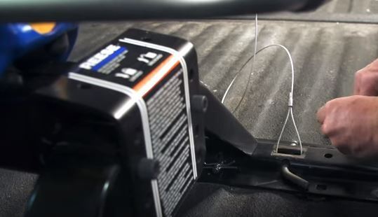

Step 9 – Secure the connection
Padlock the safety latch and connect the break-away cable to a secure area on the Tacoma.
  • Figure 12. Secure the connector with a padlock.
  • Figure 13. Secure the break-away cable.

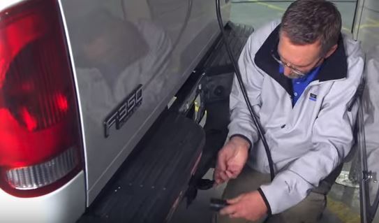

Step 10 – Make the electrical connection
Raise the tailgate, if you haven't already done so, and connect the electrical cable to the Tacoma's electrical system.
Figure 14. Make the electrical connection from the fifth wheel to the Tacoma.
