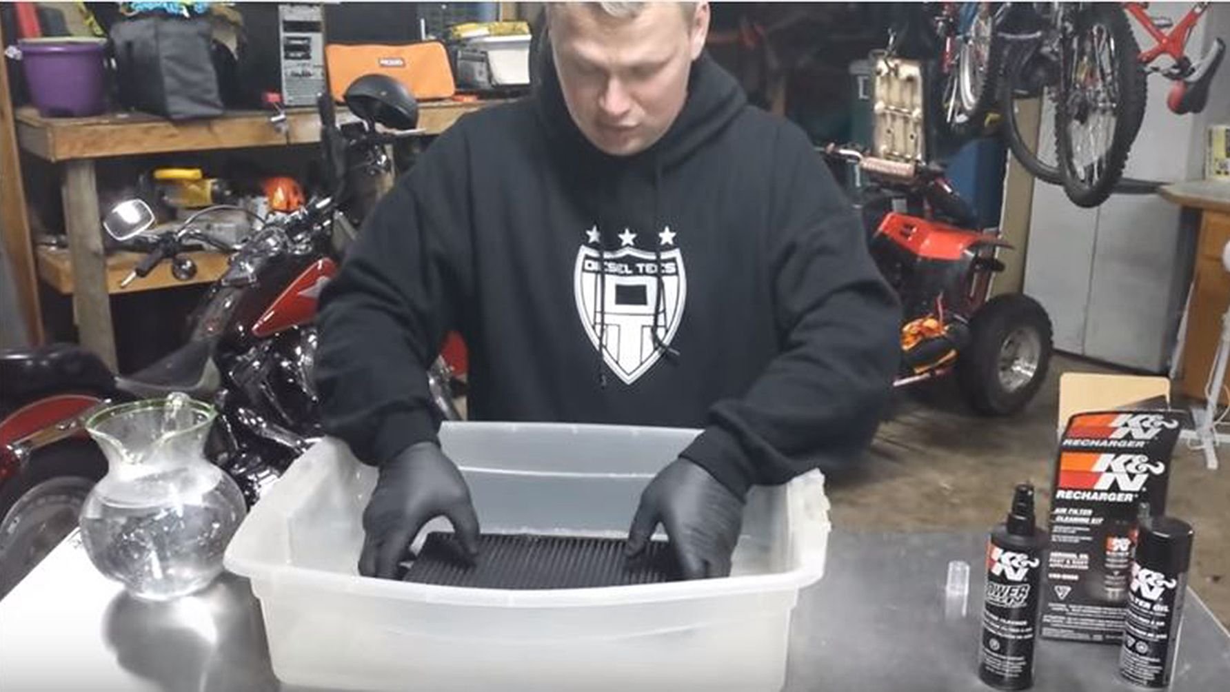

Step 3 – Clean your reusable filter
If you are reinstalling a reusable filter, clean and, if applicable, oil it.
Figure 3. Clean your reusable filter before reinstalling it.
