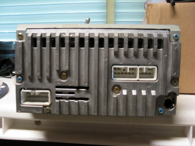

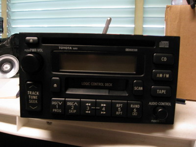

I picked up a used Double DIN tape/radio/cd for my 97 SR5 4Runner and after taking the dash apart and pulling the stock single DIN out I realized the plugs are different.
What options do I have in my situation. Would Toyota have an adapter ? Am I SOL and should just pick up an aftermarket stereo? Here are some pics to give you an idea of what I am changing too......
This is what I have now a single DIN with this plug type in the back.
How do I change from a single din tape/radio to a double din tape/radio/cd-radio_00.jpg
I want to use this double DIN with its type of plug.
How do I change from a single din tape/radio to a double din tape/radio/cd-radio_02.jpg
How do I change from a single din tape/radio to a double din tape/radio/cd-radio_03.jpg
Any help or advice will be accepted. Thanks.

Hmmm, I'll bet there is an adapter you could use altjhough I don't know offhand where to get it. Alternatively you could get a wiring harness adapter for your year Toyota AND the plug w/ cut wires for that new deck you have from a scrapped 4runner. Then you could just match up the wires.
Check out installdr.com for wire colors and labels if you need them

If you look lower in your dash there is a factory amp that needs to be unplugged so when you do that you will find the plugs that you are looking for.

if its for a 4runner or taco, follow the harness you have in there about 6 inches back and it will end in a silver box(amp), remove the two gold-ish colored screws to either side of the amp, and remove it(bracket and all), the plugs you need are plugged into the bottom of the amp.

Thank god I am willing to check my ego at the Yotatech forum door and ask questions. The guys were right about the silver box/amp for the single din factory toyota radio. Simple unplug and removal of the amp and plugged right on into the double din. Perfectly clean stock setup. Thanks yotatech folks.

BTW, on the last pic there is one female opening for another plug. Anyone know what that is.....I was thinking cd changer or some other factory option.
thats for the factory cd changer, or use an aftermarket translator and you can get a direct line in, or sat, or ipod control.
I prefer the direct line in option, alot of the aftermarket sats and ipod controls are less than stellar, plus a universal 3.5mm plug will allow you to do just about anything, sat, ipod, any mp3 player, or even a laptop.
