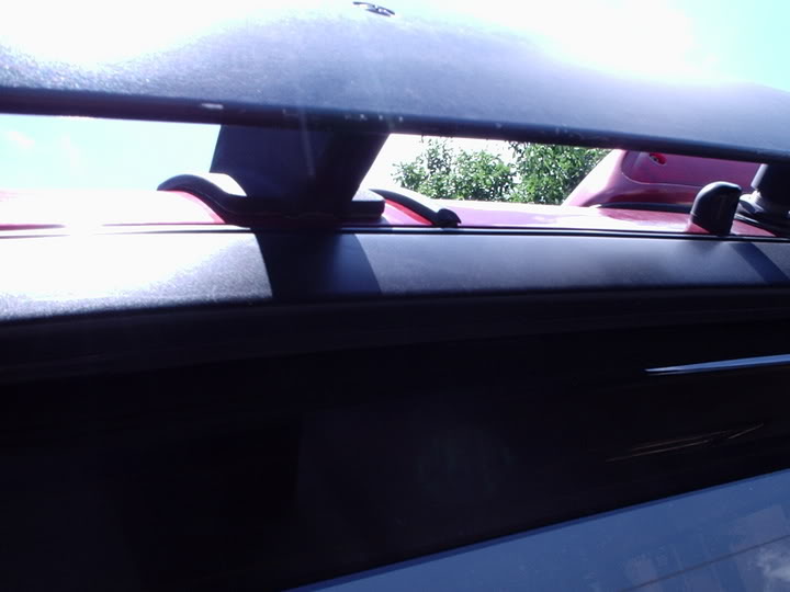

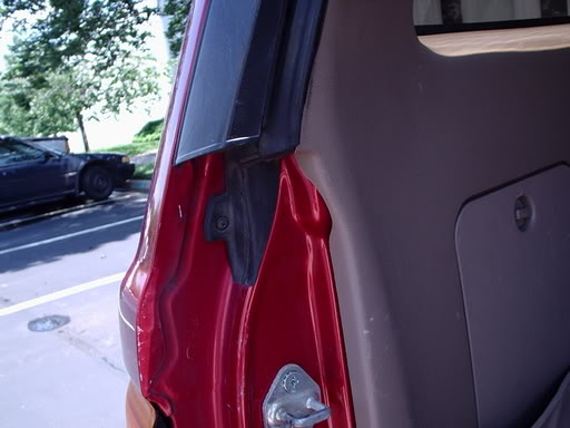

This is how I installed the antenna.
There is gap between the plastic trim and the metal body.
Unscrew the screw shown in the picture and run the wire under it.
That will get wire under the plastic trim piece.
Push the antenna wire in with a credit card all the way up and around.
