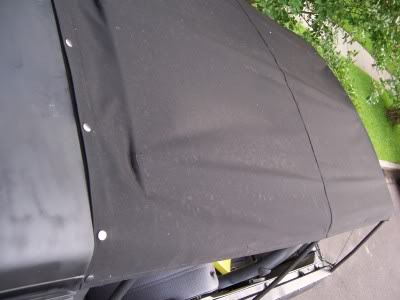

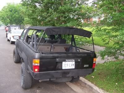

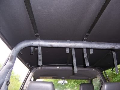

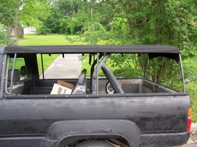

Well here it goes...this is what I've got so far. I've been having a heck of a time getting together with my g-friend's mom and I've been lazy. So far I have the upper canopy completed. If you notice the top pulls downward near the rear of the cab. I will have to relocate three tension straps to fix that, no big deal. I also would like that hangy downy part in the back go down so far. I think it looks kinda silly like that. I will also be adding some straps that tension the top left to right as rain tends to puddle up in a couple of spots (not bad, though). I love the way it is now and was considering leaving it like that, but I need to be able to close myself out of the elements sometimes. Plus I am going for as close to a Can-Back as possible just to show it can be done for under $400, let alone $1500+. If I had known how to sew in the first place and was not so lazy, this project would only take a couple of days, so if anyone wants to try this at home, don't be discouraged. It's pretty easy. So...here go the pictures. I am leaving for the summer to Mexico in June so the WHOLE top will be definately done by then, hopefully sooner. Also, check out my new black paint job. I love it. I got too many salutes with the olive drab. Cheers!

Well I finally got back to work on my soft top (yes I have been riding open air rain or shine for over a year now). I was revising the strap system on the canopy that is done so far (see previous pictures) because the straps are in the wrong place (once again, see previous pictures where the top dimples in near the fron). Well, I made it worse. If anyone has a Can back, could they please send me a picture or two of where the main tension straps attach to the top of the soft top. It seems like no matter where I put them, they are going to make "dimples". I don't want the dimples because they are not only ugly, but tend to gather puddles in the rain. Thank you to anyone who can help. I'll post pictures as progress goes on...
