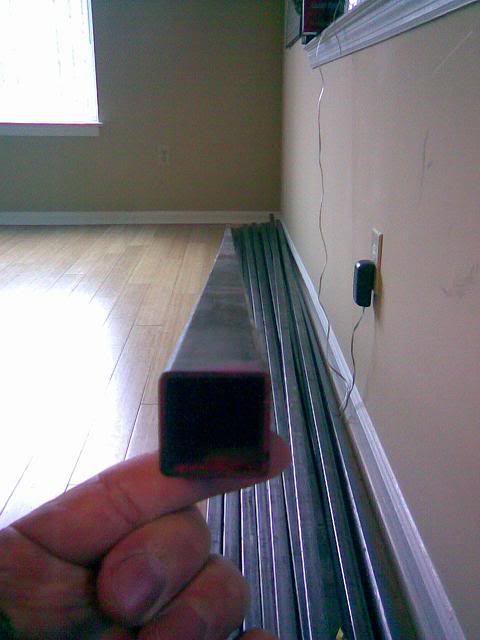

Here is the steel I picked up from the local yard, 1x1 16 gauge steel

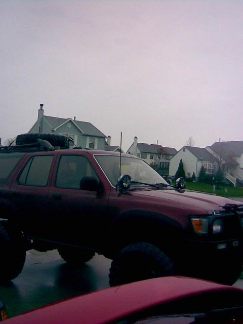

Here is just a pic of how she is sitting right now, its been ty out the last three days and a few more to come, I hate it...

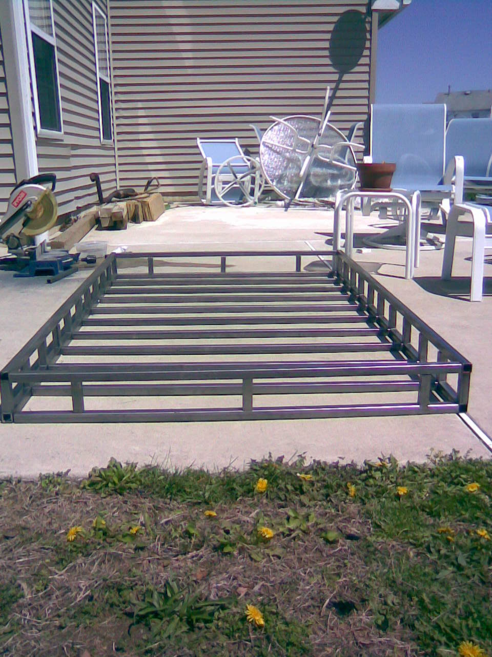

Well today I started cutting and the mock up is basically done and ready for welding which wont happen until Sunday when my buddy is available but heres what the out come should look like.

Final mock up
I think I'm still going to add some front light tabs, 2 jerry can holders. Right now im going to shop around for a yakima or thule cross bar for the front of the rack to bolt too over the sunroof, I'm still debating on whether I want to re-enforce the factory rack with better screws and bolts and bolt to those cross bars for the rear or if I just want to take down the factory system and weld the holes shut, drop the head liner and drill through the roof with custom feet. Anyones thoughts on that?
Some of the risers for the side in the second picture I obviously had to replace because they were out of margin for welding. measurements are 80x46x4.5
