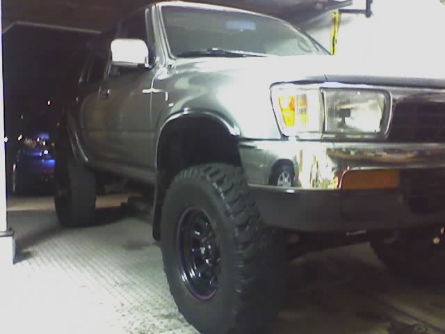

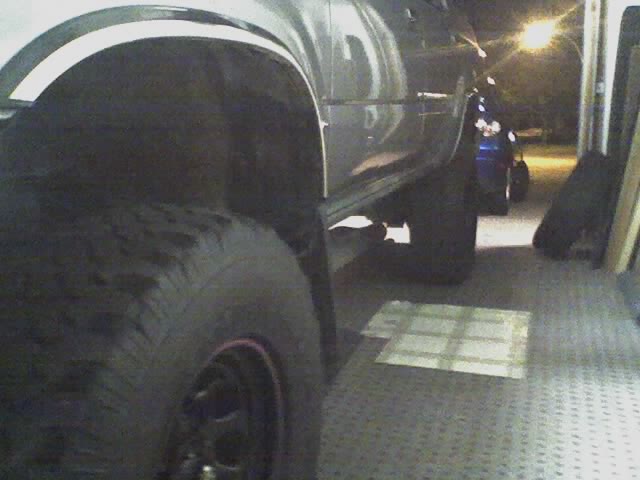

Sweet!!!! Finally Done!... Well, at least for now. Not bad, eh? Obviously the first two are from tonight, but the third was this morning at 7:30am. Just finished buttoning up everything. Toook er for a "little" cruise around the block! Yup, Spacers are in, and the OME's? Wow!! Very tight. But so smooth at the same time. Btw,in the third one, those aren't clouds in the background. It's the sweet NorthShore mnt's and all those trails were beckening me!! I swear!! I could hear them going.... Come drive over here! Climb this mountain, Go thru this giant mud pit! It was one of the things that made me work even faster! Cant wait to get out tommorow!
Quick Numbers: 37-1/8'' Front 37'' Rear. Keep in mind tho, the rears full of junk ready to go on a dumb run.
