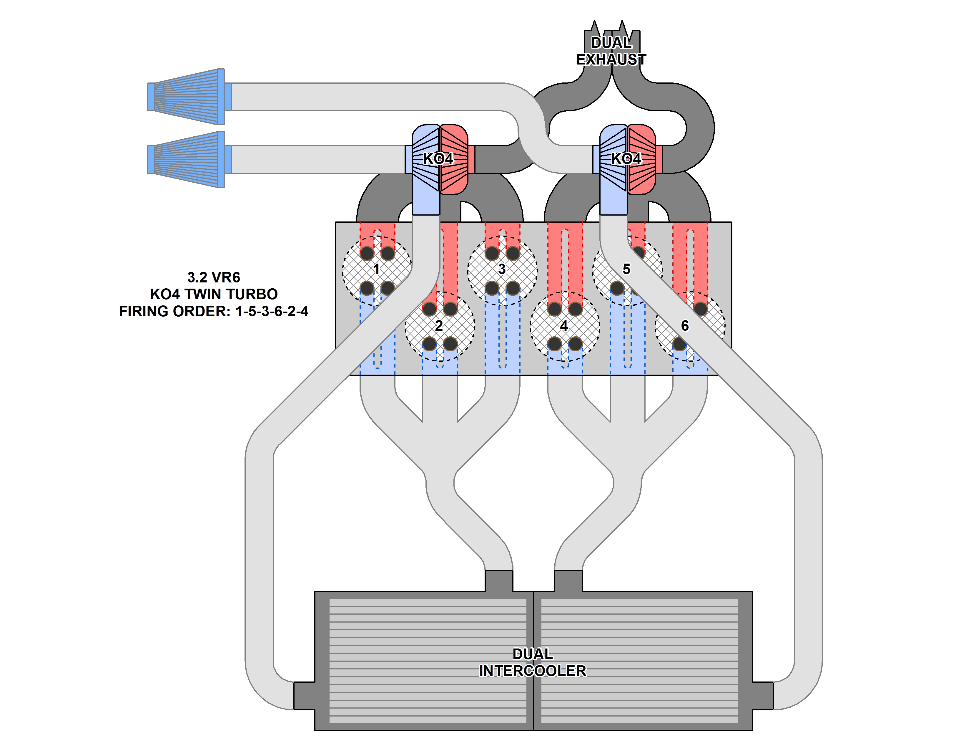

Originally Posted by slacker
don't know yet ? .. I was going to use a new URD (split second) piggyback , just kuz I have it already , but we'll see.
Unless you're trying to create stupid amounts of power, Piggyback is the way to go. I had a stand alone on my GTI and it was an absolute nightmare. I actually had a plug-n-play ECU so there was no unnecessary rewiring of factory gauges and such which made installation a snap; however, the tuning required a NASA rocket scientist to get it dialed in! My friend was really good at re-mapping and electronic tuning and even he was struggling with it. ANNNND to make it even more difficult to tune, I plumbed the turbos parallel with one driven by and supplying cylinders 1, 2 and 3 and the other driven by and supplying cylinders 4, 5 and 6. Supposedly when properly tuned, the VR6 will run like a bat out of hell with this setup (I wouldn't know because I totaled it before I could get it there). This ended up being a really easy fab job since the VR6 is a "V...In-line" 6 cylinder with a single head feeding both banks. The way I plumbed it ended up being relatively compact - I know a true V-6 is a different animal, but you may want to look into it for space savings and ease of fabrication.
I tried to dig up some pictures of my GTI, but they are on my old laptop so I'll have to dig that up and snag the photos. The only thing I had was the basic layout of the turbos and plumbing that I had in my email account from when I sent it to my welder to see if it was do-able (see below)
Nonetheless, I know you'll figure out something cool, but I figured packing your brain with ideas doesn't hurt!

here's the diagram I made for my turbo setup:

Thanks Dave .. Yep , thats pretty much the same as the 1Jz is set up
right now , I'm trying to figure out the inter coolers , and I think maybe porche ones might work ... what were your intercoolers ..

I used CX racing intercoolers. I took the two intercoolers and had them welded together in the middle since I couldn't find a one-piece intercooler that met my needs. They were still independent of each other, but having them welded together made the mounting a little easier in my case. I'm pretty sure CX Racing is still in business. You should check them out - they always had a huge variety in their intercooler selection.
