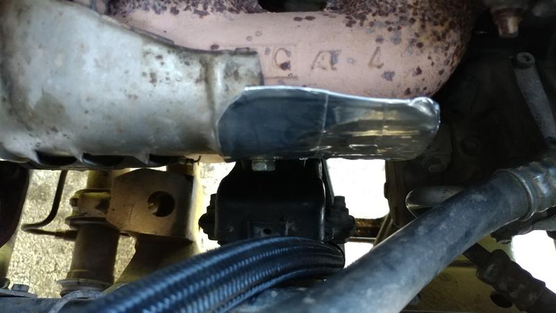

Re-sealing the oil pan:
Not much today. Drained the engine oil, removed the 2 bolts that hold the wiring harness in front of the oil pan.

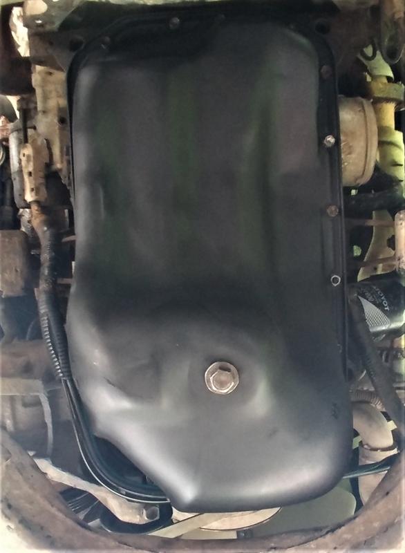

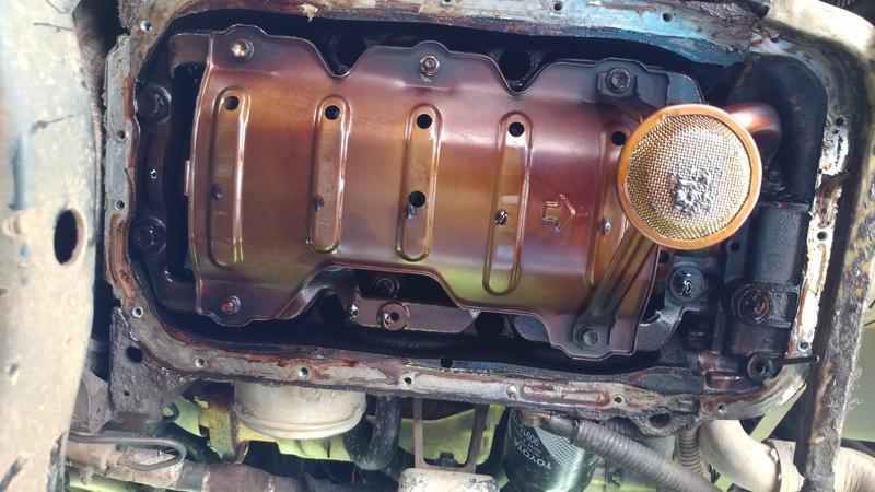

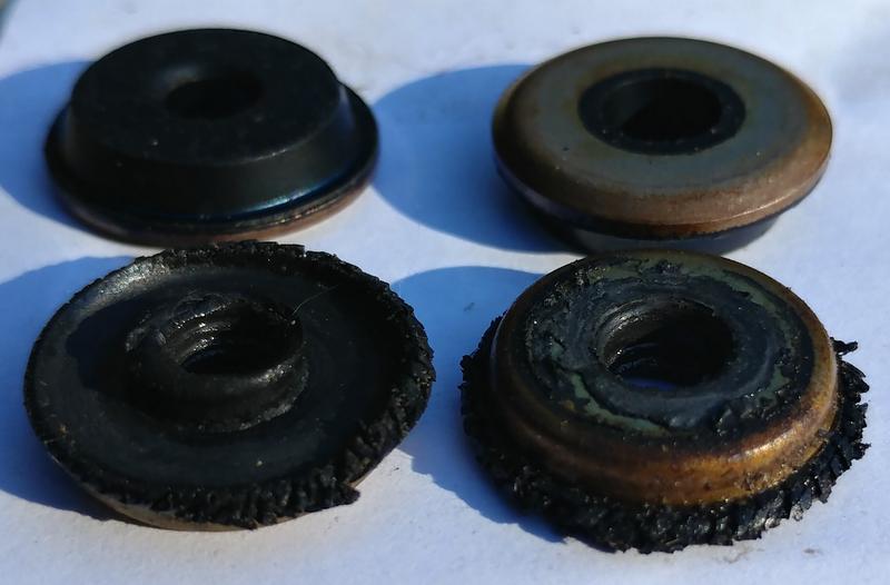

Oil pan fun.
Oil pan bolt & nut torque specs= 67 in-lbf.
Sealant part # per FSM 08826-00080, superseded by 00295-00103
That thing came off way too easy. There were 2 nuts and 17 bolts on mine (FSM says 4 nuts/15 bolts).
Undid those, used a utility knife to interrupt the seal. Got part of one side done and the pan fell off into my hand.
It was definitely leaking at the front and rear. What's left of the sealing material is mostly scraping right off with the plastic scraper.

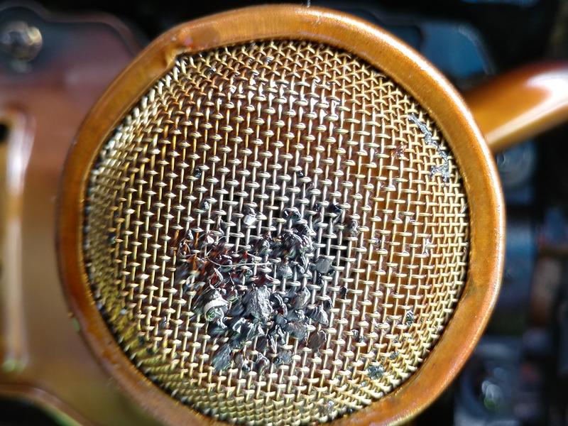

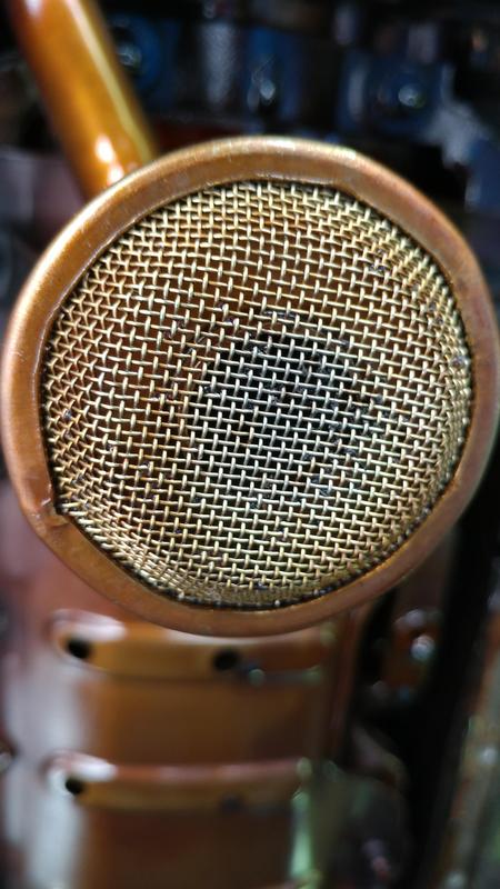

The other thing I did was to check the pick-up...
a couple of tiny metal shavings and several metal hairs, plus some hard oil deposits surrounding them. 24 years of detritus, most being bits of hard oil.
So I cleaned it up with a needle and magnifying glass, plus some packing tape
Got that far just in time for it to start storming again so we ate lunch.
Next comes the hard part of cleaning the oil pan and mating surfaces. The inside of the pan itself is very clean but for a little bit of oil deposits near the top above the oil level. The outside is a filthy dirty mishmash of oil and various dirts.

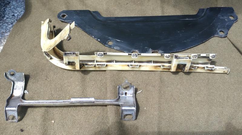

#3944
96 4Runner Driveway Rated 312,873 miles
Prepped everything, spent a bit of time wiping down the mating surfaces with rubbing alcohol (thank goodness I keep that stuff around all the time!) , cleaned the threads on the oil pan bolts, put things where they needed to be- the bolts, torque wrench, 10mm socket and the 2 extensions needed...
FIPG ready to go, timer set- you get 5 minutes to put the surfaces together. I just barely did and got a few bolts in, whew!
There is about 800 lbs of dirt on my everywhere.
Also, cleaned up a lot of the oil and now ready to install...
About to go back out and put the flywheel inspection plate back on (it's dry in there, yay!) and the wiring cover that holds the starter wire in front of the oil pan. Just wanted to check when the last oil change was....
2500ish miles ago....gonna throw a new filter on and complete the oil change a wee bit early.
Hey, no oil will be dripping all over the skid plate this time- and reaching the oil filter will be a breeze.

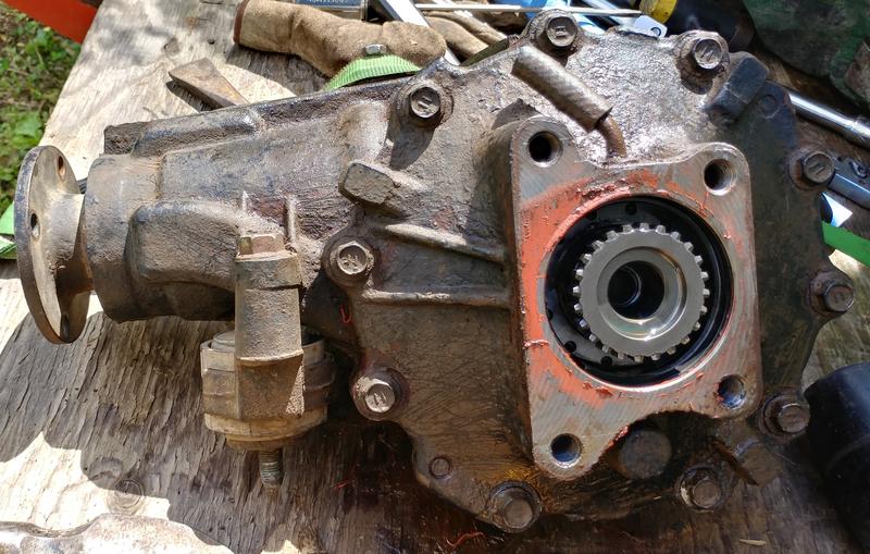

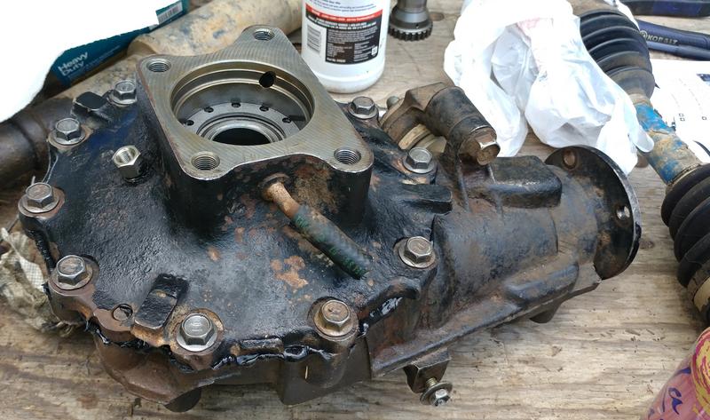

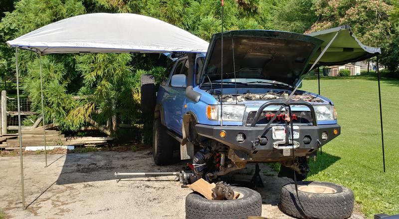

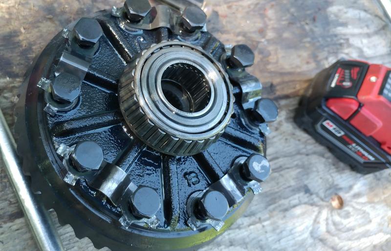

Slooowly pulling the front diff apart.

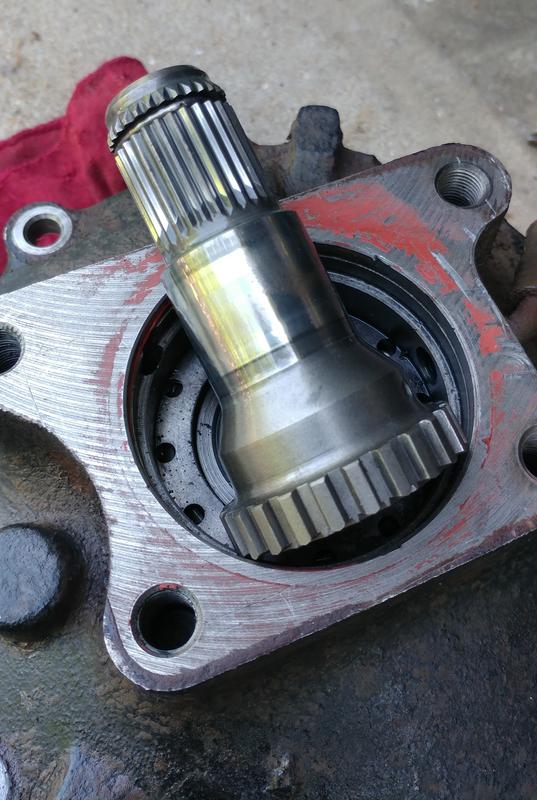

The add/diff tube has an E14 external torx socket. 4 bolts, 2 long and 2 short. There are two other bolts that you'd remove for just the diff tube, but we want the whole thing.
Those suckers were really on there, I found I had to secure the diff to my 'workbench' so I could put some oomph into bolt removal.
and here's the gear part of the add shaft. I'll pop that out later, first I took the clamshell apart. After I soaked the 2 guide pins with b'laster the hubby came up with a scary looking prybar contraption that worked well so we didn't test my weird idea. Ah, well. It worked, clamshell came apart.
To get the add shaft off the carrier it pops out with a c-clip just like the half-shafts have. With the carrier out I was able to get to the bottom of it with a screwdriver protected with a rag and pop it out. I took care but didn't worry too much as the carrier won't be part of the equation any more.
And then I bent the keepers out and used the impact to remove the ring gear bolts. A plastic hammer, a bunch of taps, it's off.
I've just ordered the one carrier bearing (one comes with the Arb unit) and both seals. You only have to damage the left seal, but I figured I'd get both. I should have done this part sooner, but am not in hurry mode.
Did I mention this whole thing is going to take awhile?

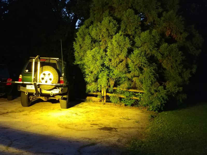

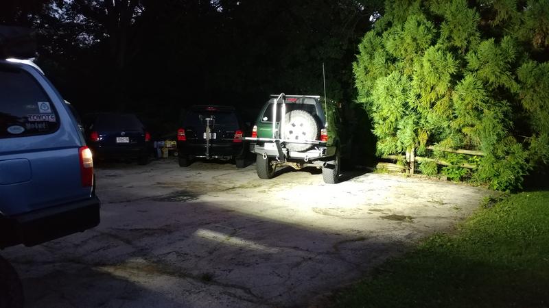

Finally wired up the somewhat el-cheapo led pods for the auxiliary back-up lights.
House Tuning floods, 3" pods. One of the pods had a cracked keeper for which they gave a $15 refund. When I emailed they replied very quickly. The english was obviously second language or babelfish-type stuff, but we were able to communicate.
I can't do a picture of illumination because it's up against a tree....it will have to wait.

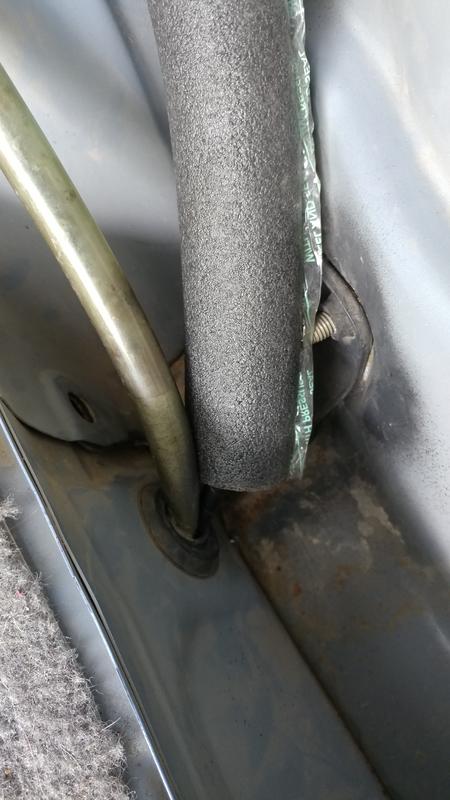

Anticipating return of front diff soon, until then doin' the piddly and also important stuff.

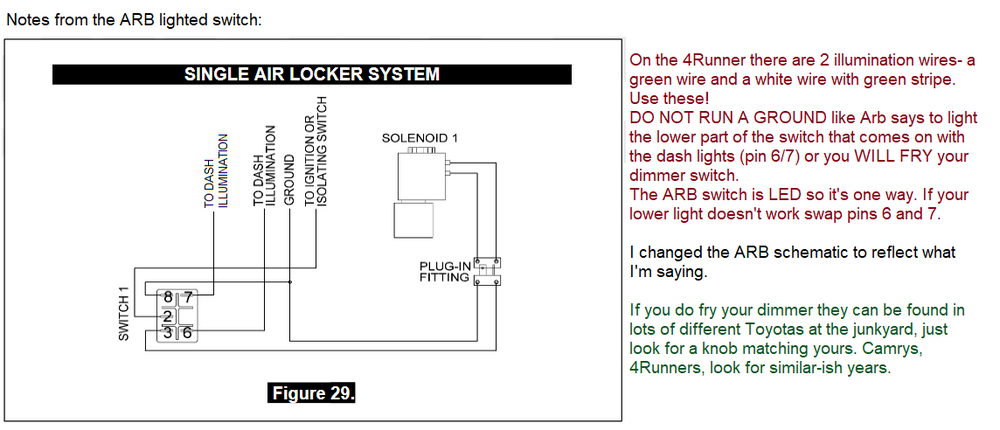

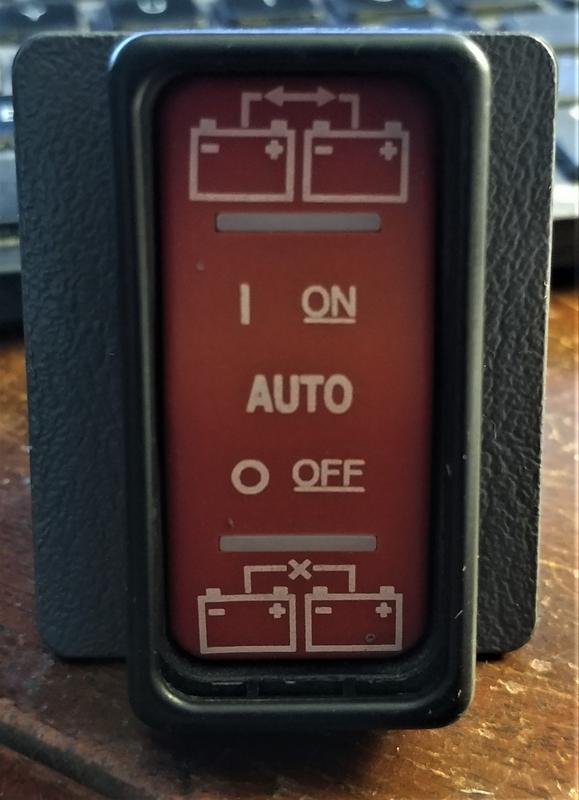

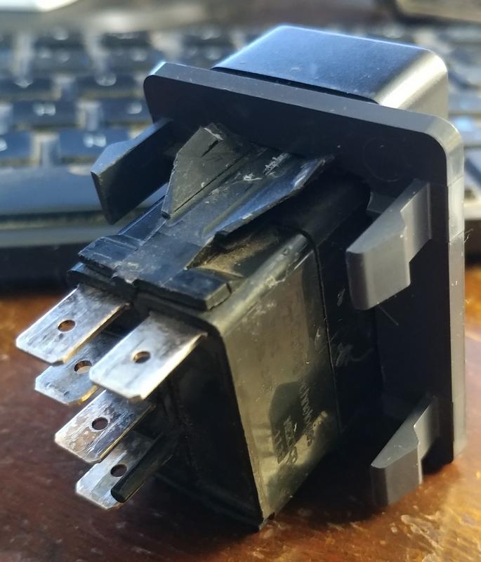

Worked a hole in a junkyard switch blank to accommodate my blue sea dual battery switch- the old blank had broken clips and the hole was not all that well done (by me!) anyway. This time I'd more success.
I also bought a 2 pack of connectors for Carlise switches- one for this and one for the Arb switch. They aren't great, but better than having to undo all the connectors and keep track of where they go every time I drop the panel....especially as there will now be two of them.
The Arb switch will fit into the switch blank where my garage door opener used to be. It may never come out again, but that's why connector.

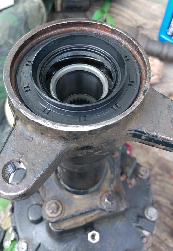

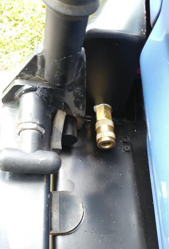

The diff is back!
Yesterday I installed the add shaft (soft hammer, popped right in) and cleaned up the mating surfaces for the tube, then figured out where to put the new air manifold that I needed because now I have more lines than ports.

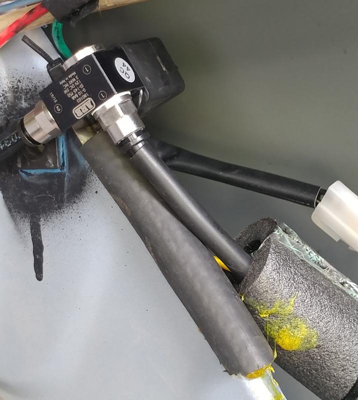

I still have to test the locker before install, after today's time spent finishing up moving air lines around on the air tank it's ready for the testing.

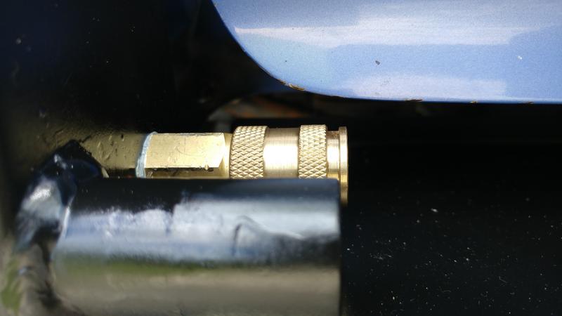

Everything is arranged and the air line for the locker has been run up to the front.
102 heat index, 62% humidity. Hot and super-sweaty, but it turned out to be better than when it cooled down enough for the crazy-bitey mosquitoes to attack in droves. Done for the day!

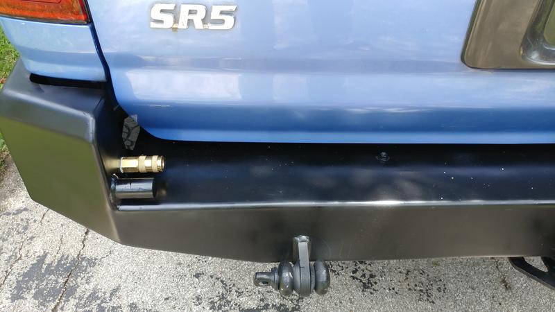

My RD90 came with a new style bulkhead fitting kit and no instructions as to how it goes. No worries, I found pics on Northridge4x4's site, they're hiding on this page:
https://www.northridge4x4.com/part/c...ad-fitting-kit
It looks like it can either be set up as an 'L' or straight out, depending on clearance.

Had to work on both sides of the truck today so I used both the Bus Depot and the Overland Nomadic awnings because can.

96 4Runner 312,873 miles
Today I installed the diff tube (58 ft lbs, E14 socket, Toyota FIPG 0029501281),
I'd thrown the seal into the freezer the day before. After cleaning the area up on the passenger side I found the shape of the seal was not the same as the one I installed on my original front diff years ago. The dust shield won't work this time. What did work was my oil filter cap wrench. I got everything set up and the diff was still strapped to the table from installing the tube. Grabbed the seal out of the freezer and stuck it in the tube as straight as possible, then gently tapped it the rest of the way with the cap wrench and rubber mallet. Toyota part# 9031147013
The driver side was smaller so I looked around and found a plastic orange juice concentrate can in the recycle bin. Same as the other, set it in by had as straight as I could, then gently tapped it the rest of the way with the oj can and rubber mallet. It actually managed to maintain a shape long enough to get the seal in. Toyota part# 9031147027
Chilling the seals seems to really help with this job.
It sits just below the lip on the diff tube. The other side is a similar set-up.
After that was done bike ride, weed whacking, mowing, and veggie garden got in the way. More tomorrow.

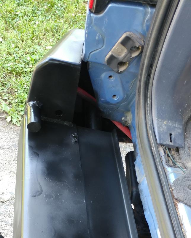

Today I relocated the air chuck for the OBA. I wanted to be able to access it easily without having to open anything on the truck.
After lots and lots of searching the frame, body, and bumper for a place that was mostly out of harms way and not too close to the tire in case of muckiness I chose a spot behind the tire carrier latch.
After lots of checks to make sure the latch could still close and the tailgate could clear it I drilled a hole, routed the air hose, added the v-style air chuck.
A hole
Finished
Clearance between chuck and tailgate while being opened
Clearancce between chuck and latch

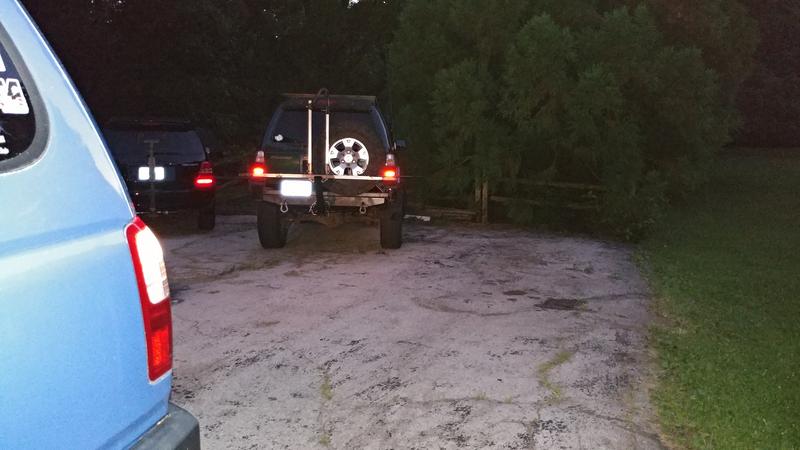

And the aux reverse lights. Same stated lumens as the halogens that were there, these diffused flood led cubes are brighter. They came with amber covers that I'll prolly use. Still need to work on aim, try to minimize eyeball attack for anyone who happens to be looking their way.
Not quite dark yet, but you'll get the idea...

Made a heat shield to protect the already sleeved air line for the ARB using an old license plate and some aluminum tape. The rubber a/c hose is about the same distance away so life should be copacetic.

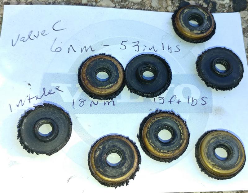

And I replaced the valve cover bolt grommets. The ones I'd gotten from Yota Shop when I did the head gaskets have degraded terribly. Gently tightening the bolts down gently helped a little but not enough. I've been putting up with slightly leaky burny oil smell for awhile now but the leak has increased to the point of un-ignorability.
Didn't even pop off the valve covers...getting to this point when you're doing what I did is quick.
Comparison of the old vs new grommets
Old grommets with torque specs for vc bolts and plenums...
I also worked on mounting the solenoid for the front locker.
Because I'm not using an ARB compressor I needed another fitting for the solenoid to connect the line to my air tank.
Had trouble finding the part because instead of the old 5mm line the new stuff is 6mm.
Luckily East Coast Gear had what I needed for a reasonable price + ship and service was quick too.
Item: ARB Compressor 6MM Push Lock ARB- 170213SP

Spent time today mounting the solenoid to the passenger side cargo area...

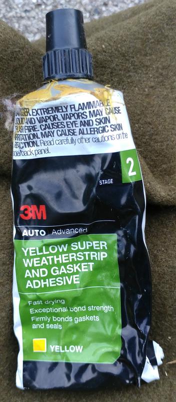

Gorilla snot to glue the piece of hose to the edge of the metal to protect the line, solenoid zip-tied to the protected edge
Line run through the same grommet as the rear passenger sunroof drain
To a water separator that's attached to the air tank in the spare area.
I am using a 105psi pressure switch for the compressor as called for by ARB.
