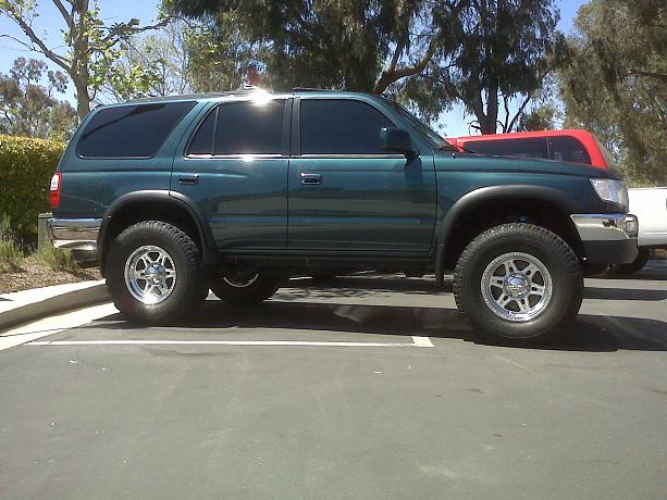

Just so everyone knows, I'm not a vendor...just passing on a good one. and as a shameless plug :-) here is a pic when I first got my racelines, this was when I still had the at's and one when I had the used mt/r's mounted
