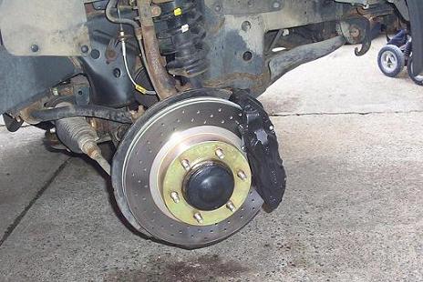

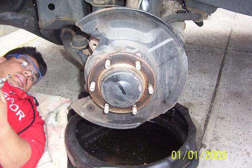

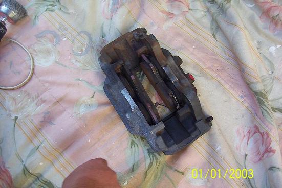

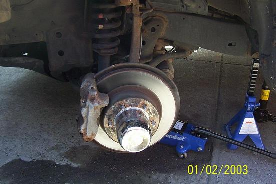

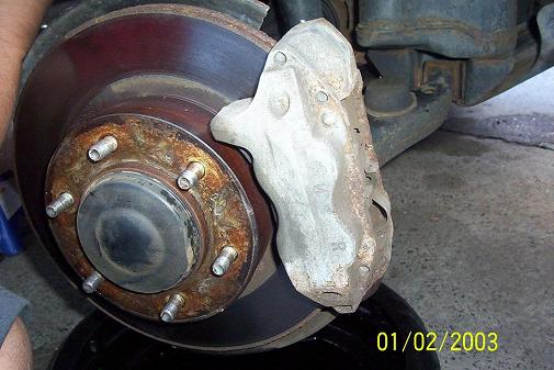

I finally got around doing this upgrade... I installed 2005 Tundra calipers (231mm) along with Brembo Sport rotors, Goodridge SS brake lines and Hawk HPS pads. Everything was pretty smooth, except for removing the old OEM brake lines. You gotta be careful you don't mess up the nut that holds the hard line to the brake line. Other than that, it was ok. I definetely recommend this upgrade.
Now... what do I do with those drums??
maguirre
00, SR5, 5spd
Attached Thumbnails Tundra brakes & SS brake lines on my 4Runner-tundra-before.jpg   Tundra brakes & SS brake lines on my 4Runner-tundra-before2.jpg   Tundra brakes & SS brake lines on my 4Runner-oem-passenger.jpg

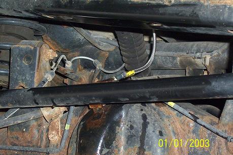

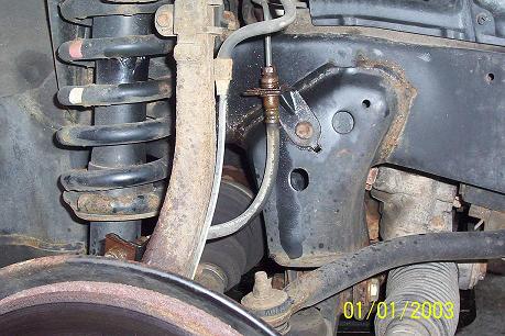

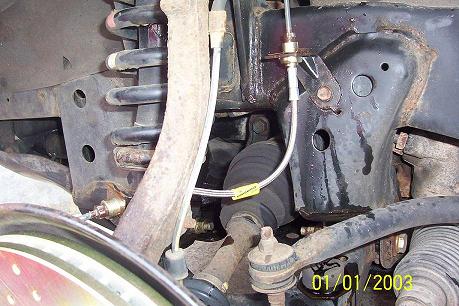

Here are more pics....
The OEM brake lines and the cutting of the dust shield to fit the massive Tundra calipers.
Attached Thumbnails Tundra brakes & SS brake lines on my 4Runner-oem-brake-line2.jpg   Tundra brakes & SS brake lines on my 4Runner-dust-shield-cutting.jpg   Tundra brakes & SS brake lines on my 4Runner-oem-brake-line.jpg

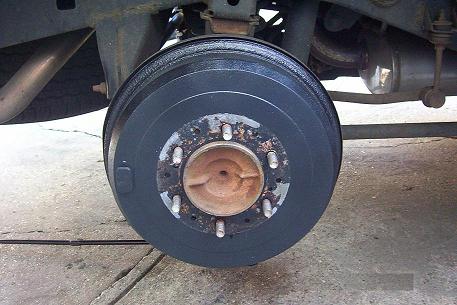

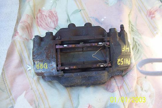

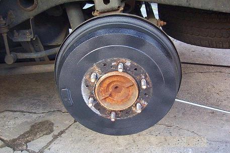

Here are the OEM driver caliper (w/hub cap) and the painted rear rotors.
Attached Thumbnails Tundra brakes & SS brake lines on my 4Runner-oem-driver.jpg   Tundra brakes & SS brake lines on my 4Runner-drum-passenger.jpg   Tundra brakes & SS brake lines on my 4Runner-drum-driver.jpg

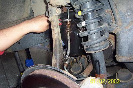

Here are the Goodridge brake lines...
Attached Thumbnails Tundra brakes & SS brake lines on my 4Runner-driver-ss-brake-line.jpg   Tundra brakes & SS brake lines on my 4Runner-rear-ss-brake-line.jpg

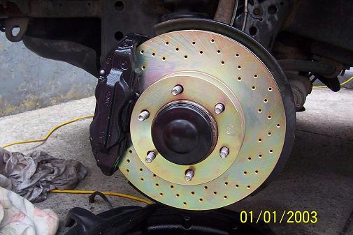

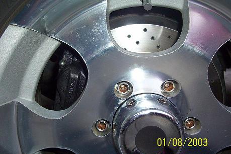

Here's the complete set up: Painted calipers, Brembo Rotors and brake lines.
I didn't have to modify my wheel since I'm running 17" inch AR wheels.
those are drums my frEnD!
Sorry,... wishful thinking.
