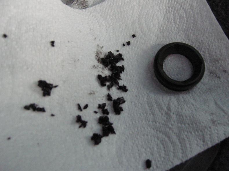

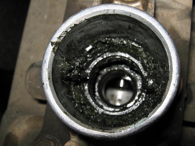

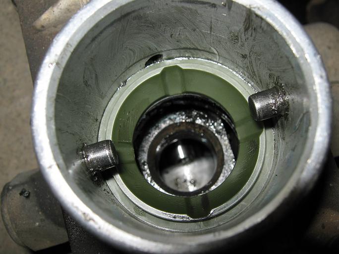

Ok It was indeed the shifter seat bushing. this thing was GONE! I ended up going to the stealership, i couldnt wait for MC. There was only grease and little rubber chunks where it was supposed to be. Changing it made all the difference, it feels like a totally new tranny. Thanks rocket!
pic1-before
pic2-rubber chunks i pulled out
pic3-after
pic1-before
pic3-after
