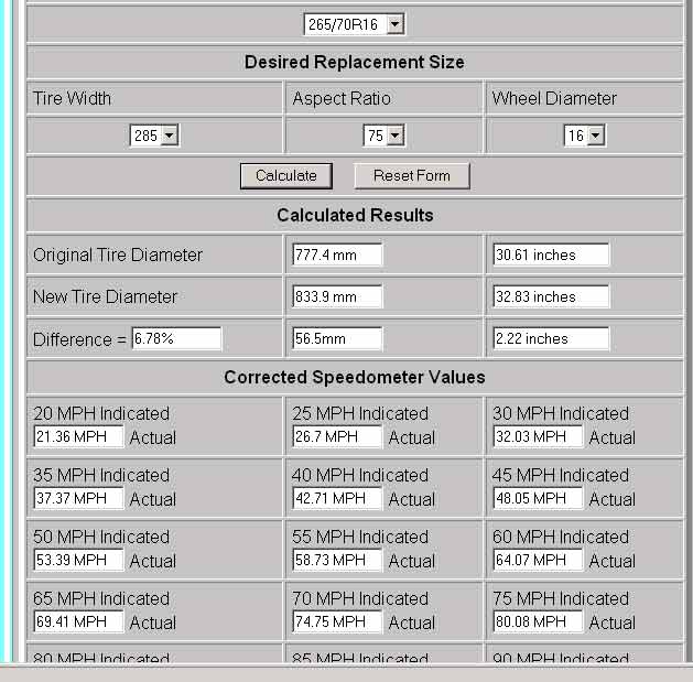

https://www.yotatech.com/attachment....&postid=108827
The picture above is for the most common upgrade to 285's, here is the link below to do it for yourself:
http://www.csgnetwork.com/lttrucktireinfocalc.html
