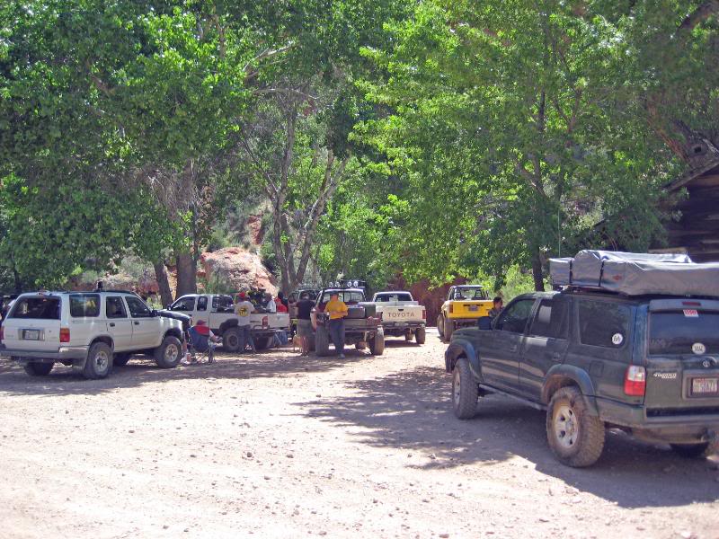

I drove about 30 miles, offroaded all day and drove to Tucson and back to Phoenix. (about 120 miles each way)
I was doing 65 to 75 the whole time. I used the supplied mounting hardware and mounted my RTT to the 01 Toyota 4runner factory roof racks.
I never heard it move, I watched out the sunroof a LOT to check on it and it never made so much as a itch. Even swaying back and forth crawling on rocks it never moved on the stock racks.
At 75 the drag was noticeable. At 65 it was almost non-existant.
All around I'm happy and I'll be getting some shorter bolts and slightly wider plates to mount it, but otherwise it will just stay bolted to my stock rack until I find something better.
