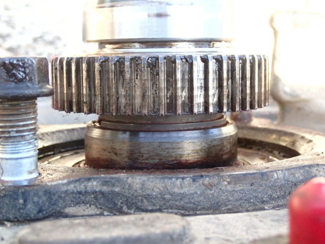

On my 96 4Runner the shop I used didn't know the parts are spaced and not just pressed together. The resulting leak drove me nuts until we figured out what they'd done.
It was an easy mistake to make that would have saved some aggravation if they'd been paying attention.
As it should have been:
