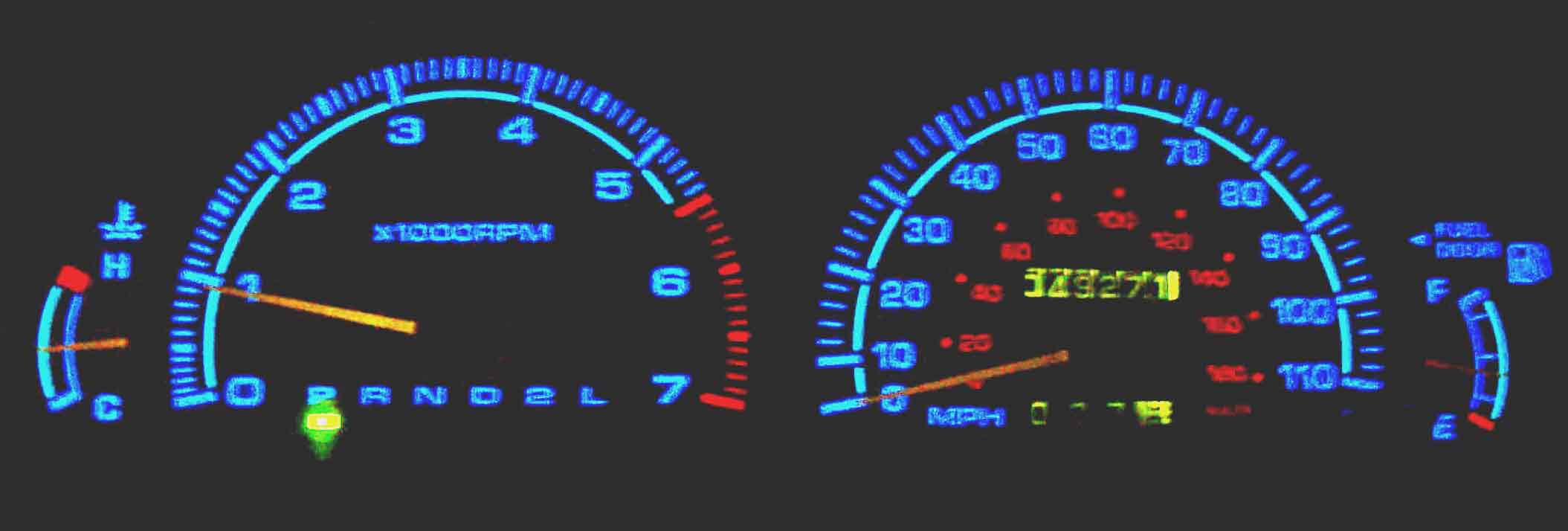

Hey Mad, you can get some Blue 194 bulbs at walmart so the mileage shoes up in sort of indiglo to. here's mine with just the blue bulbs installed. I not that happy because I only gained about 1.57674 hp after installing the blue bulbs.
gauges before console completed
blue gauges

Keisur: HP gains from bulbs---I've heard of that. Amazing. Hey, looks like you might have missed the center bulb as your center is still white. On my 99, there were 3 bulbs. Is it the same for the 98s too?
I know, I can't figure it out. I think it was the bulb I put in there. there are 3 and I replaced all three but I think that one of the blue bulbs was a dud or something. I'm going to crack it open to check it out again tomorrow. of course I didn't notice until I put everything back together. I also have to find some different blue plastic opaque sheeting to make the little discs for the turn signals, the ones I used are too light and you can see the bulb through them when they light up. luckily those blue bulbs came in packs of two so I have an extra since I bought two packs.
Now that I think of it the light would show up greenish if I missed on because they have those green prophylactics on them. ya know?
