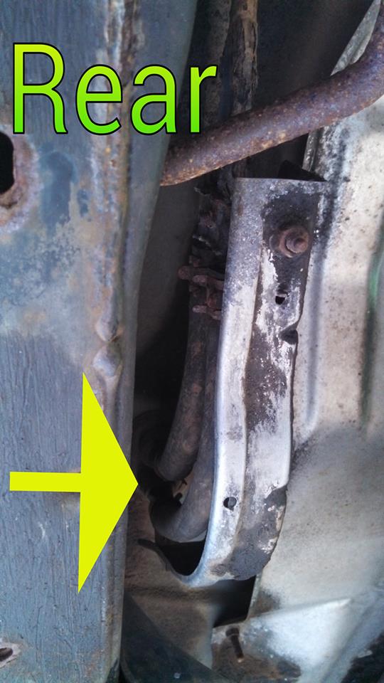

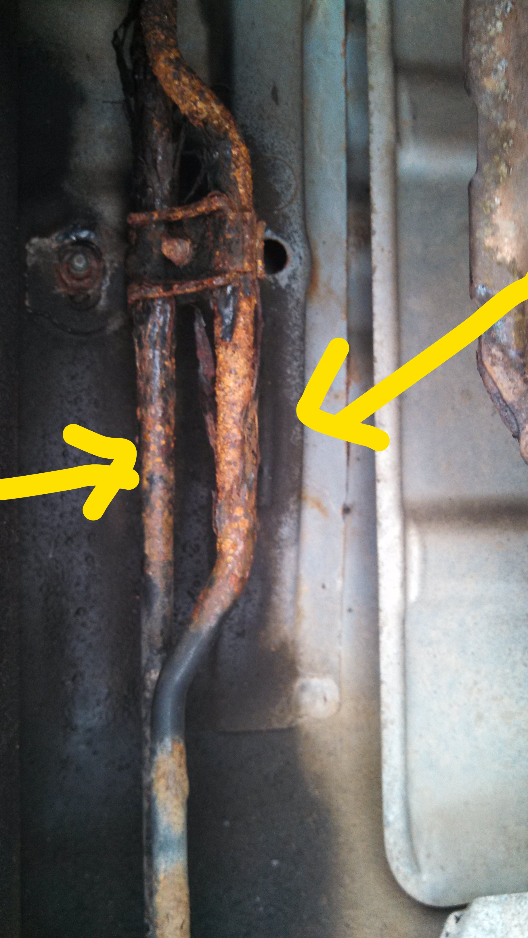

I have a leak from these obviously rusty lines. What are they? And how much would it be to replace them? Thanks!

Details about year, model, engine, etc.? Have you followed where those lines go to?

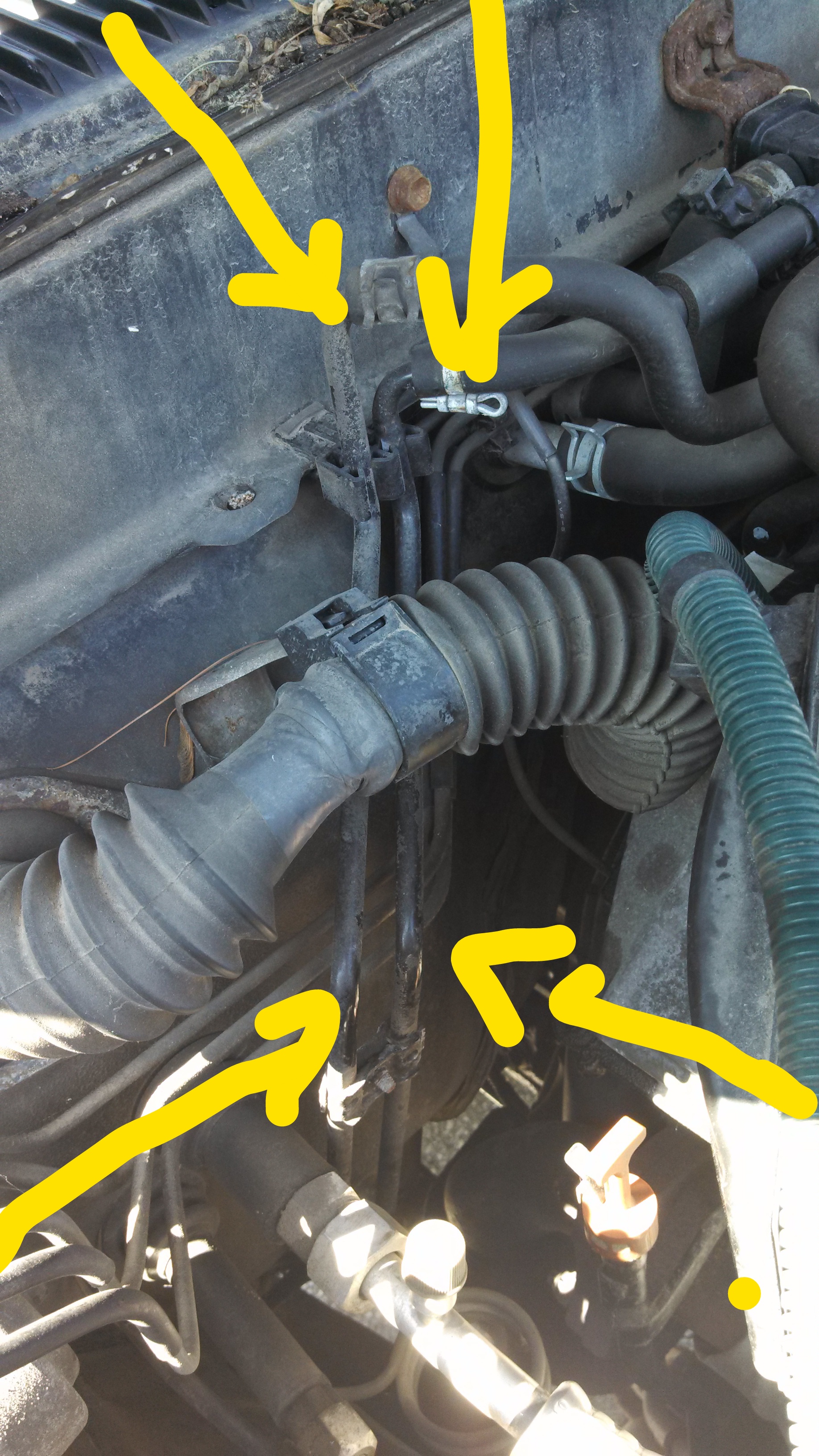

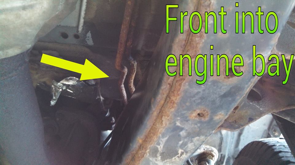

It's a 1997 4Runner with a 3.4 V6. I followed it up into the engine bay (first pic) and back to where it goes into rubber hoses inside of the body. I was replacing the oxygen sensors when those lines started leaking. No clue what they are. I'm trying to learn as I go. Thanks!

Rear heater water lines from here.
The pipes in the picture on the left above tie into the heater control coolant lines, correct? A wider shot of the pic would be good.

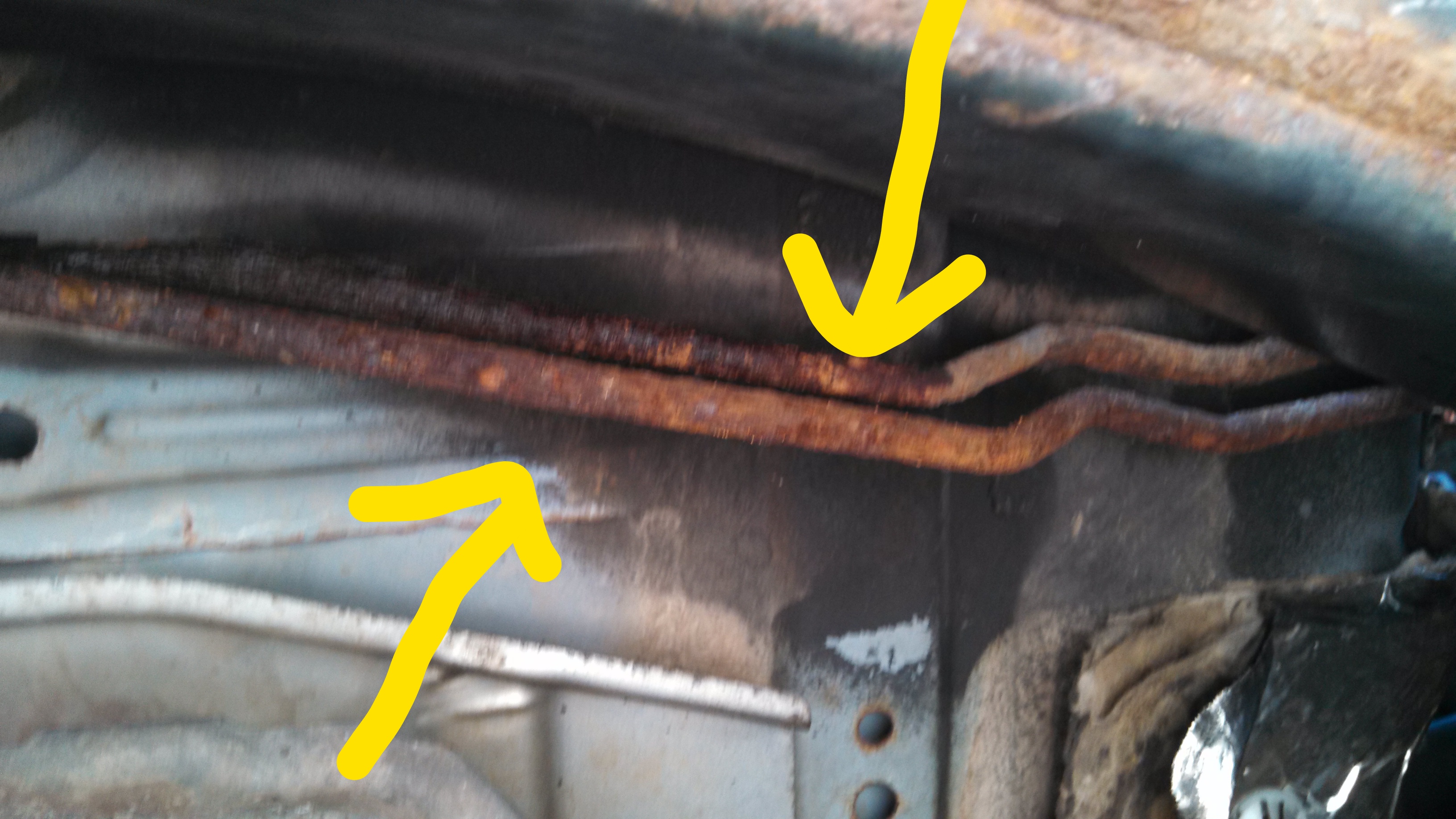

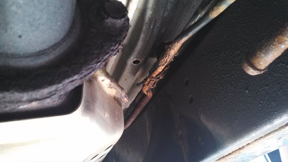

I took more pictures, but I am pretty sure it is the water line. What does that do? Sorry for all the questions my mom used to be my go to person but she passed away. Thanks for all your help!

Those are the feed and return lines for hot coolant to the rear heater. Without them you would have no rear heat, which I imagine you would want in Wisconsin during winter.
Both lines come as a set. The tough thing will the getting the rusty bolts loose. A penetrating oil like PB Blaster will be your friend.
If those metal lines are leaking, it could cause you to loose all your engine coolant. Not a good thing.
So, if they are leaking I would block off the feed and return line as it leaves the heater control there on the firewall i.e. use one of the rubber hoses and just connect the feed and return to make a loop.
