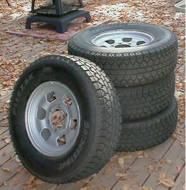

1) Tires - I've searched a bit through the site and see big props for the Bridgestone Winter Duelers or Blizzaks (same?) This is a big one for me I like traction and I drive on snow and ice a LOT.

Have a look at Nokian tires. They are pretty awesome. I've got PIAA fogs and they work great in the snow when mounted as low as possible. Also, how about chains (if they are allowed in your area)?

I highly recommend studded snow tires over Blizzaks. Get a set of 4 and carry a set of chains with you. I also recommend that you carry road flares, GPS, CB, Cell phone, extra set of warm clothes, hand and feet warmer, spare water, food, a nice set of driving lights (Hella or Piaa), a hand held spot light, jumper cables, ARB or TJM with winch.

Save yourself a ton of money on tires and get a good set of chains all the way around. Don't get tire cables, get CHAINS. You can have bald tires and still have more traction with chains than any Blizzak tire. You also won't need a locker if you have chains. Learn to drive your truck without the locker. You'll be better off in the long run. DON'T AIR DOWN YOUR TIRES! Especially if you install chains. They'll rip apart. Your tires were designed for street pressure. They will perform the best on street pressure. Unless, of course, you have Intercos or a pure off-road tire.

I've never had a problem with my BFG AT/KO's in any snow conditions, even when I've driven past a suv littered Interstate 91 on my way up to VT. A dedicated snow tire would probably beat them though. Chains you know are a must in certain conditions.

I second the idea of studded tires over traditional snow tires. I've driven many miles of snow in a Subie with both types. The studs work better. You're golden with the chains. Mike @ XtremeOff-Road will get you a great deal on a bumper. clicky TJM T15 might be a good bet for you. It's all about personal tastes. I have the ARB Sahara Bar. A Warn M8000 winch will fit nicely. Do you really need it?
