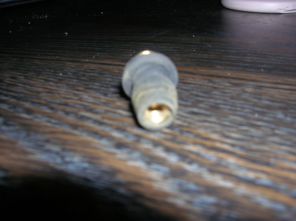

I found a perfect solution to the flimsy toyota option: a screw with a rubber nut that expands as it is tightened. I found a bag of 4 at either Home Depot or Lowes. I'm surprised toyota didn't do this from the beginning as it works WAY better than the original clips. I did this modification because when i got the runner, there were 2/4 clips missing! i'm surprised the deflector didn't fall off while driving!
to give you an idea, i'll go get a picture of one (because i can't, for the life of me, find a picture online...)
edit:*VALUABLE TIP: when making the holes bigger in the deflector (to fit the fastener), step up the drill bits incrementally! do not just make the jump to the large size or you crack the deflector...don't ask me how i know...*

here ya go: i didn't realize it would be such a PITA to remove...SO easy to install...
you can see in the second picture the threads for the screw are only at the end of the rubber nut piece, thus expanding the middle of the rubber outward, effectively securing the deflector:
