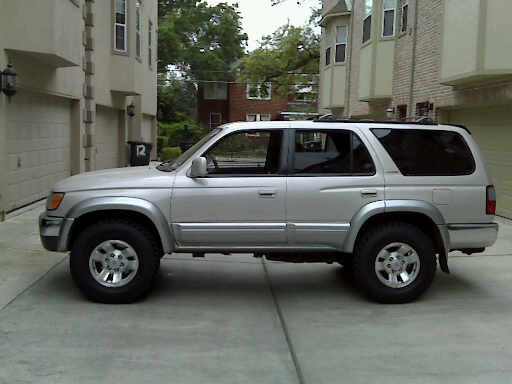

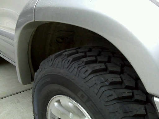

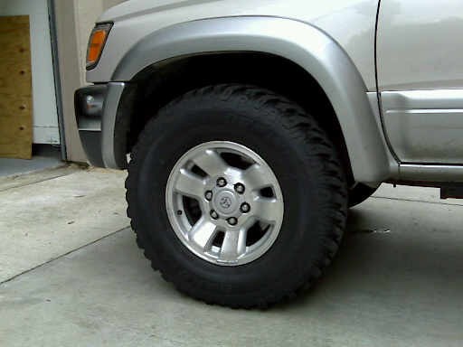

Well I did it. Decided that my long-running Nokian W/R's needed replaced and after much searching decided I was going to give the Definity Dakota M/T (Pep Boys house branded name on a Cooper built tire) a try.
I decided that since I was returning to stock size of 265/75-16 with the M/T vs. my old Nokian's which were 265/70-16 I wasn't going to try and push the 33" area yet.
So on Friday night in Houston I paid my roughly $600 for the fully warrantied, lifetime balanced and so on, Dakota M/T's and had them installed. I'll be getting roughly $120 of that back - so on the whole it seems a decent deal.
I was leaving the store an hour later. On the way home I thought "this was the biggest @#$@# mistake I've made in a long time!" and was horrified by how not round they were. Truck was in my opinion not safe. But as Pepboys was closed already for the evening I had little choice, so when I got home I experimented. Bringing the tire pressure up from 32 to 42 seems to get rid of a lot of the wheel/hop and oscilations - but not all of them. 48, 55, 62mphs were all still bad with shaky steering wheel and the truck pitching sideways on hard breaking tests .
Got up next morning and back to PepBoys to sort it out. After they made me wait 2.5hrs for attention - we got down to the bottom of the issue. Once again the non-hubcentric 4Runner wheel was/is root cause. I basically had to stand there in the service bay working the tire balancer with the manager - because his staff would say "see the wheel is bent" because it was of course traveling in an oval shape. Mind you we did this for each of the 4 whls. I would then draw their attention to the line of the hub contrasted to the hub of the balancer and point out that it wasn't round there either proving that it wasn't mated correctly.
Total time: 4hrs later we re-re-rebalanced all 4 tires and things are almost right. I think if I find a shop with a lug-centric adapter and have it done correctly they will be perfectly smooth, as it is right now it's barely detectable to driver, not at all to passenger.
Road noise: holy cr@p these are quiet M/T's. Granted I'm willing to bet they will become louder - but they are barely louder than the street tread I had on before at highway speeds, windows up or down. Yes you hear them on surface roads - but that's to be expected and it's somewhat pleasant.
Inflation: seems to be critical and I'm still finding the sweet spot. Right now running 38psi front 35psi rear and getting good contact patch across surface of tire, and has increased straight line stability under hard breaking.
Only time will tell how they feel in long run - about 150miles on them so far but I've changed my mind from thinking it was a huge mistake, to thinking it's a good deal. Perhaps someday I'll even let the truck see mud to investigate what the tire was designed for. I bought them cause they look cool, and not afraid to admit it.

Not bad looking. Hope you get the kinks worked out.
