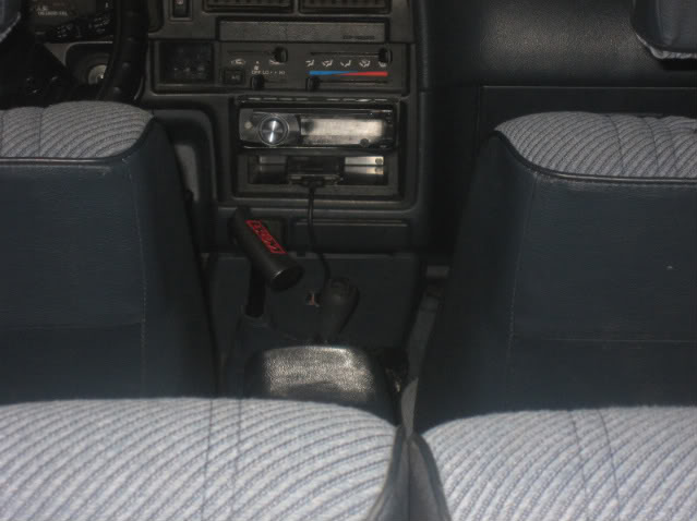

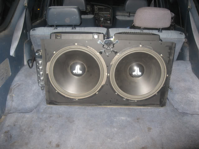

Heres mine
2 15"JL's custom box originally designed for my Honda. Crappy paint flat black looks like gloss when its on caulk..lol.
Pioneer head unit with Ipod control
I have crappy Sony mids and highs for now but will soon be upgraded

I got it all together.. Sorry I have been a lil buzy trying to get these damn viruses off my computer... here are some pics of the BEAST HEART!!! Sorry I don't know how to make smaller pics>>>
This is with hatch open...
Just a shot through back window... WTF is cargo space???
This is what you see when I'm riding with window down... Gotta love the logo!!!
