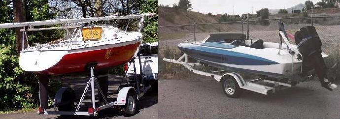

What engine and trans? and most importantly - with that much lift what tires are you running and did you change your GEARS?
With my '85 22re 5sp it was 3500 lbs rating. Towed either of these all over Oregon with no problems at all. The sailboat weighs about 2800 on the trailer, the ski boat probably 2200 or so.
