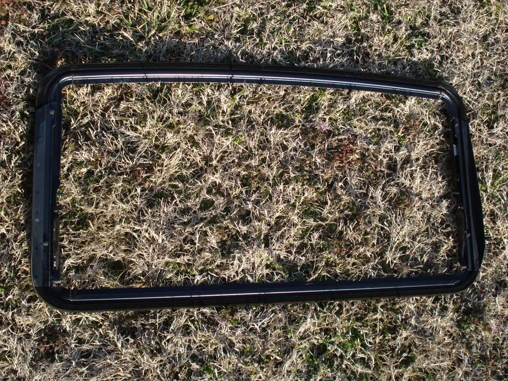

Clear shot of the separation -

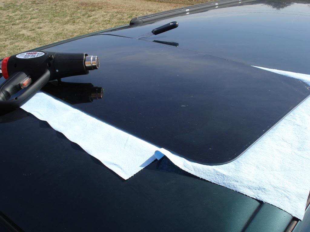

Not much heat was needed from the heat gun to release the glass from the frame -

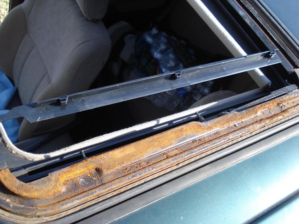

The rust on the frame has been bubbling up the metal, causing the adhesive to release from the window -

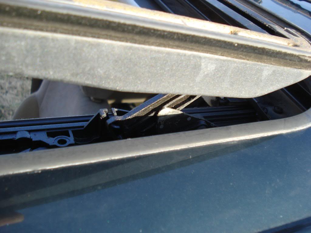

The slides are oriented in such way -

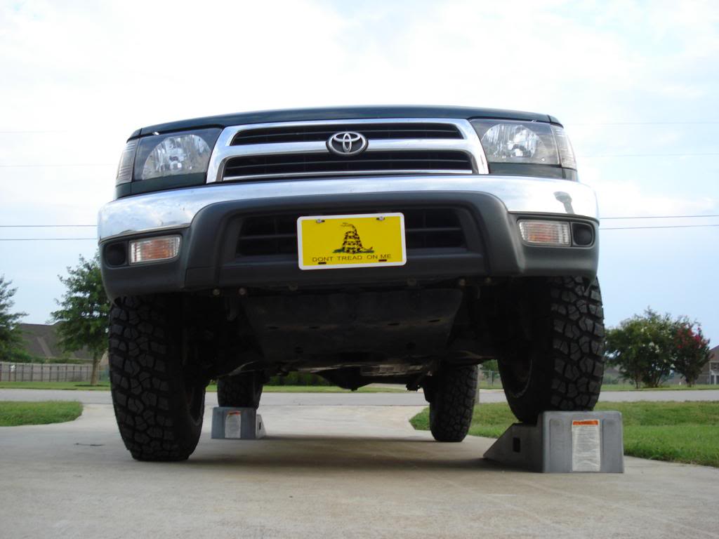

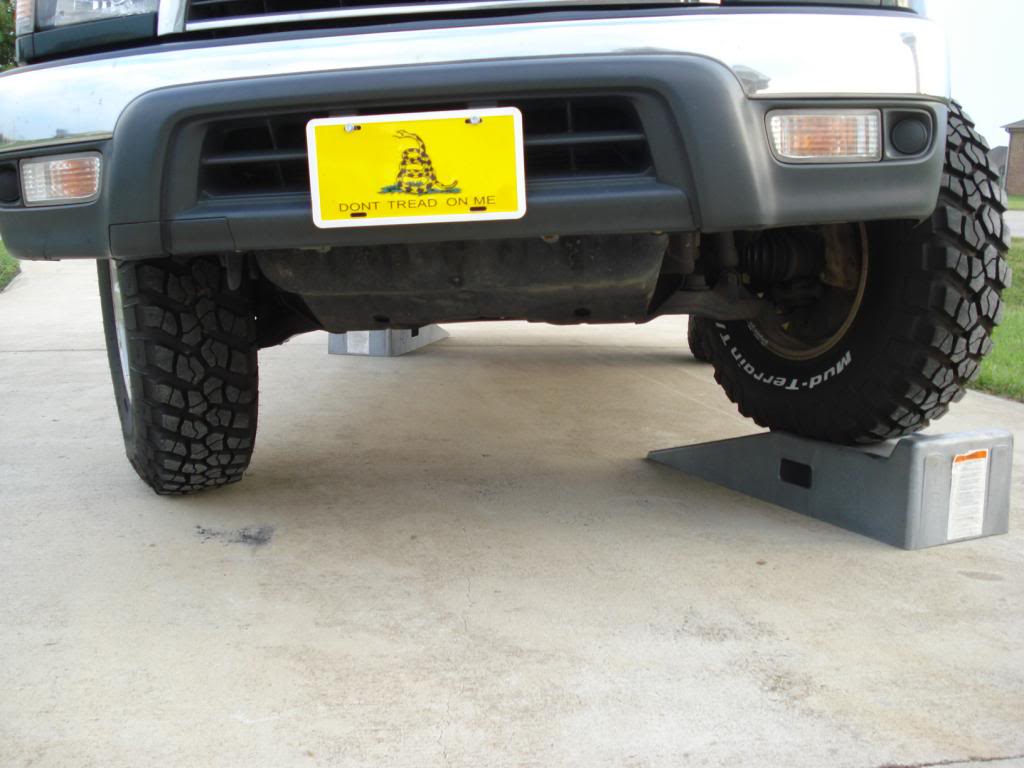

IFS Flex
