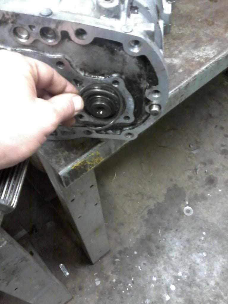

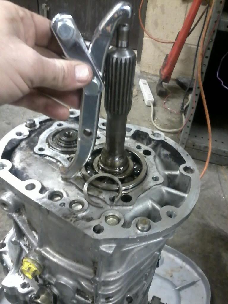

I finally got the snap ring off. That was a royal pain in the rear, but it is off. None of the snap ring pliers I had worked so I had to make due with what I had and used them and a couple of flat blade screw drivers to get the snap ring off.
Got that done and have tried several different gear pullers from my local parts store and I am having trouble finding one with a deep enough reach and hook to grab the edge of the bearing and pull it out. At this it would probably be cheap enough to take it to a tranny shop and have them to just pull it and install the new one. Shouldn't take much time, but I am not giving up in it just yet and going that route. I like to do things myself, but it would be a good way to go if you have the tranny out and the shaft is loose like I see on these a lot of the time.
Trying to find the right gear puller. I will send the original poster of the thread I found this thread on and see if he has any suggestions.

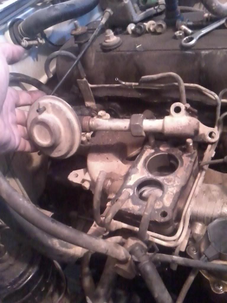

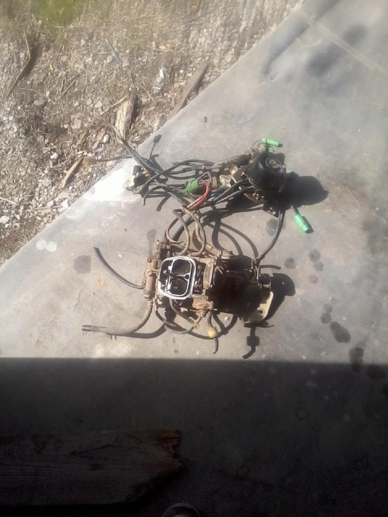

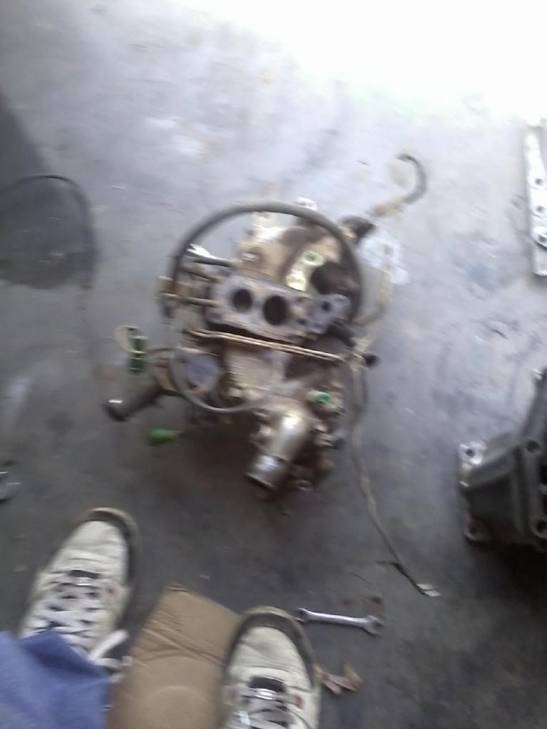

Tuesday and Wednesday morning I will be working on the 22r to 22re conversion. I removed some more of the wiring that someone had for an alarm system on the 86 extra cab. Got the fuel pump removed and the carburator. Toyota carbs have plenty of vacuum lines as it is, and this is a California Emissions truck which has even more.

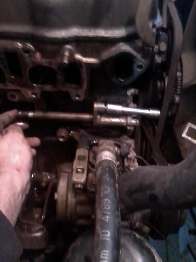

Remove 2 bolts holding on Fuel Pump.
Here is the Carburator off. I tried to leave as many hoses hooked up so the next guy wont have to figure out what will need to be hooked up. A Webber is just a better carburator all the way around on a 22r truck. Dear Toyota.. Could you possibly added any more lines and made this carburator and intake any more complicated? It isnt quite that bad but it is a slow process to remove. I tried to remove the carburator still mounted on the intake and was unable to get to all of the intake bolts.

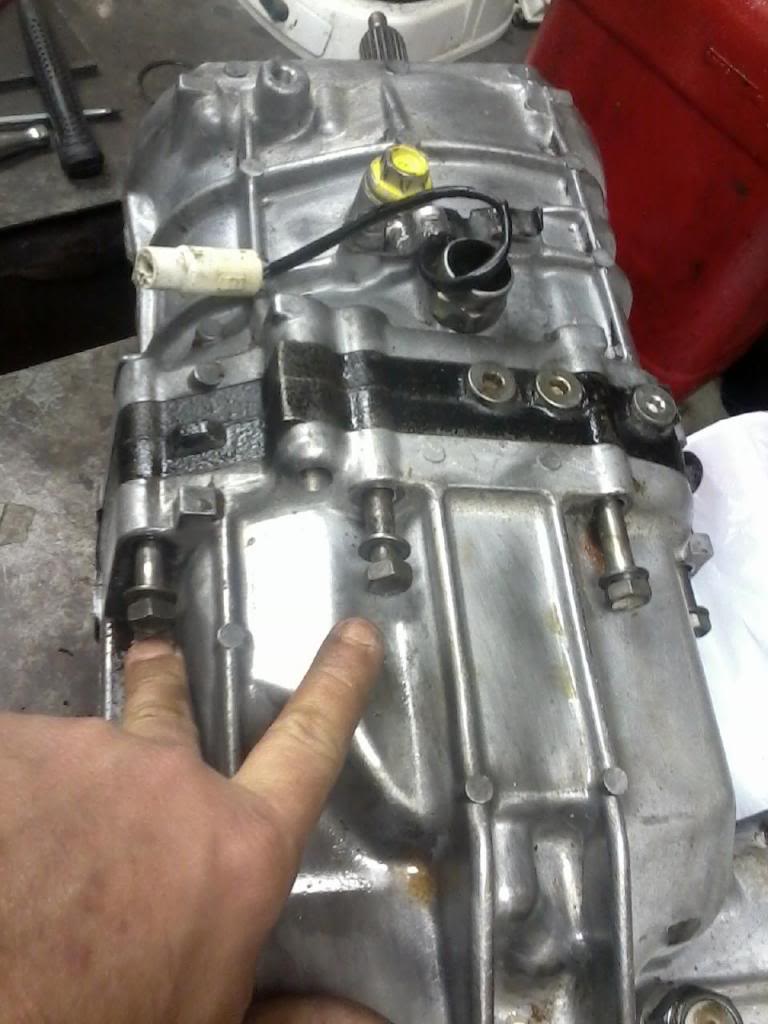

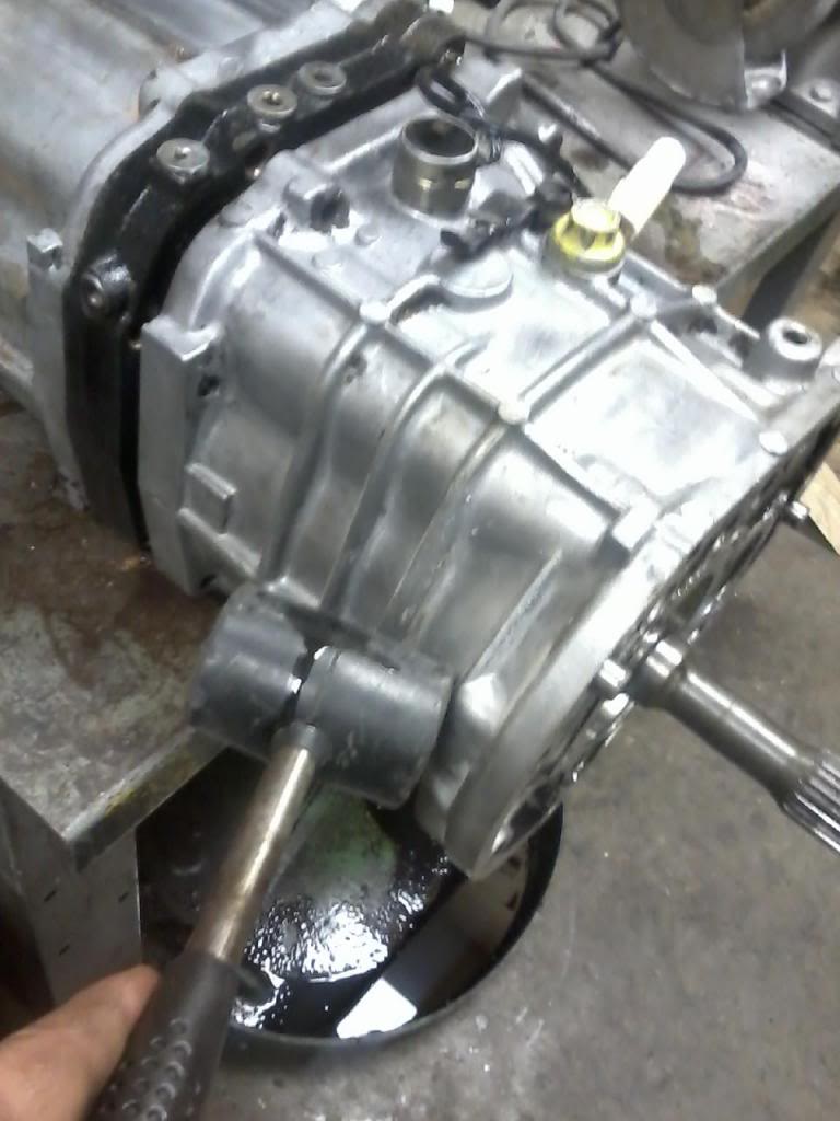

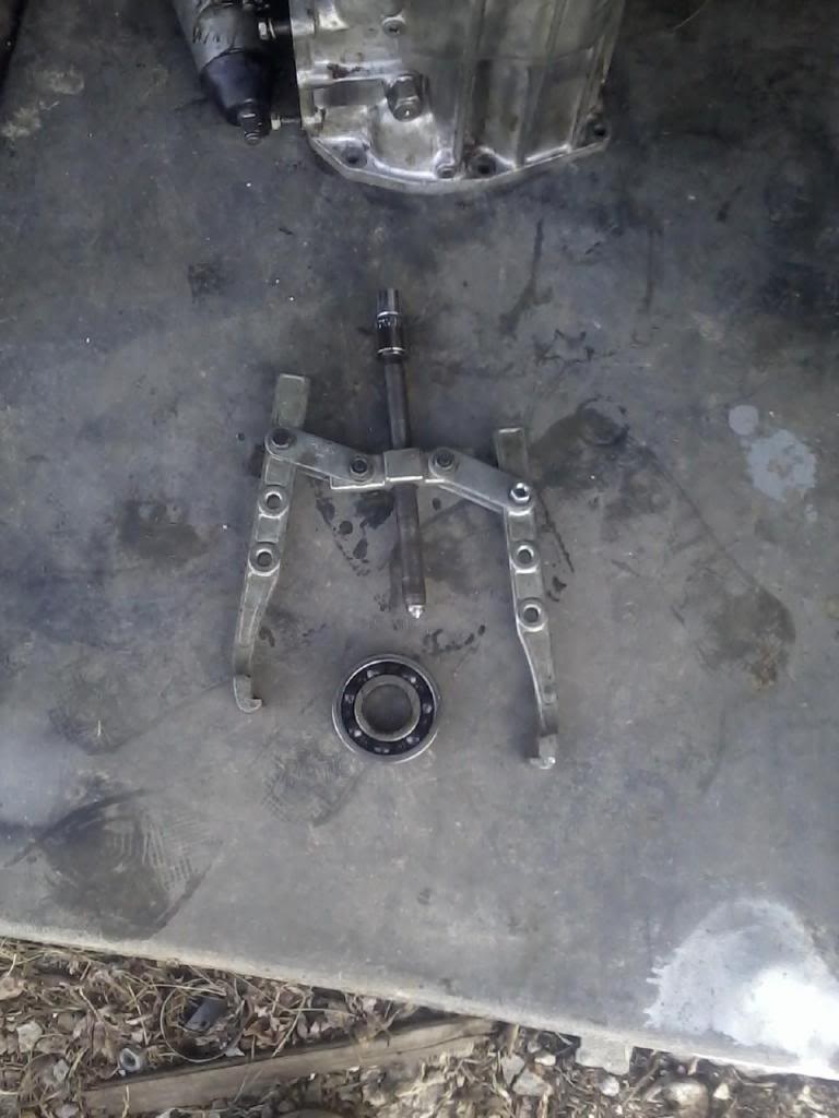

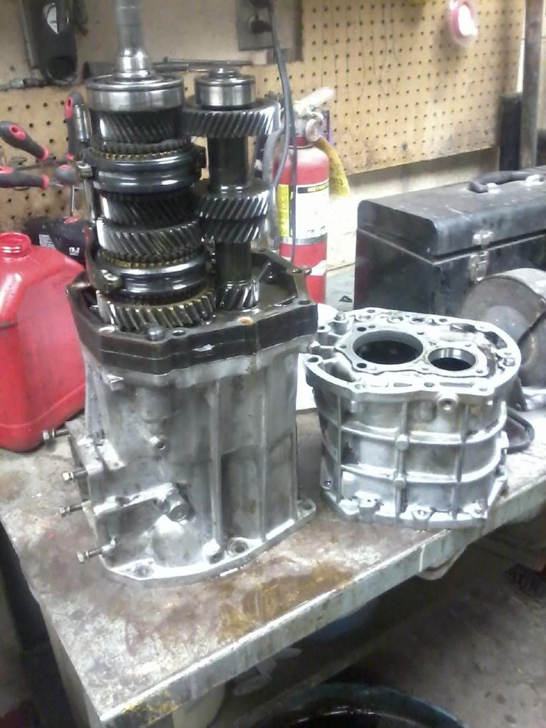

Back on to the Transmission Main Bearing. Up to this point, this job can easily be done and when I get it finished, I will put the pictures in better order instead of going from one project to another. So far this is an easy job.
You will need to remove the other c-clip that is attached to the smaller shaft.
Then remove the nine 14mm bolts that holds the case together.
Then Thump it with a rubber hammer as per the Factory Service Manual.
I stood the transmission on its end and it easily lifted off and separated. Really nothing to be concerned with up until now. I have talked to my machine shop that does my engine work and he say he has a press that could press a bearing on. He does not have the ability to pull the bearing.
For that from what I am learning is that you can use a Bearing Separator and a Gear Puller or a Press to pull the bearing off. That is my next learning experience as I have never used a bearing separator and right now don't have access to a press. I hear Harbor Freight has a bearing separator so will check into that.

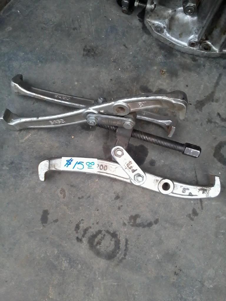

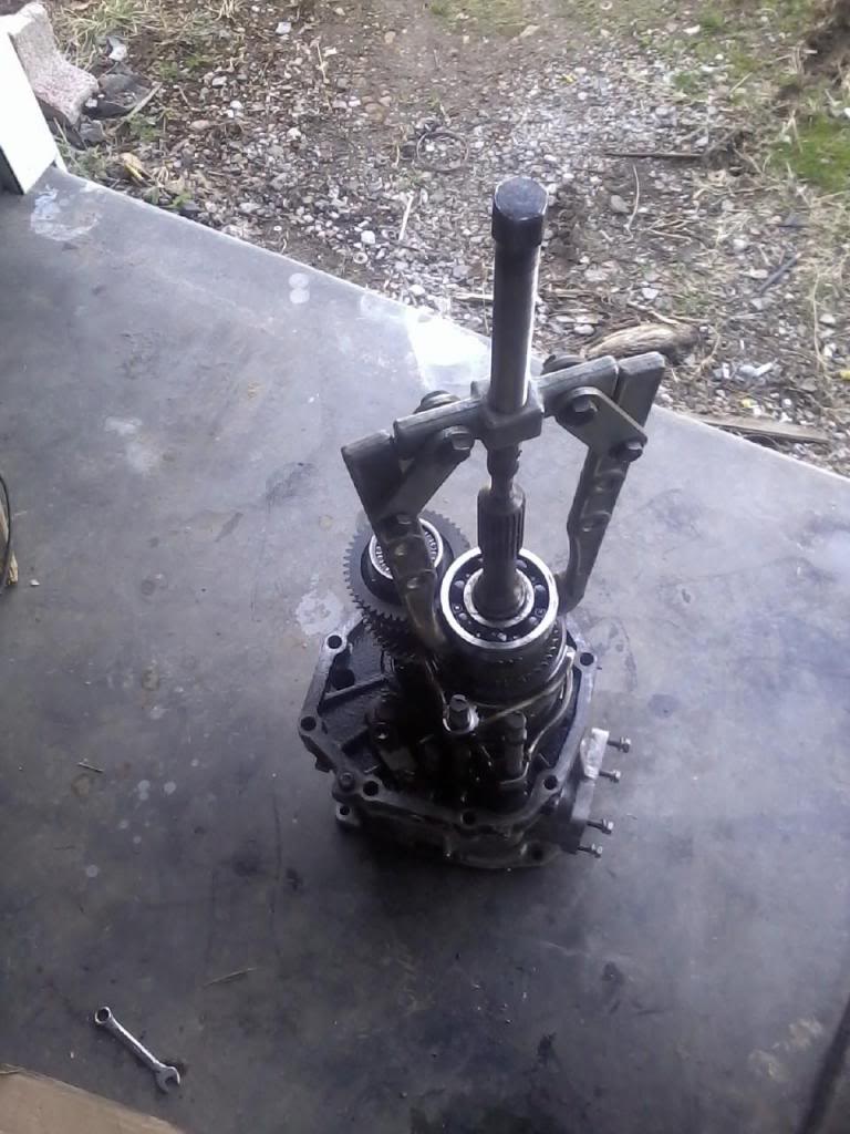

I found a tool rental place and for $10 a day rental. Later I went to a pawn shop and found a 3 prong tool for $15. I suggest using a 3 prong puller, but it worked!! Now I just need to see if my machine shop can press it on for me. Imp[act Wrench made the job so much easier as well. Thanks for the tip Jason, I was just going to wrench it the whole way. It didnt just pop right off like I thought it would.
Success, Wahoo!!
Success, Wahoo!!

Terry, I never thought of a tool rental place or a pawn shop, both of those are great ideas. Good job getting that bearing off.

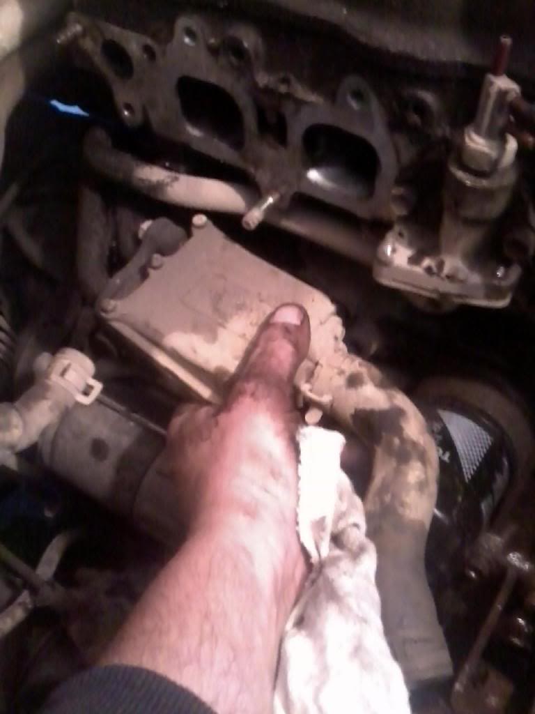

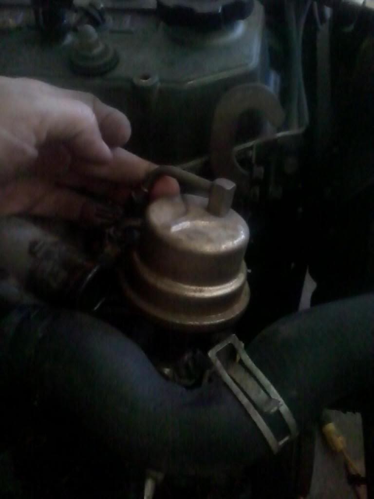

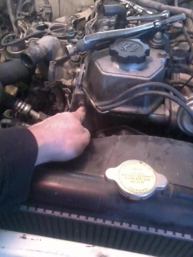

Back to the 22r to 22re Conversion.
Remove the EGR, 2 bolts and 1 nut. The EGRs are different between a 22r and a 22re.
I remove the vacuum lines to the metal pipes. Remove the 10mm bolt. This helps keep the Modulator on the Distributor clean. The Modulator can fail and you just as well to replace the whole Distributor as just the Modulator. (Not Cheap)
Remove Intake Manifold. This can be troublesome with the vacuum lines attached to it.

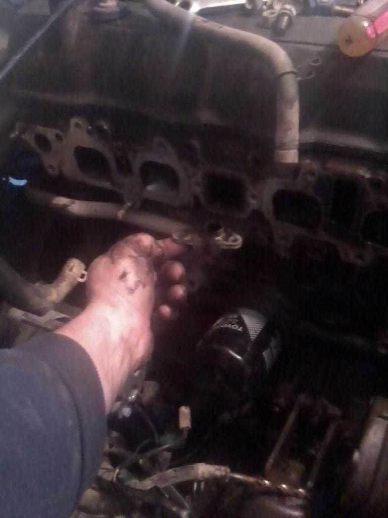

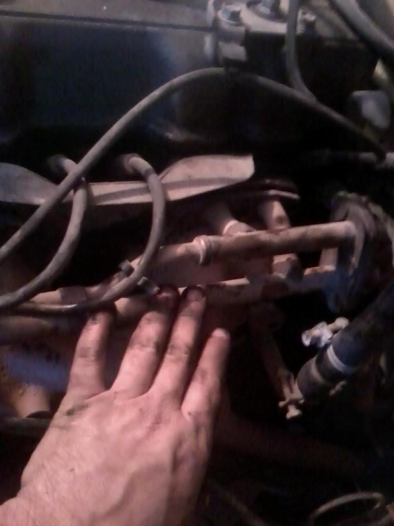

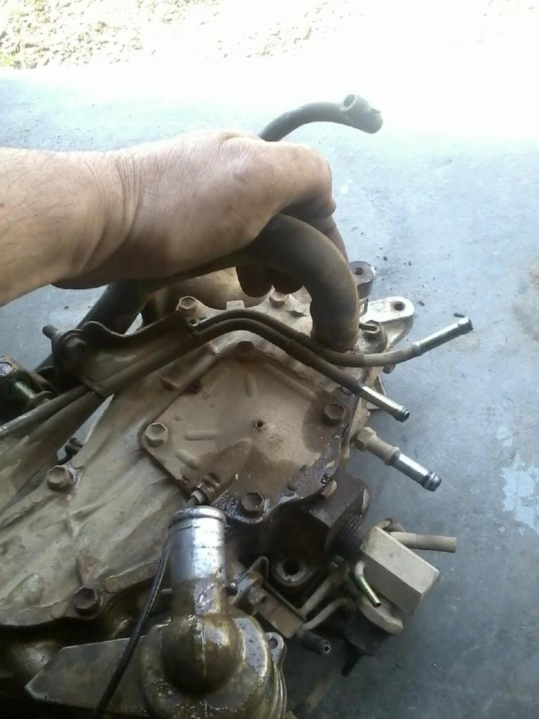

This metal pipe is different from a 22re. It has to be removed as well.
You can use this pipe, but remove the 2 bolts holding the vacuum ports assembly. This is a 22r only part. The lower water pipe can be used for the conversion. (The vacuum port is in the next picture below that has been removed.)
2 bolts hold this to the block and remove the 2 nuts attached to the pipe to make removing this assembly a whole lot easier. Remove the bolt on the top of the exhaust manifold only to get the pipes out.
Remove 3 nuts that is connected to the exhaust gas/ egr set up to get the pipes out.

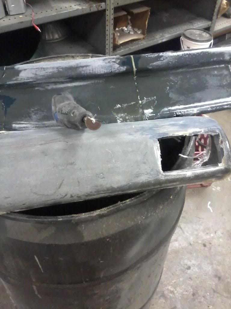

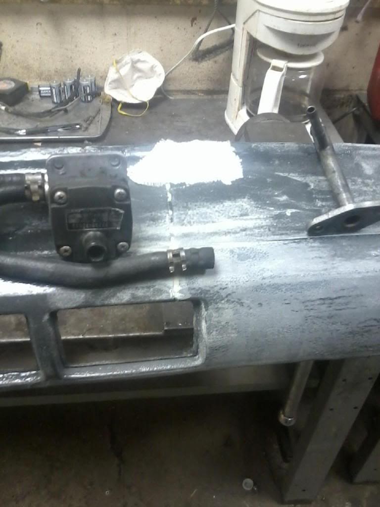

The machine shop I was going to take the transmission to is going to be closed for the next day or so and it will be next week before I can get back over that way so I worked on some other things.

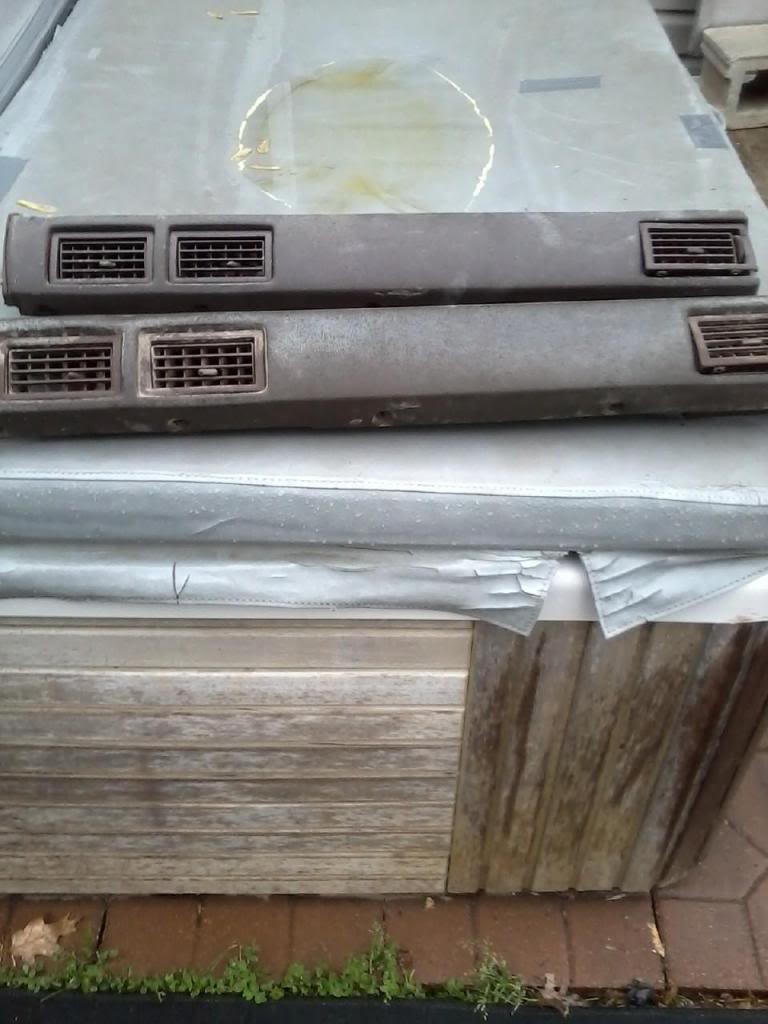

One is getting the IACV cleaned and tested. I put it in the freezer and I could see the valve opening. Then I started to work on one of the broken dashes that I have. Just putting a patch over the big broken area on it.
Luckily I do have a spare dash pad that I will be putting into my 86 runner at a later time. Might get around to it next week.
It was fun working with the Dremel until I broke it. grrr..

Hello junk4u... Some parts of the dash are coming out great and some are going to take some more work to get it to where I would like. It is going to lose the texture, but with some time and effort, I think it will be far better then having a big crack down the center. Mark was telling me that PepBoys has a carbon fiber like material that might be worth a try as well.

Was supposed to take Mistys Runner to a friends shop and swap out the clutch. We both have a few things to come up so that is on hold til Saturday.
I did go back and get that 3 prong puller I seen at the pawn shop. Should of checked there before. Had I stopped there first, they probably wouldnt have it. I checked it on the tranny and it has the reach to pull a bearing. I need one anyways so it was a good score for me. Checked parts stores and online and they are not cheap at all.
