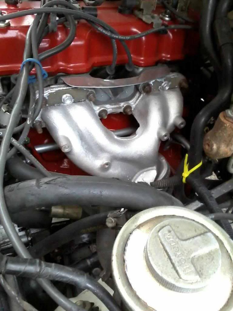

I have posted this on my 88s thread, but wanted to post here as well for some that may have missed. I spent some time on Mistys truck just checking it out and her window was getting hard to roll up again. I sprayed the tracks down with silicone and smooth and easy to work again.
I painted her exhaust manifold with the high temp exhaust/engine paint, (cant rember name). Directions says to paint and heat in oven or something like that. I didnt have an oven or what they suggested, so I just would start the motor a few times and let it cool down. It is still holding up. That was nice to see. I still need to get the plug wires looking better though.

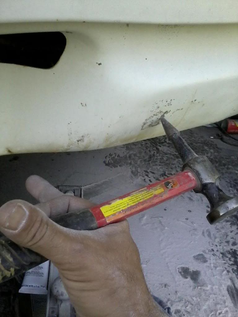

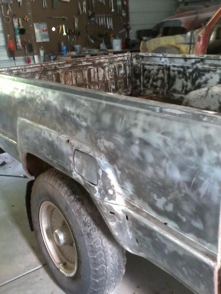

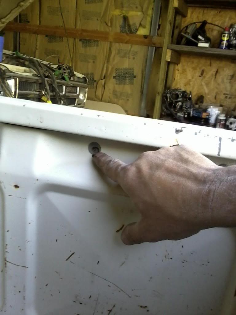

What I am trying to show here is that I have a high spot form something denting it from the inside to the outside. I have the pecking hammer balanced in my hand. With just enough force from my finger, about what is needed to pull the trigger on a pistol or rifle, I am able to tap the high spot back down. It doesnt take brute force. With about 15 light taps in a one square inch area, brought the high spot down.
Backside showing where hole is. I will use rust killer on it and remove the rest of the rust along the bedside as well.

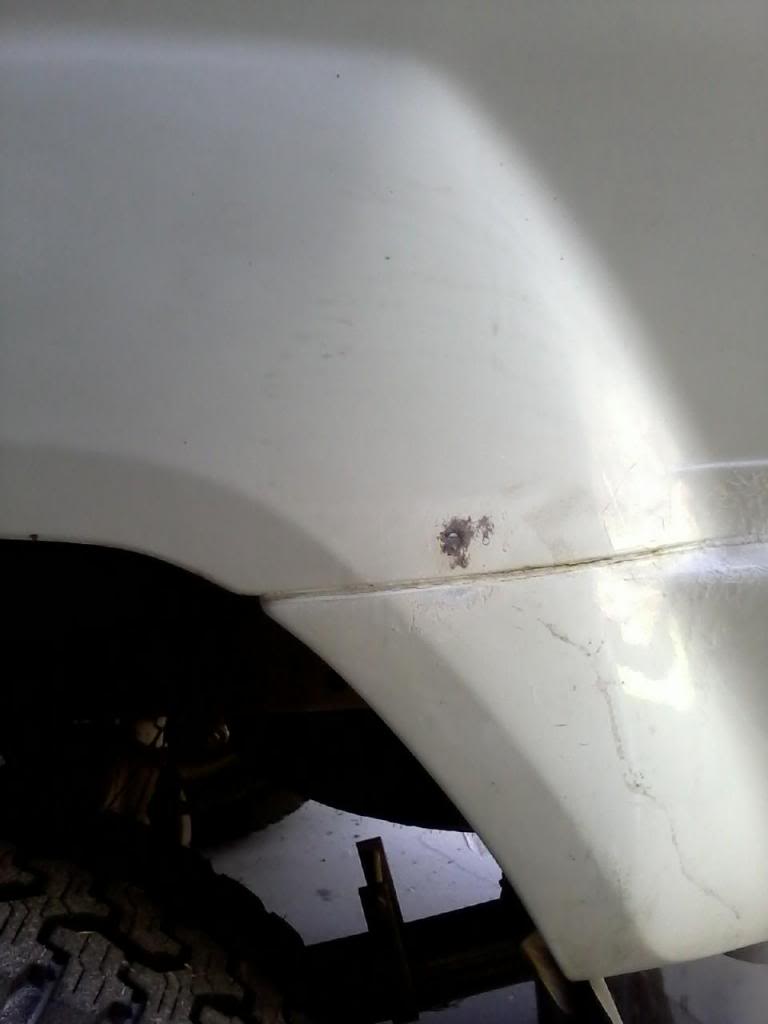

Here is a rust hole on the drivers rear fender. It started as a blister, but a quick bump with the sander showed the hole. I will take some rust killer and use a little fiberglass patch from the back side to fix it and then coat it with some body filler on the outside.

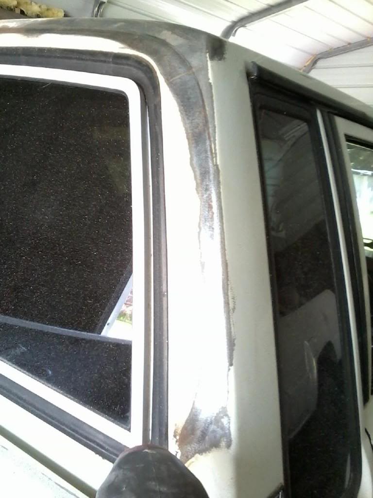

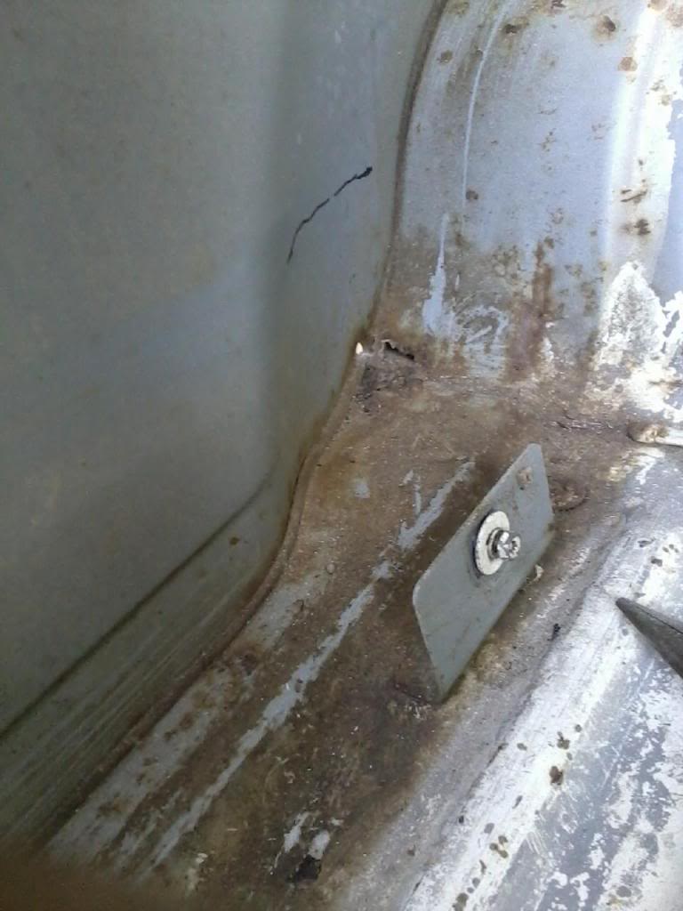

To prevent this from happening and what has ruined alot of these truck beds is the inner panel of the truck bed. Where I am pointing, remove the bolts that hold the panel off. There are several large cracks that debri can get into from around the panel and it just collets mud and debri and starts eating the panel up. Most of these bolts will break on you. I am going to come up with a quick release to remove these panels eventually.
With the panel removed, on drivers side, I was able to get all of these bolts out. Where the black line is, is where I have seen mud stacked that deep or more. This sis why you see so many of these beds rusted along the body line.

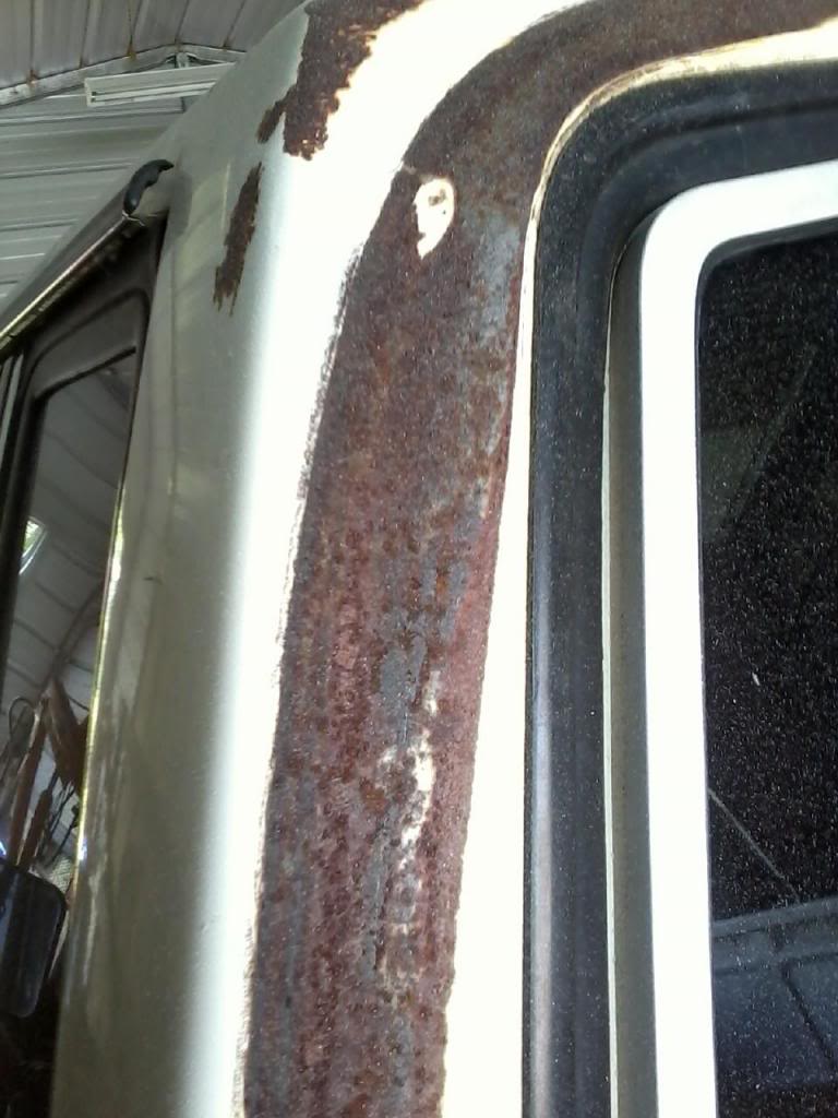

Not all rust is bad. Here is the drivers side where a camper sat and rubbed the paint.
Here I used 40 grit sandpaper on the passenger side and got all of the rust off.

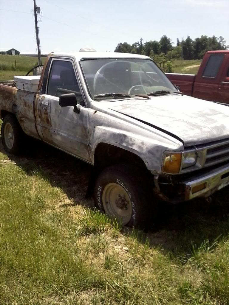

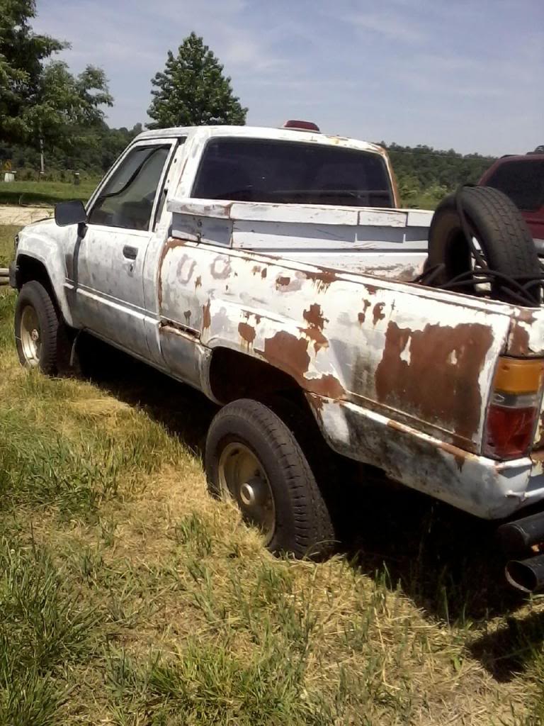

Here is one I have done in the past. It looks bad but cleaned up nice. Except for the rust along the body line. Just had to knock the ugly off of it.
Copied
Here it is at the preious owner getting bought.
One hour after getting it home.
Except for the rust holes, it did turn out well.

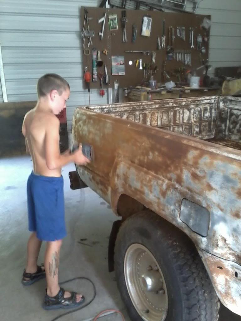

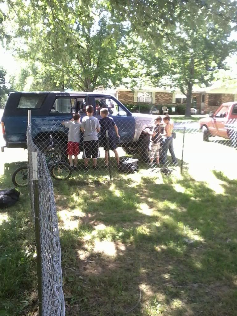

This all started with just one kid wanting to help. Then the others wanted to jump in. I had a total of 5 neighbor kids plus my two at one time. I am sure some of the parents appreciated the filler dust they had on them when they went home.hehehe

That's pretty cool that those kids have the ambition to help.
Reminds me when i was young, I was happy just handing my dad wrenches LOL!

Nice to see Terry's helpers!
