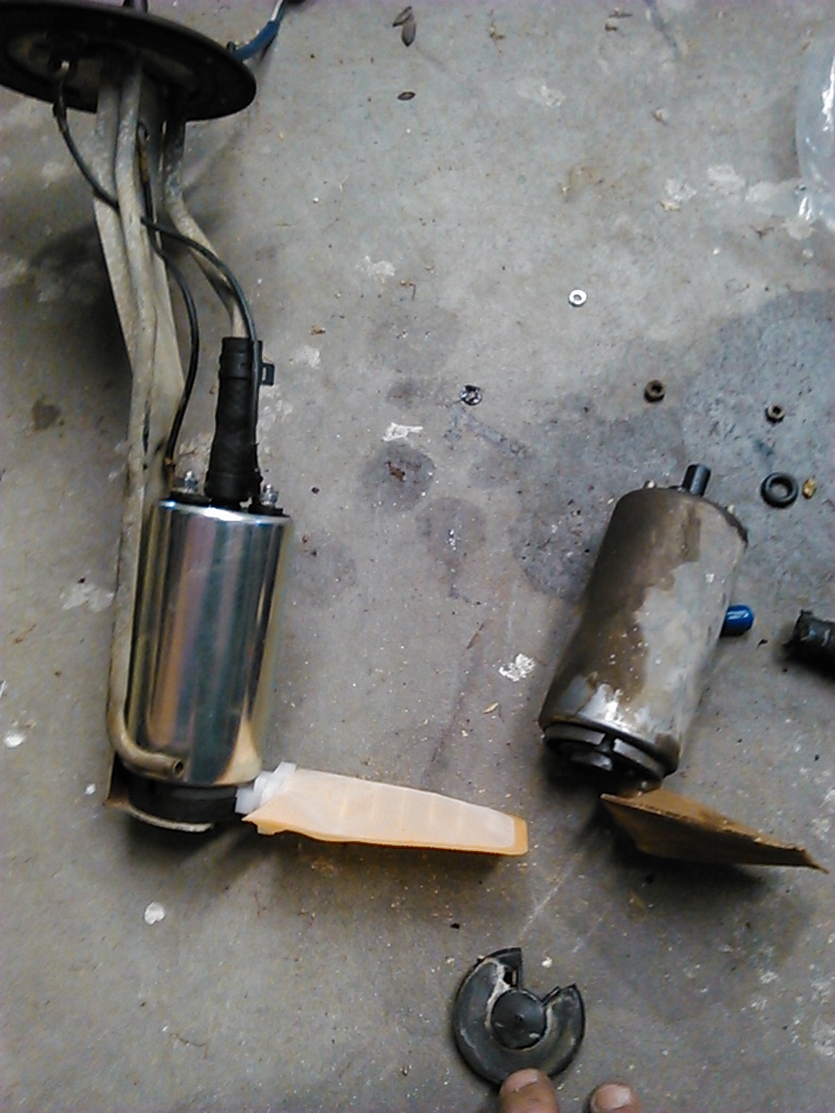

Been tied up at the hospital and got some time to work on the 86. What I have gotten accomplished so far.
I installed a new fuel pump and that did not fix the 86 truck problem. I am now going to replace the Fuel Pressure Regulator but dont have high hopes of that fixing it. It might and it would be nice if it did. I will replace the regulator and see what that does. If that doesnt fix it, i am also going to post another TPS thread on the main page and see what I get for some information on it. There are a thousand threads on it, but I have gone thru everything I know of and maybe I will get a response on it that might get me to the right area.
Here is the new pump I got. Some do not come with the rubber spacer on the bottom of the pump. This is something you want to make sure to get as I have seen some be really mushy. Also make sure that when you order a pump it comes with the filter on the end of it as well. Those usually need to be replaced as well.
