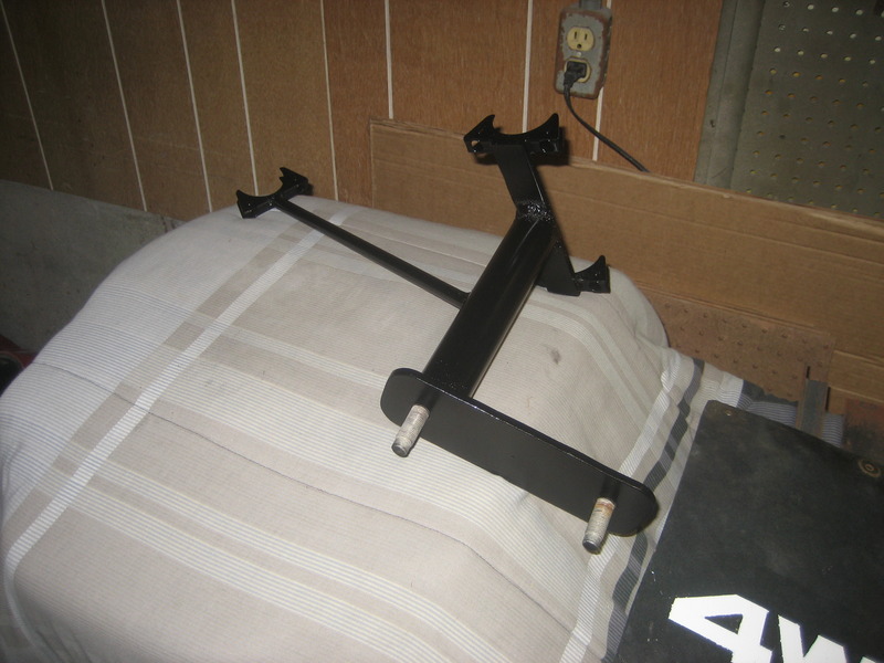

Built this funky thing yesterday. Want to guess what it is?

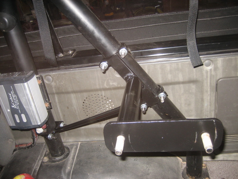

Hint: Here it is mounted in place.

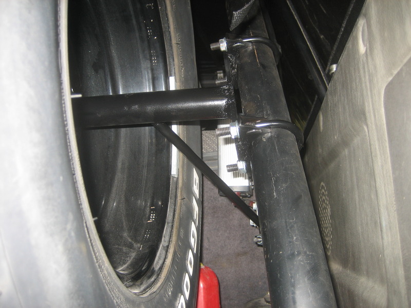

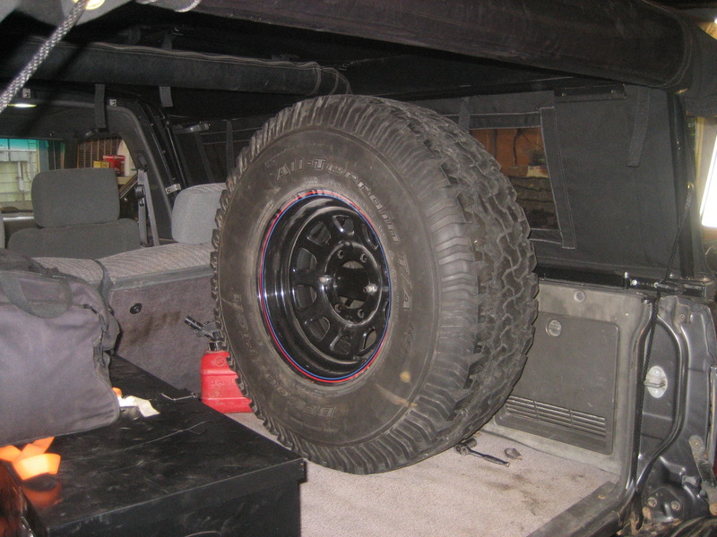

If you guessed spare tire carrier you were right. Someday I'd like to build a swingout that mounts to the bumper but I needed something to work until then. The 33 didn't fit in the stock location between the LSPV rod and the factory receiver. It may fit now with the TG bumper but I don't like how low the spare hangs down.
Clamps in 3 places to the roll bar. 1 7/8 exhaust clamps fit perfect on the roll bar.

For less than $50 you can make your own. I bought 3 exhaust clamps and two lug nuts for less than $5. I had a couple studs, some 1/4 plate, and various tubing laying around so that reduces most of the cost. Would be hard for me to mass produce since everything was just eyeballed. The only thing I measured was the center to center for the lug studs.

Thats cool. Does it wobble at all, or it it pretty solid?

I drove with it for the first time today. It vibrates/wobbles just a bit so I'm going to add an additional gusset tomorrow. If you look at the first picture the big tube goes to the tire mounting plate right behind one of the lug studs. I'd like to add a small tube from close to the other lug stud back to the big tube. Should take care of it, I think.
