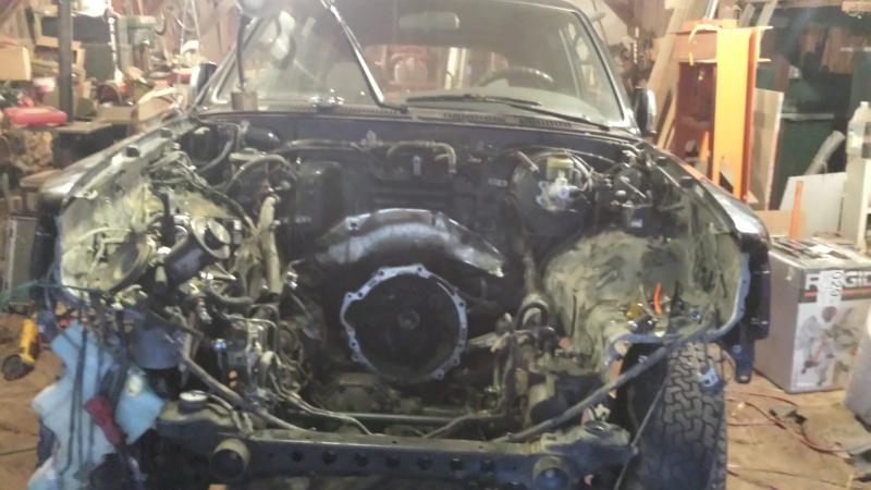

3.0 had a couple of cylinders with low compression so backed her in the barn and adios 3 slo

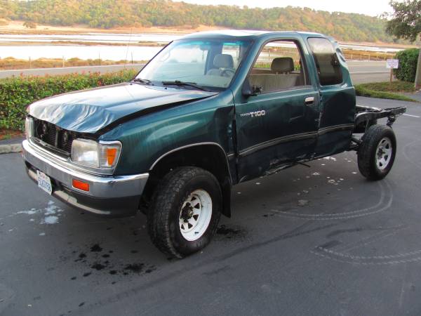

Picked up a 3.4 out of a salvaged '00 4runner. Hunted around for a manual trans ecu and engine harness but decided to grab this '98 T100 for cheap as a complete donor vehicle.

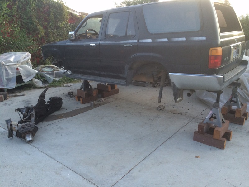

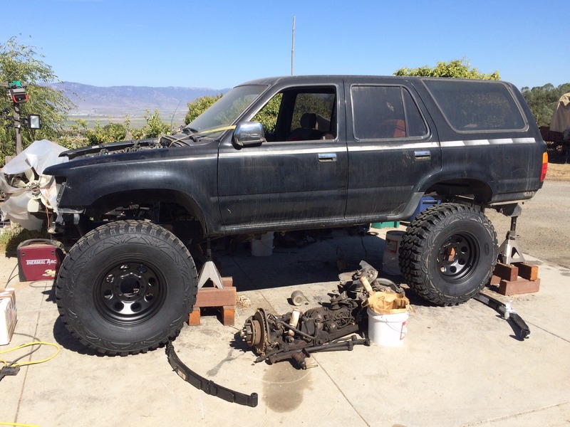

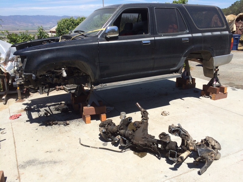

So out came the rear Toyota axle
Then the front IFS

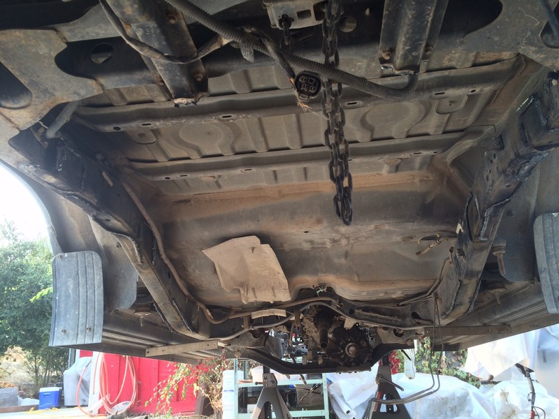

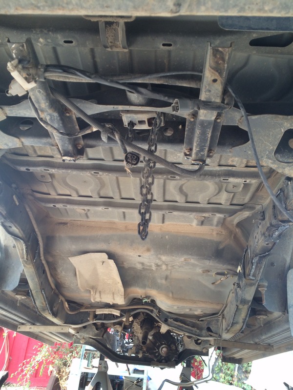

Fuel tank removed and cross members cut out

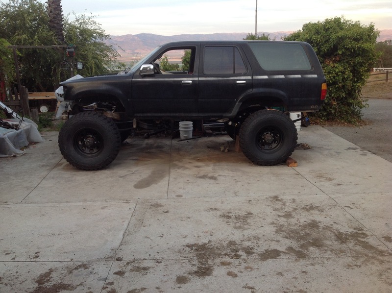

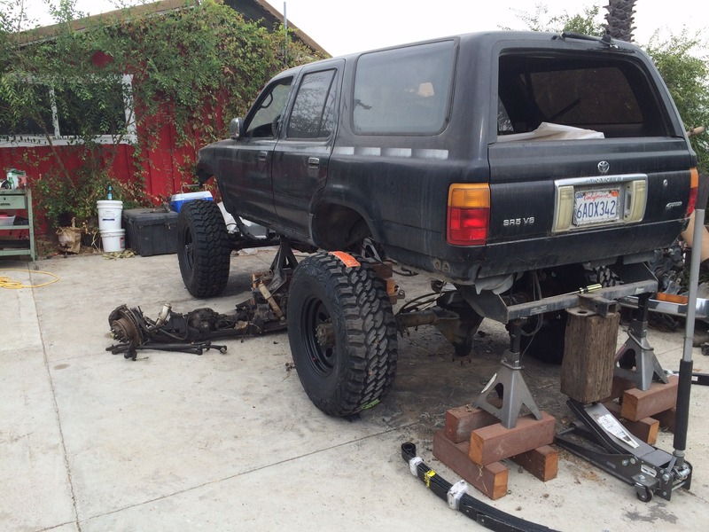

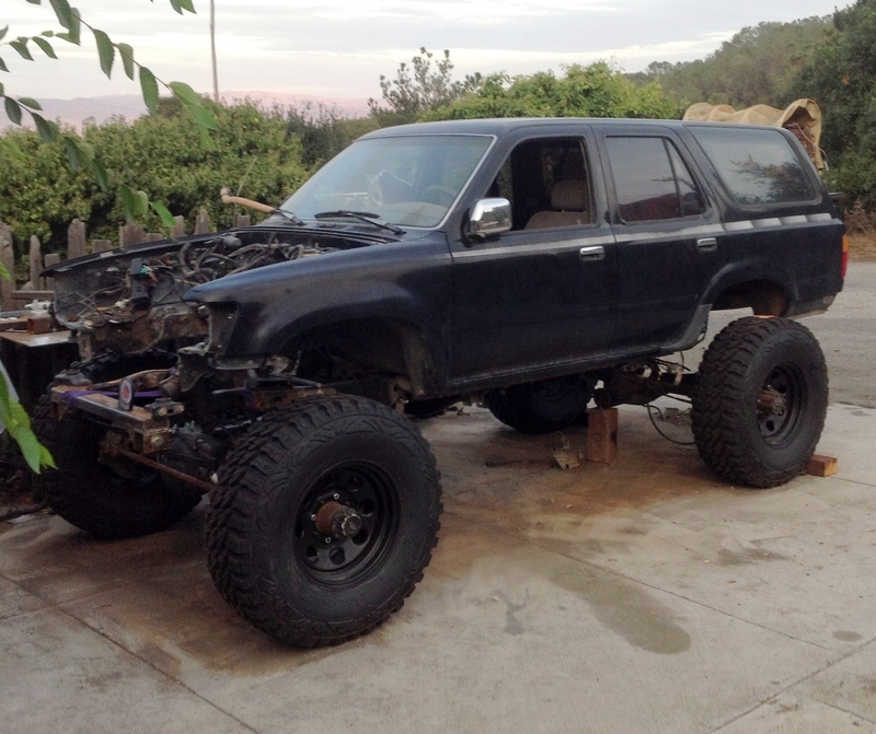

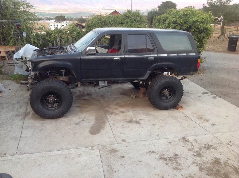

Mocked up

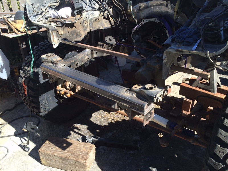

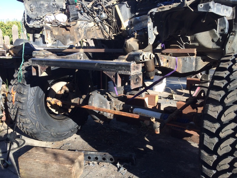

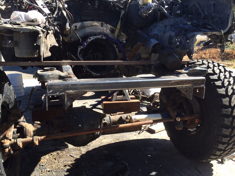

Mounted to wheels and rolled the 60 under to see how things were going to line out. Decided to move my front axle forward so I made my front hanger out of 2'x4"x1/4" and frenched it in to keep things low as I can.

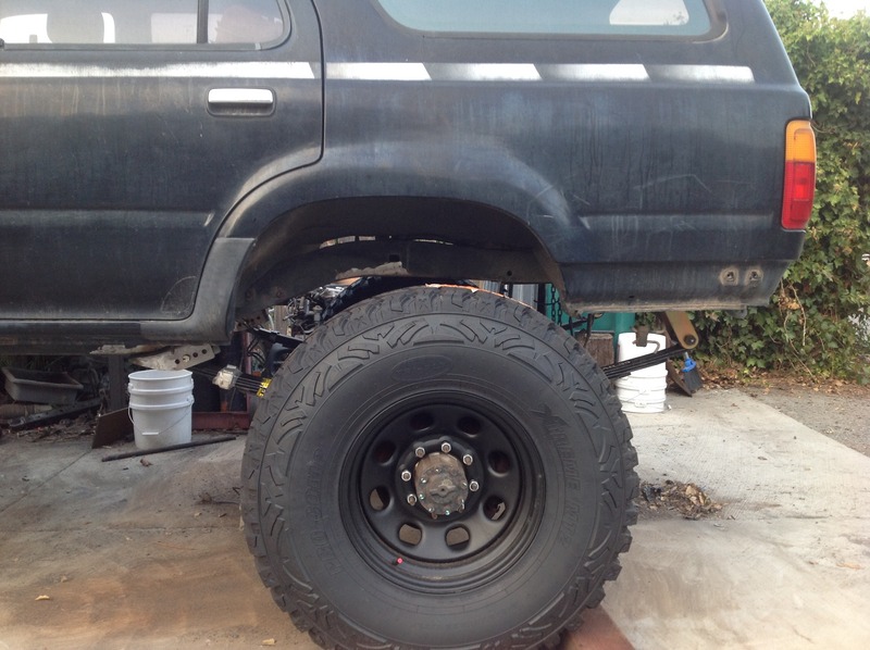

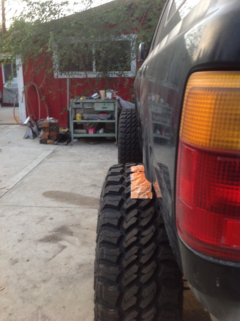

Time to start on getting the rear lined out.
Rear is going to end up moving back about 2-3", i think.
Still need to get some shims for the front end to keep my caster 0-3 degrees. From what Ive read this is whats recommended on Dana 60's.
Then steering, move the steering box forward, brakes, fuel tank and reinforce frame with 2x4 box tubing where I cut out all the cross members in the rear.

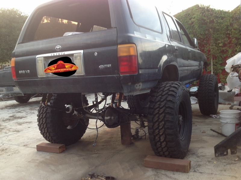

Today I got the rear leafs hung and hopefully will get the rear axle buttoned up within the next few days.
Then the front IFS

Mocked up
