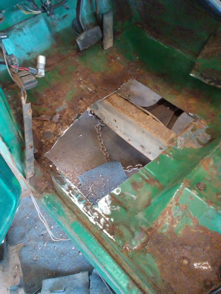

Here I cut the rear part of the floor pan off. I am under cutting so as not to cut too much off. I am slowly trying to get it to fit.

Afternoon Terry. On big replacement panels that could possibly be cut too small because of curves and such, you could leave it an inch bigger all the way around if it will sit flush and drill a pattern with a half inch drill bit on the extra inch that's laid over the original floor and plug weld the holes that you drilled. Then seam seal the edges. It's just an thought. And it's easier to do on heavy parts that aren't on a table.

Hello Tony... What has taken me several hours probably take you a couple. I have been having to grind and cut off several of the previous owners welds. I know of the guy that did some of the work on it before and I am sure he used a stick welder. I will give your way a try. I am sure I am going to use plenty of seam sealer when I am done. I am a little anxious about how my results are going to be but it will be rust free when I get done. Anything I really screw up, I can have a local shop get started for me and I can finish it if I get in way over my head. So far I am actually learning a few things,

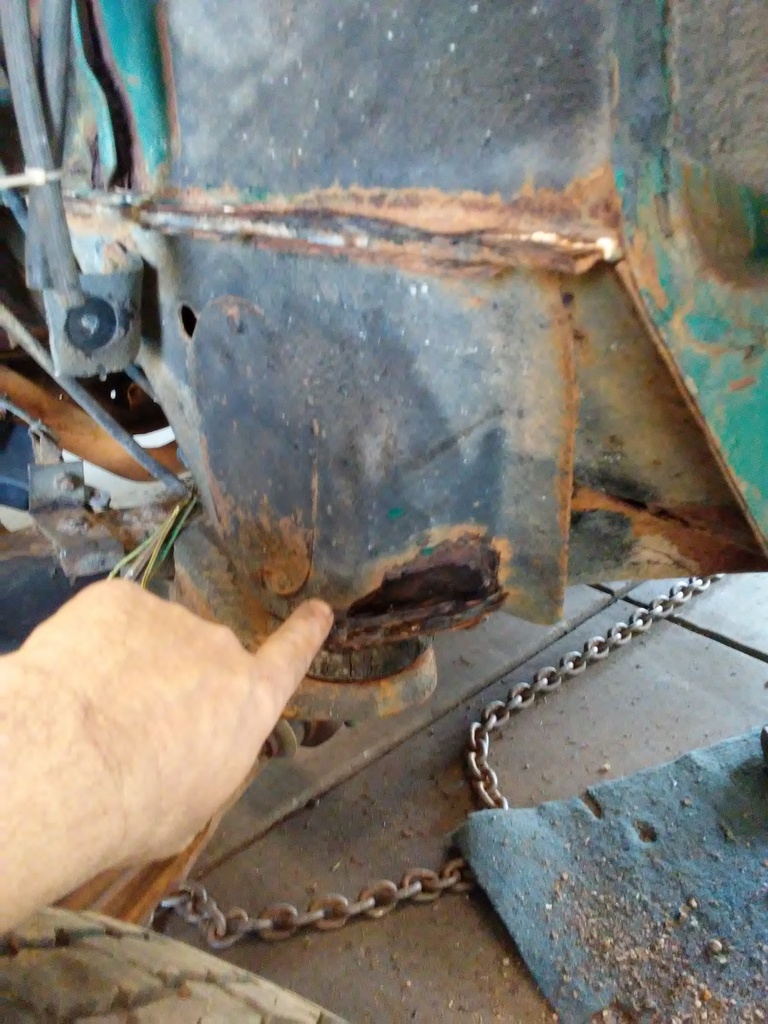

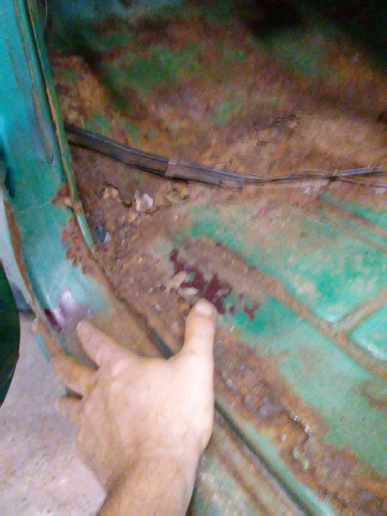

This is where the floor pan meets the cab mount. A ton of rust dust under it from a bad cab mount that I will need to replace at a later time. I am going to get the floor done first and then get the cab mounts when I come up with a way to get the cab off.
Some of the rust cut out. There is more that I dont have showing. I am having to grind a lot of welds off of the door seal from the previous owner.

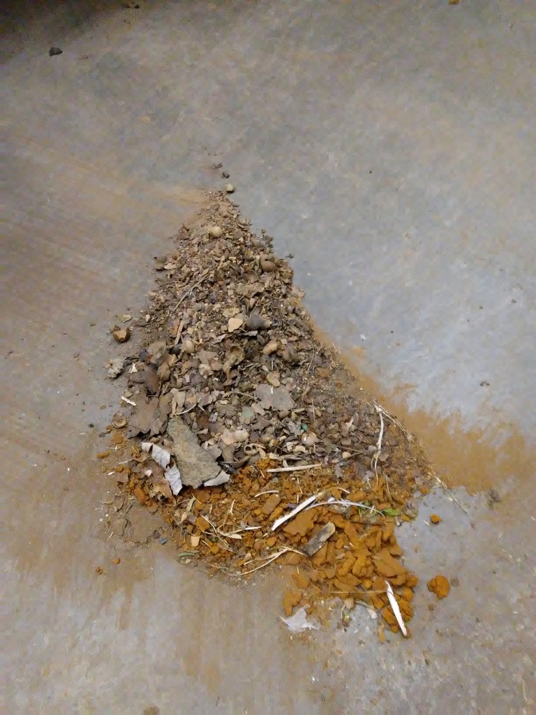

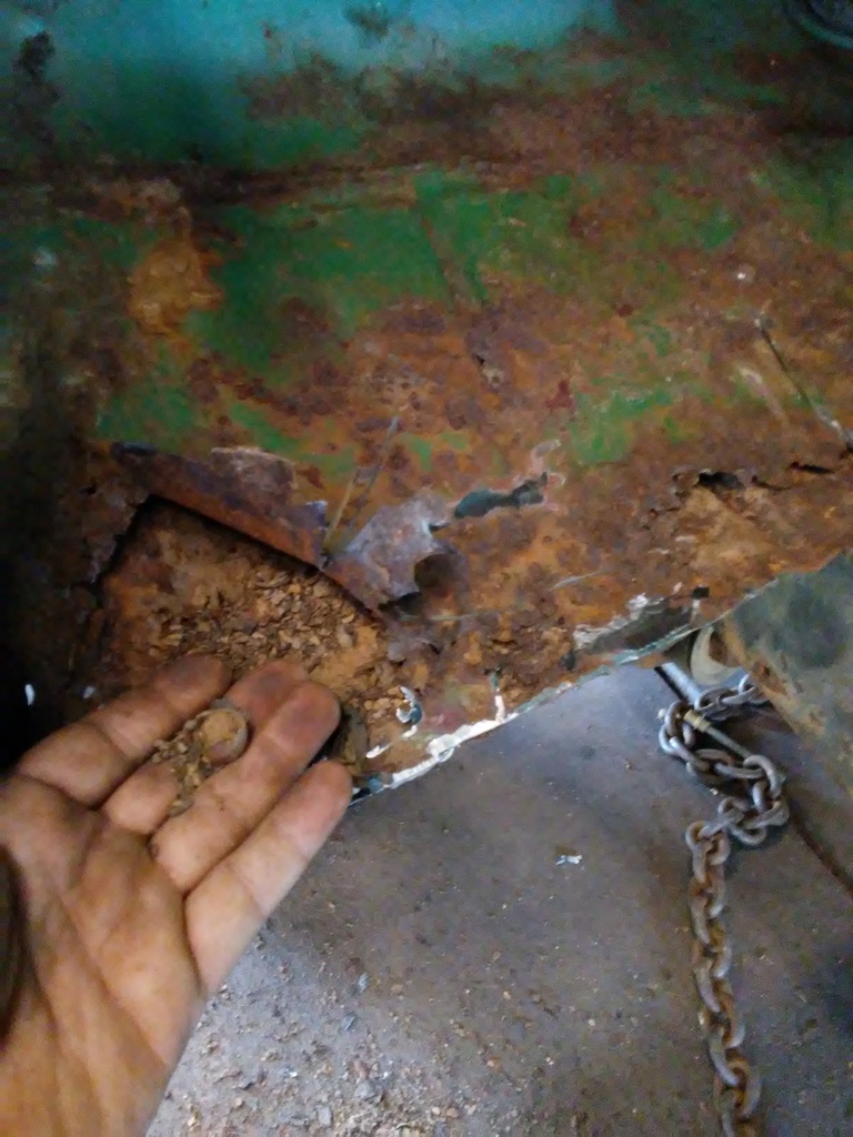

Some of the rust and acorns from a squirrel coming inside the cab from here. Here is one of the cab mounts that will need replaced.

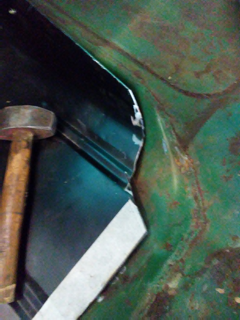

This corner is deeper on the replacement panel compared to the rest of the cab. Replacement parts dont always fit 100% correctly. I am still working on this issue.

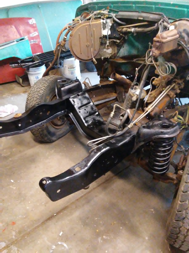

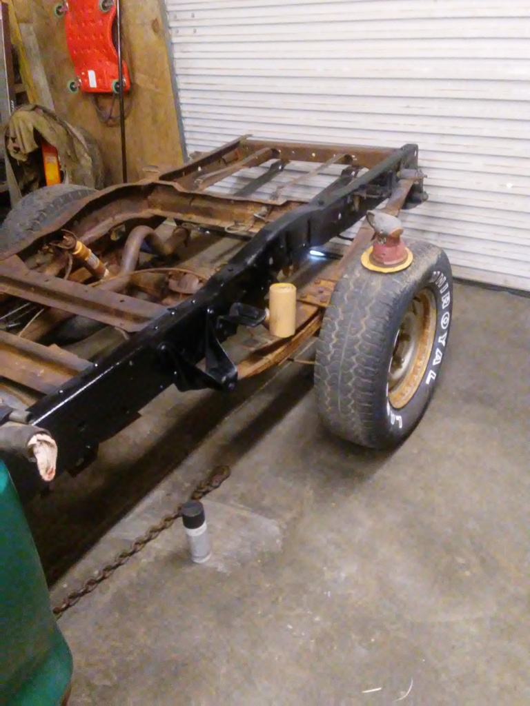

Took a break and Justin and me did some sanding, grinding, and cleaning on the frame and then used some rust converter on the rear of the frame. I am eventually going to get a sand blaster to clean some of the crevices that I cant reach.
Did the same on the front end.
#65
Terry that floor board looks 100℅ better with that rusted panel cut out. You guys are doing a really good job on that frame. Are you using naval jelly for the rust conversion? Just curious as I always like to try different things. Looking forward to your progress. Keep up the good work!

Hello Tony...I am using a Rustoleum rattle can that converts rust to primer. I can get a picture of the can later as I used two cans to get to where I am at. We have a ton of hours into cleaning the frame. We are using razor blades, putty knife, a hand drill with a small bristle brush on it, and I have a big grinder with the twisted wire brush on it. After we get it cleaned, I go over it with paint thinner to clean it for the converter/primer.
I have not heard of using Naval Jelly. I am going to look into it. The backing plates on my rear brakes have so many contours that I have not been able to get into them and other parts of the frame. Currently just doing the parts that I can access and get it to where I want it to be. There is some pitting in the frame but it does not affect structural integrity. I had thought of doing filling them in but most wont be seen so wont be doing that.
I would like to use POR-15 but we have had some things to come up with house projects and kids dental bills are hitting both of the wife and I budget to keep them caught up. POR-15 is going to have to wait. I am hoping Naval Jelly will fit the budget for getting to the areas I am having difficulty of getting to. Just the grinding and cleaning we have done to the frame and floor pan is creating a lot of debris on us and the floor. It would be nice to have something to put on and then to spray off. We have a hours into getting it to this point and still a lot to go.

Tony... The rest of the floor pan is fitting nicely. The problem I am having is in this one corner. I am not sure how to go about making this fit. Any suggestions? I still have to get all of the edges and more rust cleaned out and that is going to take some time, but I was wondering later on when I get the floor pan ready to be welded in, if may be I will need to fab up some small patch panels to fill in where the pan is not fitting?
This is the problem area. Later to day I will get out there and draw a line on where the fit is not fitting.

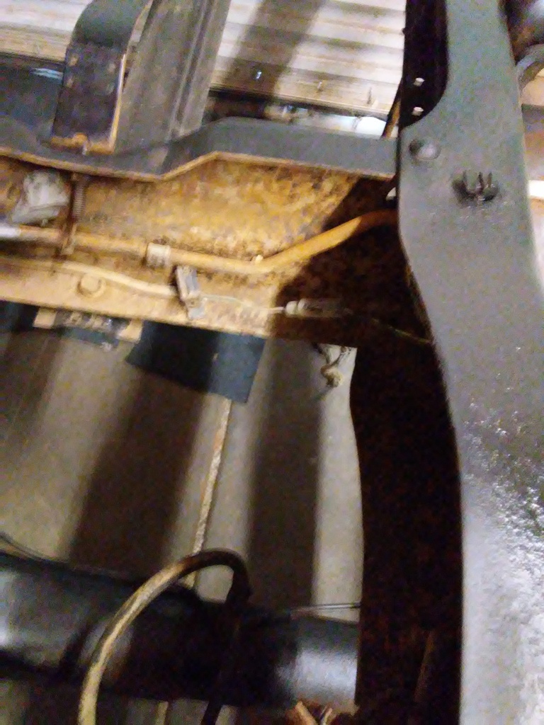

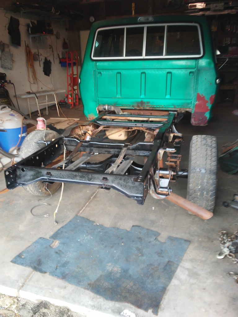

Just some of the equipment you used to clean up the frame. This is after I spent $15 at the car wash knocking off the grease and rust that I could with a water wand.

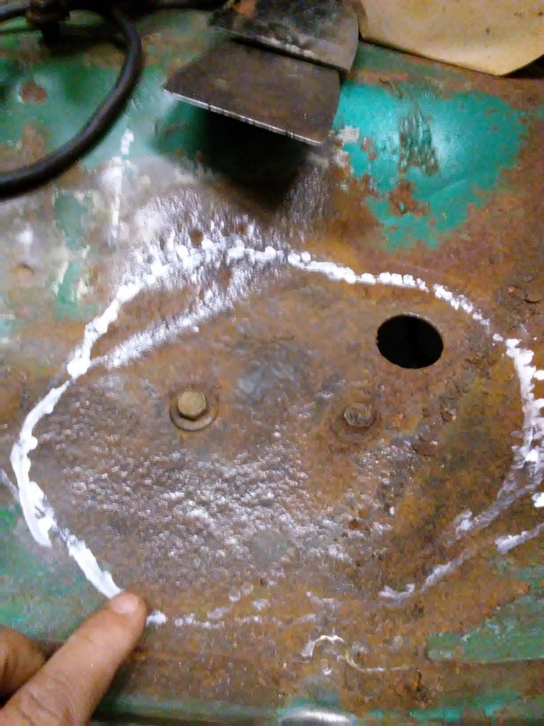

Tony... Looking from the bottom of the truck, I am not seeing rust in this area that I have circled in white. A window was left down and got a lot of rain inside the cab. I can bang on the circle with a hammer and it will not punch thru. Would it be ok to cover this in POR and not cut it out? It feels really solid. The floor will be covered with sound deadner and carpet. It does not have to look perfect but dont want the rust to come back.

#75
If it's solid I'd roll with it. Maybe take those two bolts out to make sure it's not too bad under the heads of them. It's kind of hard for me to think a couple steps ahead sometimes haha, but I try to leave the backside of welds open to treat that metal before closing it in. That will always be the first thing to rust. Even if it's just an access hole to shoot some por or epoxy in. Glad to hear that weather missed y'all. We are getting near 90 today and seems like what winter we had is long gone.

Thanks Tony... I feel if I can kill the rust it will last as it is solid. I will make sure all edges are cleaned up well. I am going to seam seal this real well and try to remove any chance of rust coming back. We have a mild winter compared to most we get. Here in tornado alley and warmer weather it does get a little interesting at times.
