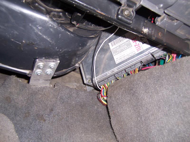

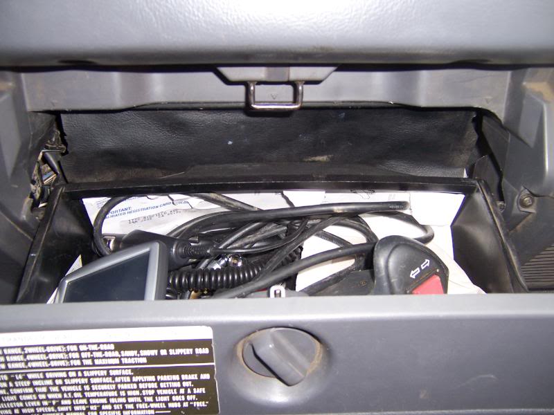

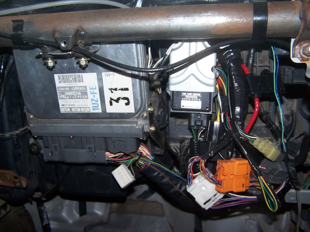

Originally Posted by SHAGGY21
hey rma where did you end up putting your ecm
I mounted mine to the heater core box. I had to cut out the back of my glove box to get it to close but it's up high and out of the way.

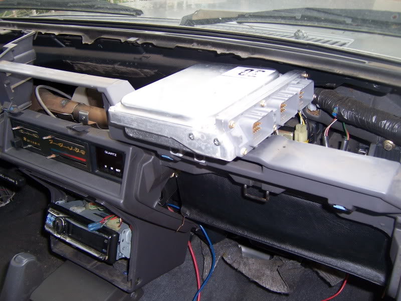

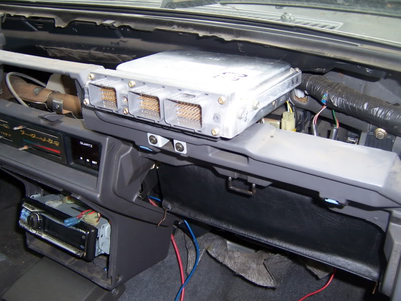

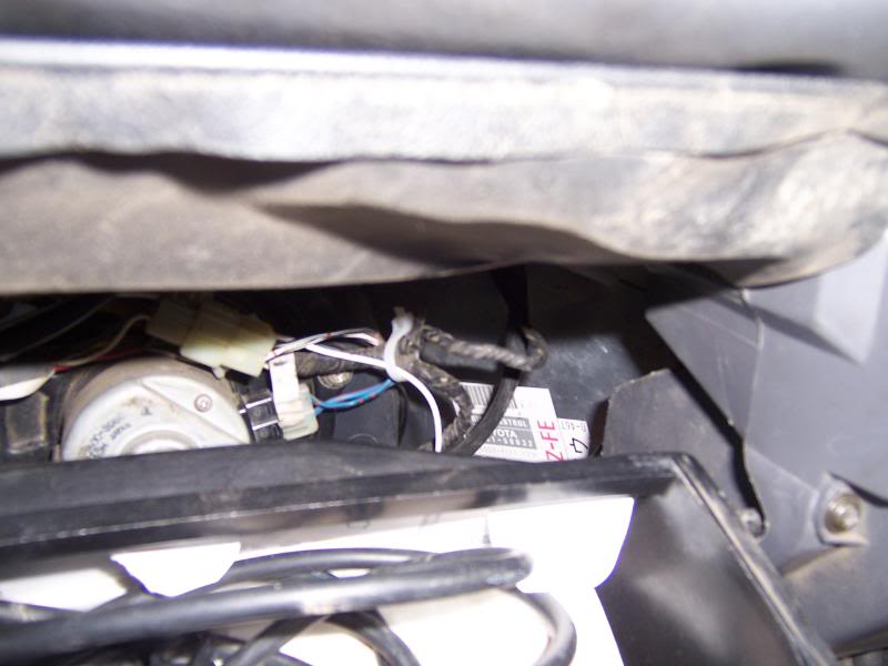

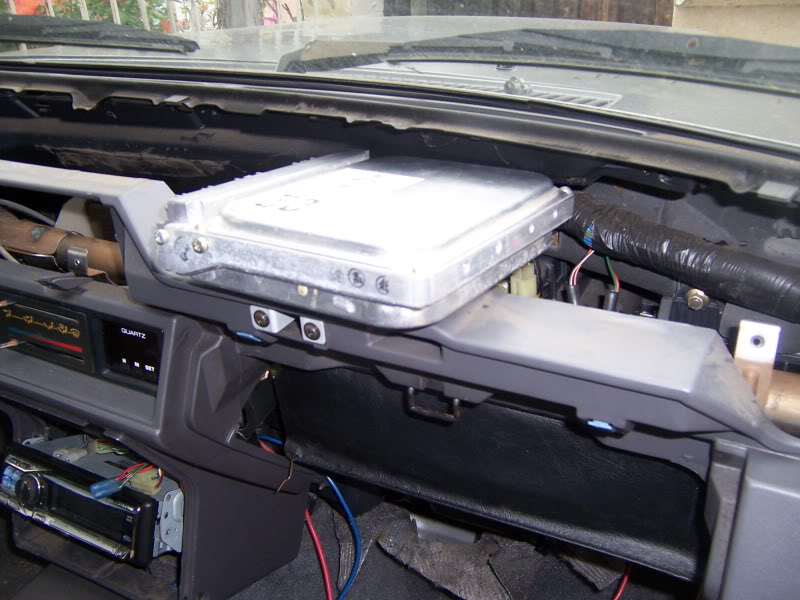

whats up toyminator havent seen you around for a while ?
i mounted the ecu behind and to the right of the glove box .just made a couple brackets and mounted it ..

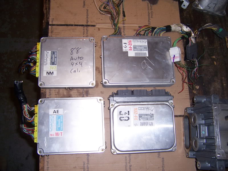

whats up mr rbx ? thanks for those diagrams , there nice , ill ship it back after a while .
i also saw coraxs thread but the ecus are much bigger than his .
LS top right about 1.5 " longer and 3/4 wider and 1/2 thicker ,sc bottom right 1' wider 1/2 longer and 3/4 thicker.. obviously with out the plugs also.

now the 5vz ecu is the exact same size as the 7m ecu .
