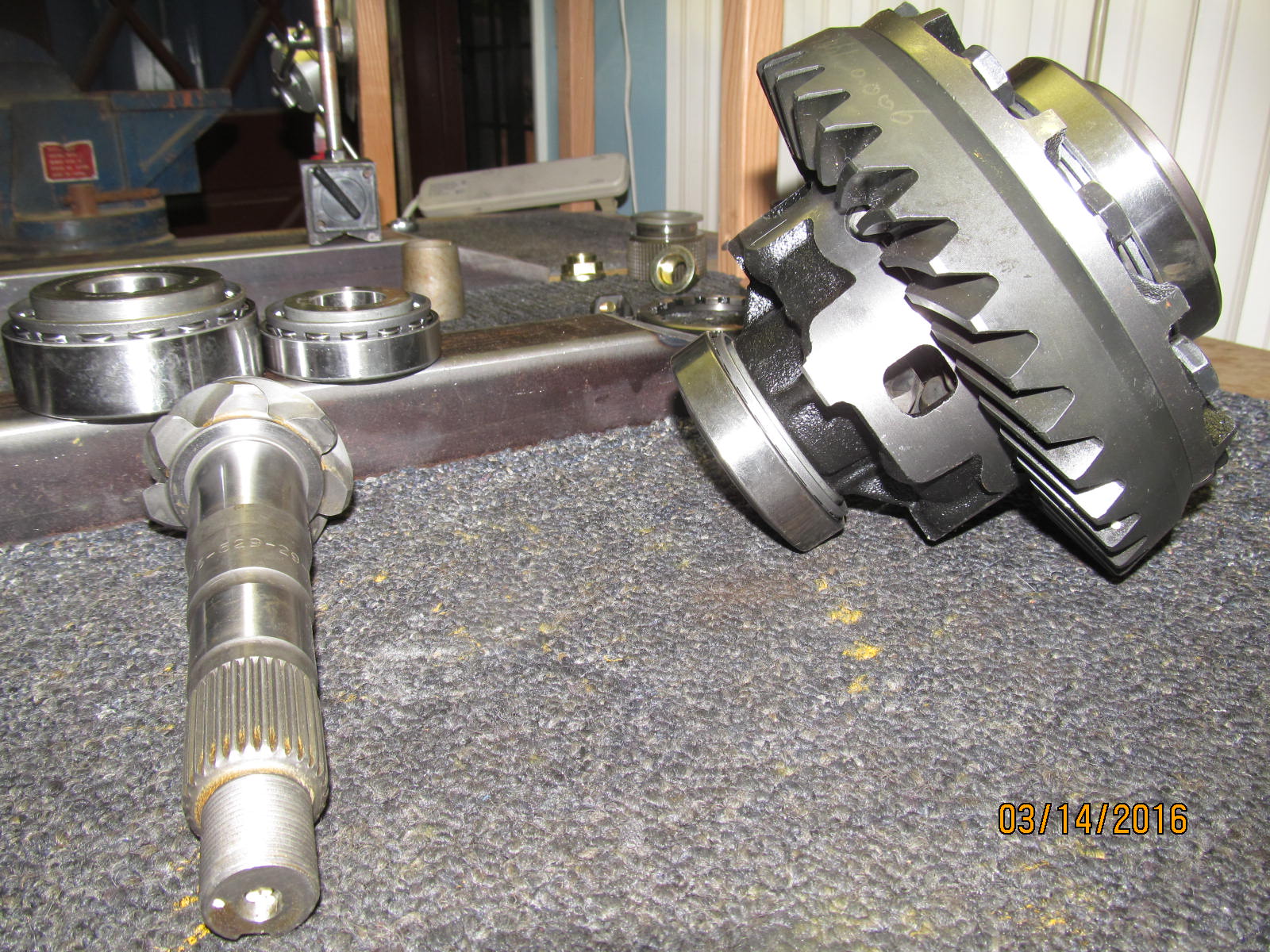

Hi rust-
Thanks!
none flexing yet but believe me the rears....and front flex plenty I was told by someone watching me going thru a tight section. The front shackle works just fine on earlier trucks.
thumbnail test.....my 1st time. random photo
Attached Thumbnails SAS FJ60 with axle housing flip and front shackle for my 2001 Tacoma-img_9574.jpg
