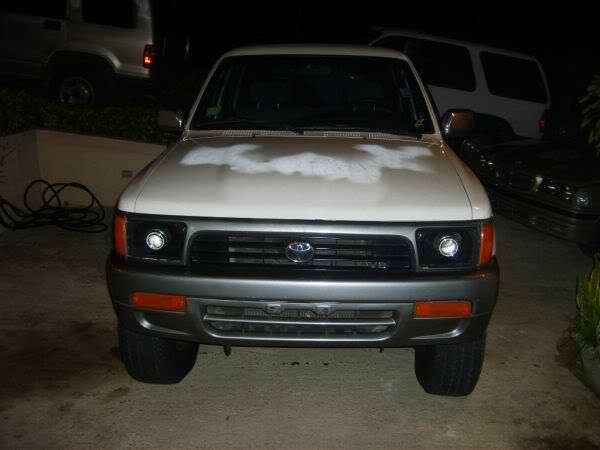

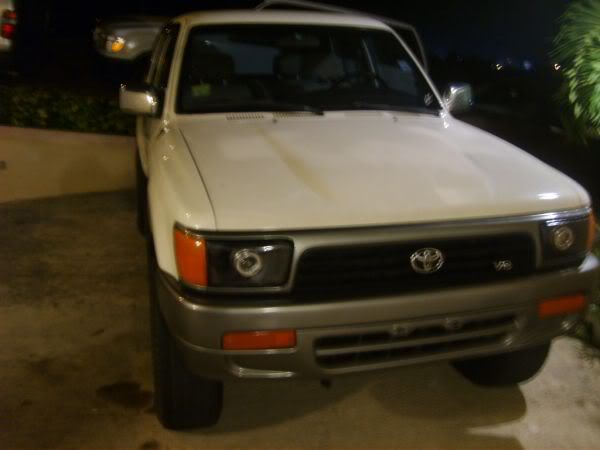

I've grinded a little the shields and I think now the output is better:
I've made definetively bases for the modules, with 1mm think sheet metal.
And also added the high beam modules
Now I only have to make the headlight masks with fiberglass.
What do you think?
I'll try to take night pics.
David

I'll try to make a fiberglass mask with the OEM headlamp shape but with the two holes needed. I think I'll look good hehe.

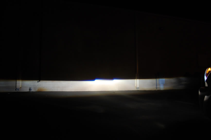

Ops sorry, I didn't post a nice pic...
It's about 100ft of the wall:
Two weeks ago I made a 5h night trip and I'm in love with HID's. I didn't miss the high beams in any moment, but they're so well aimed that they reach where the HIDs end...
