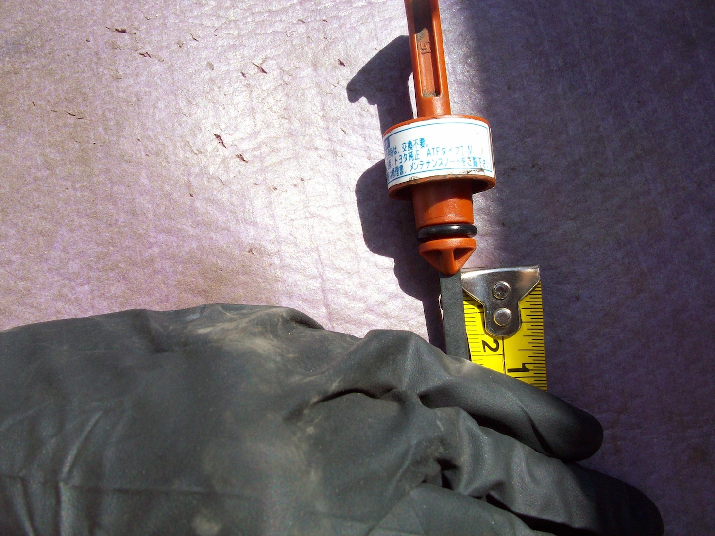

I measured from the bottom of the handle:

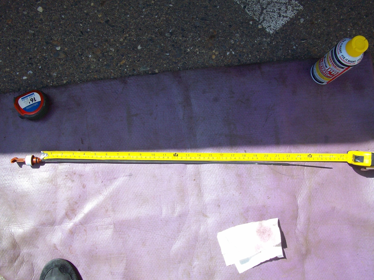

Total length is about 26":

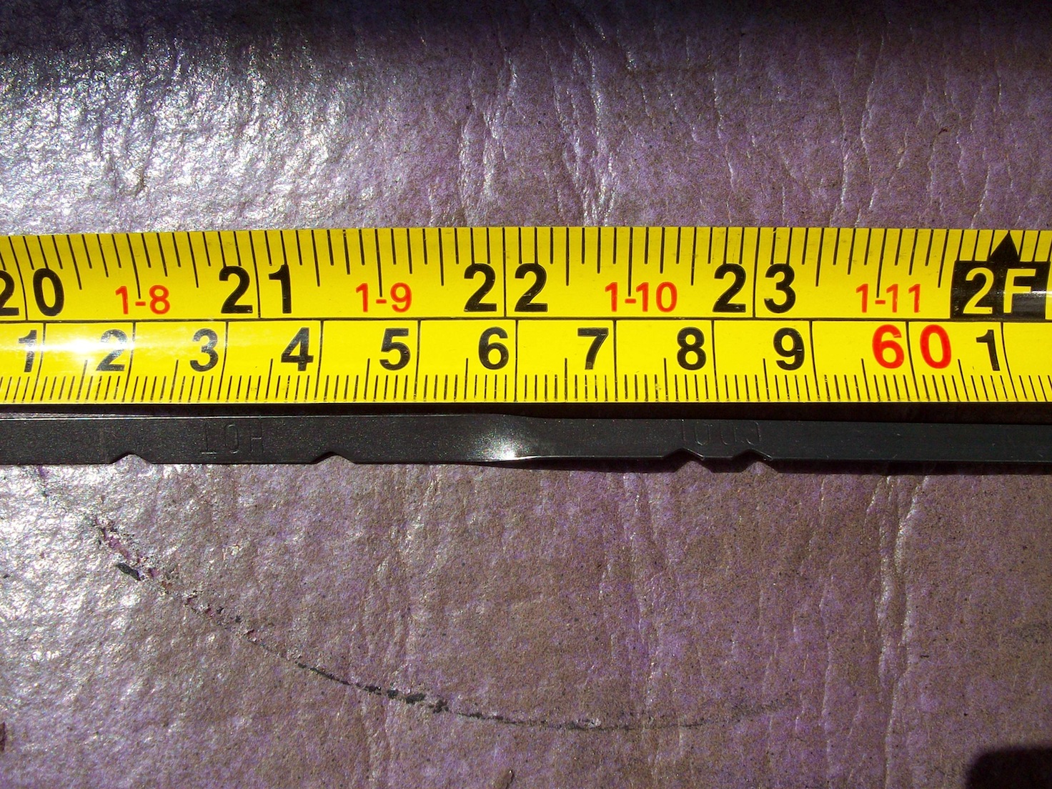

The Cold Marks are roughly 22.75" and 22 15/16". The picture is a little off since it shifted.
