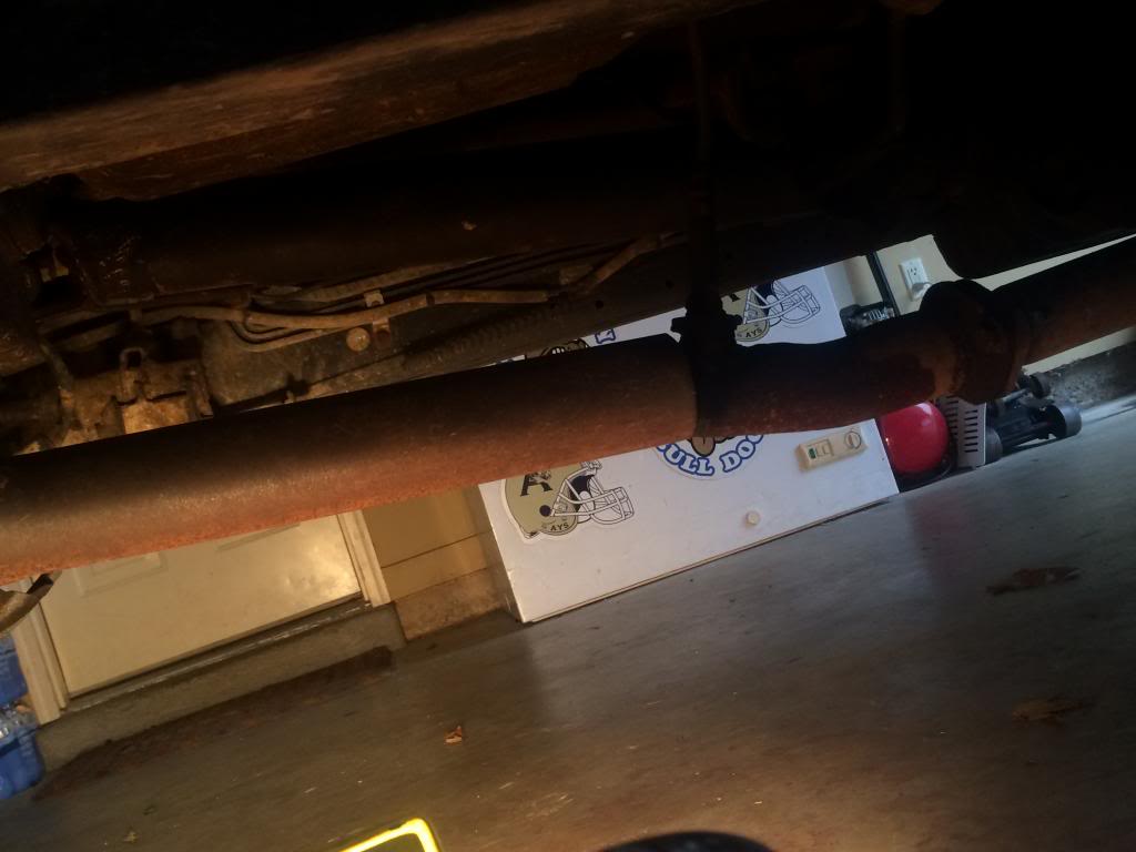

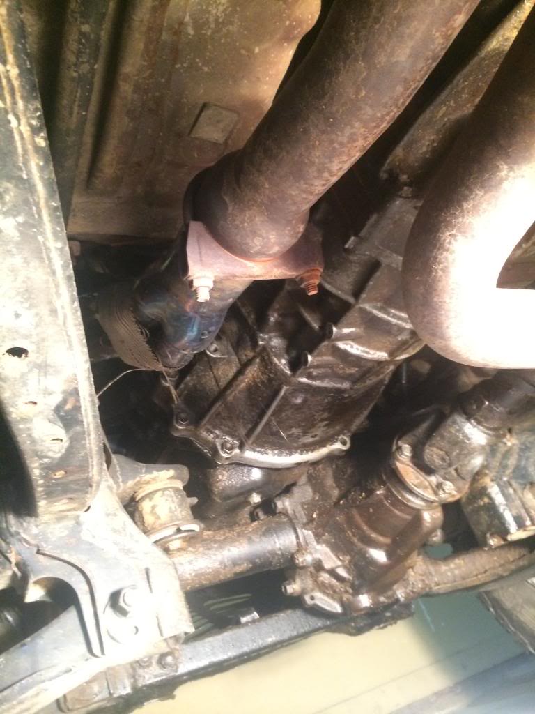

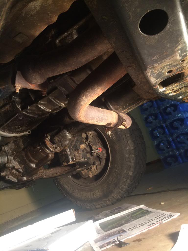

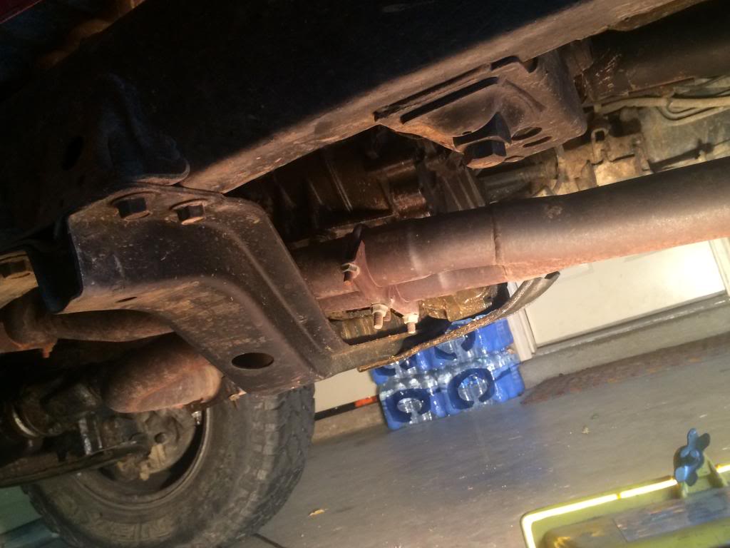

Don't mind the messy truck.. These pics were all pre-cleanup:
The pics should explain themselves, but the last pic shows the 2.5 in y pipe end before the stock location of the catalytic convertor, which I removed. This resulted in a very bootyjank setup, indeed.
This was all in a kit from the Downey factory, so any questions regarding specifics, I probably can't answer, but I can help whenever I get around to installing a new muffler!
EDIT: Chances are, I'll end up going with a 2.5 in and out muffler to reduce the amount of work needed, as well as remain valid whenever the 3.4 indubitably comes around!
