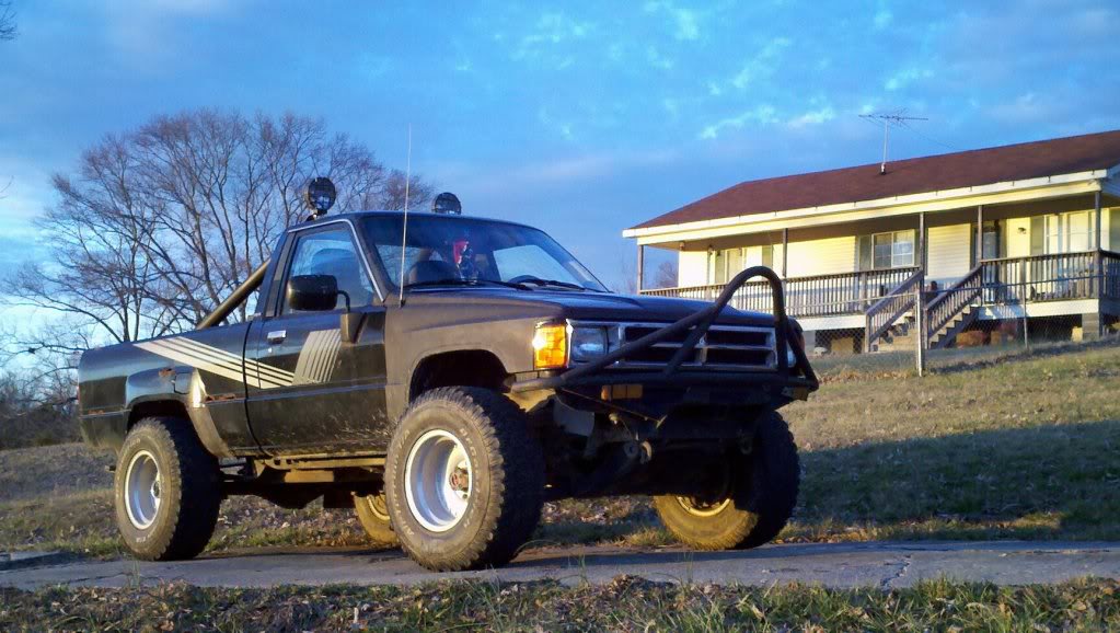

What all is Required to convert my side marker lights into turn signals? I have a 87 pickup, only im using the marker lights off a 86, no difference i can see between the two. I have a trail gear bumper and just want a cleaner look without those huge blinkers zip-tied to the bumper. Any help/pictures is greatly appreciated. This is how my tuck sits when i put on the 32's. Roll bar isn't fully bolted in just yet.
