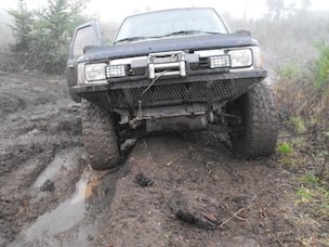

Old 12-03-2011, 12:16 PM
ThatGuy1295's Avatar
Join Date: Jan 2011
Location: 46 50' 36.82'' N 122 19' 41.01'' W
Posts: 1,746
Received 6 Likes on 5 Posts
Attached Thumbnails IFS wheelers-dscf0002-5-.jpg   IFS wheelers-dscf0012.jpg   IFS wheelers-img_0216.jpg
