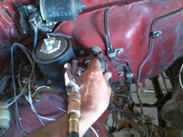

John Halverson...The following picture is from an 87 truck I have. I dont have access to a 95, but the Fuel Return Line is either on the fire wall and I have seen them on the Inner Fender on some models.
There are two rubber lines coming off the back of the Fuel Rail. One is a vacuum line and is the smaller hose that runs to a VSV valve. The larger rubber line is the Fuel Return line and should be connected to one of the metal lines. If the large rubber line is connected to the Plenum, that could be a possible cause of fuel running out the tail pipe. The fuel pump moves a lot of fuel.
My pointer finger is showing the larger fuel line and probably where your Return Line is. I am not sure on the 95s.
