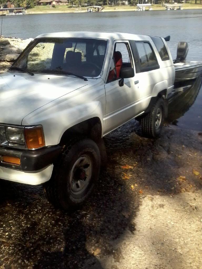

I have used 22re and 5 speeds to pull my bass boat and it is a 16 foot fiberglass and heavy, cant think of the weight right off, but if you are pulling bikes and sleeping in the truck, I cant see you really pulling that much more weight. We have some hills where I live and a few of them can cause me to slow down, but on interstates and major highways I dont have any problem.
I wasnt into Toyotas when I hauled my two 3Wheelers motorcycles (250R) and that has been several years ago, but I was about into the same situation and rigged my trailer to haul alot of the camping gear as well. If I had those bikes, trailer, and camping gear today, I wouldnt be the least bit worried about pulling it with the 22re 5 speed. The trailer was a 5x10 ( could of been a little larger) if I recall right with a sigle axle 15inch rim and tire.
I have pulled my boat with a truck and a 4Runner so it is still going to be your preference of people hauler or equipment hauler. Either will do fine for what you are wanting to do.
Edit...If I am on a steep boat ramp I do have to use Low Range to get off of the ramp. If you are getting back into some steep hills and have a ways to drive that might would get old having to creep along the whole way once you got off of the highways to your camp site.

This ramp is steeper then it looks and to give you an idea of what I pull with it, 16ft fiberglass. I have pulled a 19ft bass boat on this same ramp and with it, I use low range. If I was going to pull the 19ft boat all the time, I would look into trailer brakes but otherwise it does fine. If you are going to do alot of heavy trailer pulling, set your truck and trailer up with electric brakes. Sooo nice to have trailer brakes like I have on my 3rd Gen Runner.

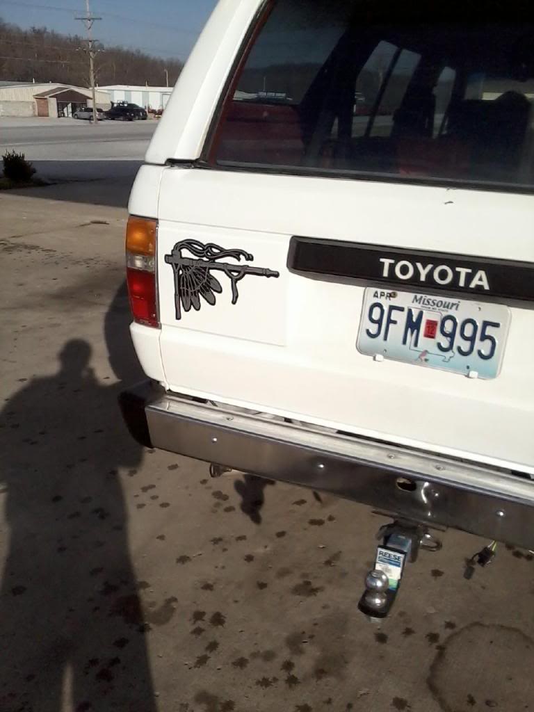

On some runners they came with a frame mounted reciever hitch. They are hard to find and just recently seen a runner that had one on it as well. The second gen runners seem to have them more available and the salvage yard tells me they arent interchangeable from first to second gen runners. I had a 91 Extended Cab with the same drive train and it pulled the same boat as well and did great.
If you do go with a runner, start looking now in the yards for the frame mount reciever assembly. I have never checked aftermarket so it might be more easily available. I like the factory mount and can get the hitch with the drop or rise that I need. I dont have a good pic of the entire assembly at this time but can get a pic of it later if needed.
