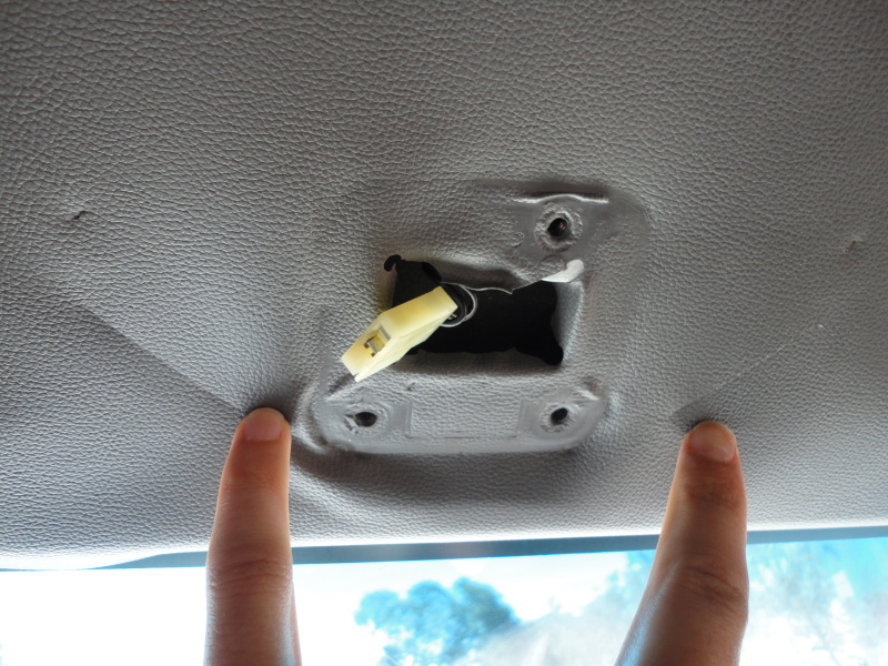

Using the NEW Housing, press (gently) into the headliner the shape of the two new Mirror's light housing. While the imprint is fresh, cut the holes with an Exacto/Utility knife. Repeat this process for the *two far screw holes* on the 4runner housing (The threads should be there, in your cab roof) Connect the wire, tighten down!

NOTE: When you pull the cover of the 4runner mirror, MAKE SURE you get the *two far screws*. These are COURSE thread screws, and need to be installed in the far screw location!
