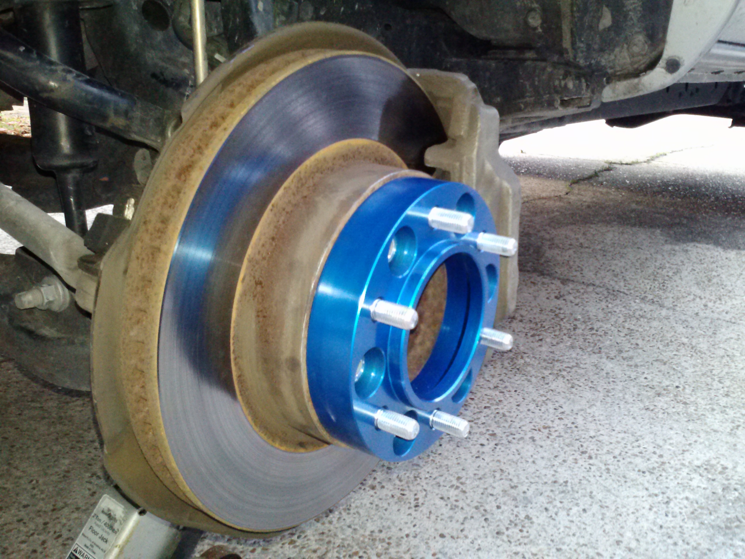

I have a 2008 4Runner Sport 2WD and with stock 265/65/17s. I installed a 3/2 spacer lift. I intended on installing 285/70/17s Bridgestone Dueller Revo2 A/Ts and doing body mods and trim. I know this will affect the Camber adjustment and I do not want to risk eating up 1000$ in tires. These mods are for looks. I do not go off road, but do go on trips in the snow and to the mountains from time to time.
My options as I understand are a wheel spacer install (1.25" on front and 1.50" on back, different sizes to even out the factory recess) or aftermarket UCA's.
I want the spacers regardless (eventually) to widen the stance. With the wider tires will 1.25/1.50 be too much? Should I get 1.00/1.25? I want to avoid rub. But will the spacers also free up the camber adjustment to forgo the need to purchase a $400 set of aftermarket adjustable UCAs from Uncle Bob? This is my main question, reiterated: will wheel spacers somehow allow more camber adjustment and eliminate the need for aftermarket UCAs?

Wheel spacers are not going to change any of your adjustable suspension geometry, at least enough to where it's noticeable or to where it's going to throw things our of whack. The ONLY thing it might do is make adjustments more sensitive since you're adding extra distance between the adjustment area and where the wheel is mounted, but not enough to where it's going to make alignments impossible or correct an issue somewhere else and make alignments possible.
After I installed 265/75/16's I put 1 3/4" Spidertrax on my 2006 Taco. I wasn't having any rubbing issues, on the UCA or the body, I just didn't like the way the new tires looked tucked completely in the fender wells. I installed spacers purely for cosmetics, to give the truck a wider stance. Of course, now, the fronts will rub a little at full lock either way when reversing (only when reversing oddly enough ). I also have a 2.5" spacer lift too, if that means anything to you.

It's possible that you will need both, for different reasons. With stock wheels, 285's will rub on the upper control arm, therefore you need the wheel spacers to give proper clearance. Once you get at/above 3" of lift, it becomes difficult to get the alignment back into spec. With the 3" spacer lift, you should be able to get it close enough (you might notice a little wandering, but no uneven tire wear). Aftermarket UCA's would allow the alignment to be brought back into spec.
