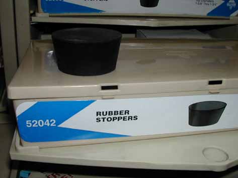

Here come all the pics...first two are for you, Momo. Pretty self explanitory...and yes, that is the same rubber stopper shown in the pic that is on the plate...just looks a lot different compressed. I'm sure there are many other ways to do this, just one way to approach it for about $3. Enjoy...
Attached Thumbnails 4th Gen w/ 33x12.5's-new-rubber-stoppers.jpg

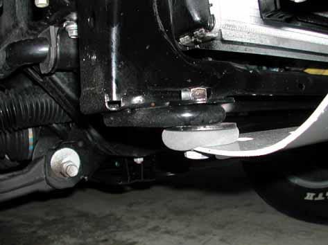

Plate Mount
Attached Thumbnails 4th Gen w/ 33x12.5's-new-skid-plate-mount.jpg

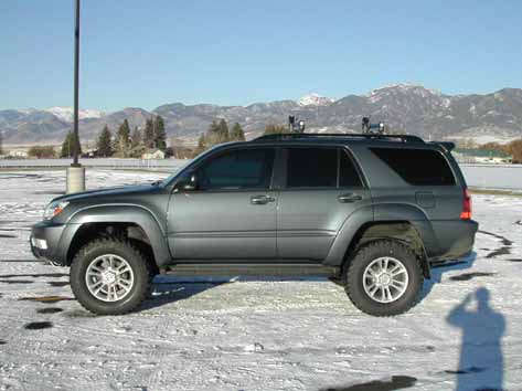

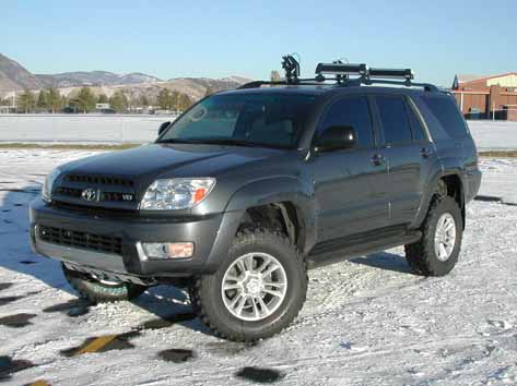

side shot
Attached Thumbnails 4th Gen w/ 33x12.5's-new-side-shot.jpg

and another
Attached Thumbnails 4th Gen w/ 33x12.5's-new-side-shot-direct.jpg

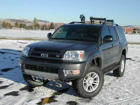

yet another
Attached Thumbnails 4th Gen w/ 33x12.5's-new-angle-front-shot.jpg

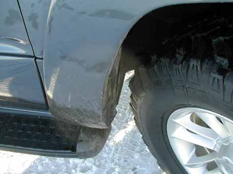

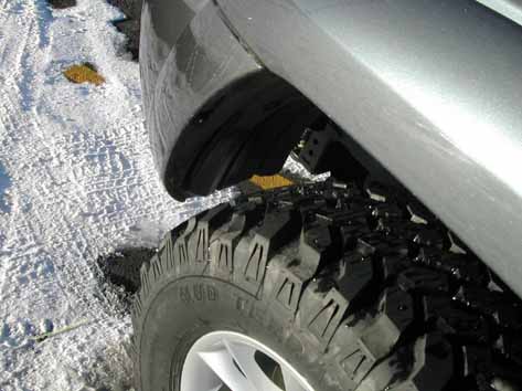

fender trimming
Attached Thumbnails 4th Gen w/ 33x12.5's-new-fender-trim.jpg

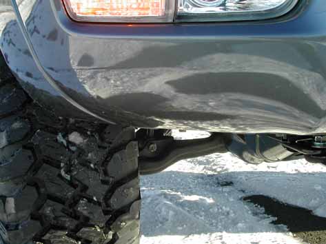

front trim/cup removal shot
Attached Thumbnails 4th Gen w/ 33x12.5's-new-front-trim.jpg

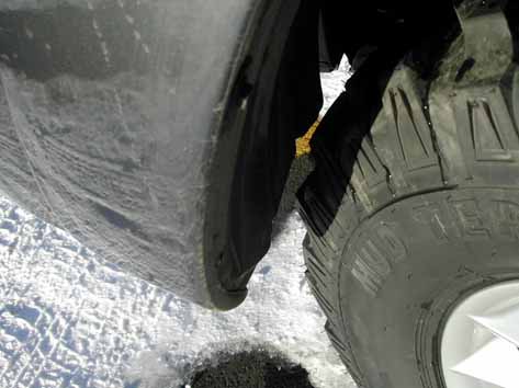

Full turn left
Attached Thumbnails 4th Gen w/ 33x12.5's-new-full-wheel-turn-left.jpg

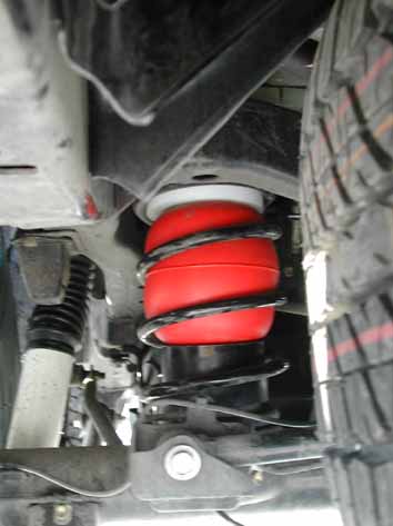

PP air bags
Attached Thumbnails 4th Gen w/ 33x12.5's-new-air-bags.jpg

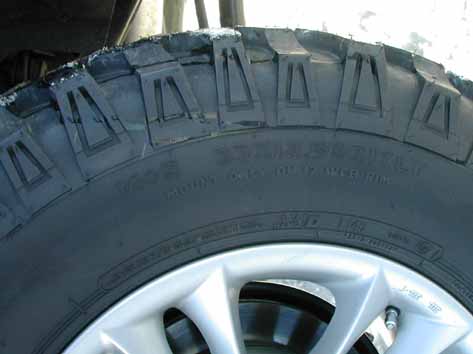

new tire size
Attached Thumbnails 4th Gen w/ 33x12.5's-new-tire-size.jpg

Well-
Hope I was able to provide you with some helpful info. The 33's actually don't look that big, and with my offset on the 17x8.5's, they barely stick out too, which is nice. The PP air bags are for an 02 runner, but worked fine. Just gotta trim the bum stops a little and slid em in...20 min install, and supposedly good for 2-3000 lbs. Gives me almost 5 inches of adjustable travel in the rear and really stiffens it up...exactly what I was looking for. If you take your time when trimming, you'll never even know the cups existed in the first place. I would almost guarantee that with a 2" body lift, you could get 35's if you wanted. The front spacer actually adds over 3" inches once installed. For $82 the air bags are a steal. I don't know much about Pro Comp Mud Terrains, but they seem to be a good tire??? Ride is pretty smooth, and traction is great...a little noisy though. What do you guys think? I like the fact that they are eight ply...news to me. Not a lot of options on a good all terrain/offraod tire for 17's, thought it is getting better by the day. Hope this was at least informative. I'm all ears.
And thanks Momo, let me know if you have any further ??'s. I'm sure you could just use some rubber bushings as spacers too.

Sorry about my signature...is there any way to turn it off for good? SorMy bad on the tire shot showing the dimensions that didn't come thru...you get the picture though...33's no prob. Later.
