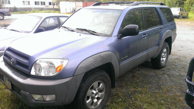

Title says it all. I think I broke the internet trying to find out if anyone has done this before when an engine goes tits up (serious rod knock) I know anything is possible with $$$, but before we go there lets talk options.
Vehicle is a 2003 4Runner SR5 (vin says sport though)
1.) Why don't you just go to a salvage yard and pick up a running one. I live in the interior of Alaska. A quick search shows no 1GR-FEs in the state
2.) Why don't you buy one and ship it up. Not a bad idea. So far the average cost with shipping and core it $4000.
3.) Local rebuild is around $3500 and can go up.
4.) Buddy has a complete 2UZ-FE, and by complete I mean... Engine, Trans, Transfer case, harness, cluster and computers...cost to me for all of that $1000
So, I ask the experts (I am mainly a Land Cruiser guy and we swap stuff like diapers on babies) if they know of this even being basically a bolt in operation, if the engine and chassis harnesses are separate and interchangeable. Ideas, thoughts? :flamewar:
