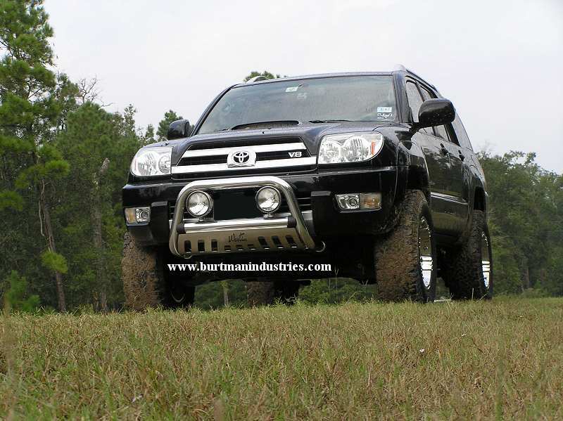

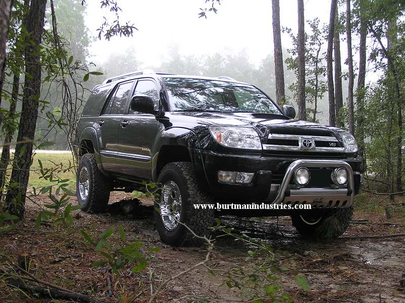

I have just lifted my 2005 Sport 4Runner 4.7L V8 4 1/2 inches {3" Cornfed suspension and a 4Crawler 1 1/2" body} and installed BFG 285/70/17's on Incubus 17x9" rims. The speedo is now "off" by approx 7%. I now would like my ECM to know what speed that I am REALLY traveling for purposes including but not limited to: speedpmeter accuracy, odometer accuracy, mileage computer accuracy, transmission shift points, fuel/air mixture, anti lock braking {I am not sure but this may have its own input from each wheel independent of the speed sensor}, skid control, etc. The only mods that I can find are UNI CHIP's, and it is priciy at $900 but makes for all kinds of tweeking ability and Dakato Digital has a device for $79 that installs bewtween the speed sensor and ECM that just changes signal through the setting of dip switches. No one else covers the new in 2005 4.7L V8.

Glad to help ya out. I know you were looking to get your pictures hosted, so I resized them and put them up for ya. Added the Burtman stamp to them so they don't end up on ebay, hehe.

Nice 4R. Do you need spacers for your wheel w/33".
Old 10-19-2006 | 06:01 PM
4unner4life's Avatar
Joined: Feb 2005
Posts: 554
From: Raleigh NC
off topic but, Wow that looks good!

No spacers - wheels are offset 1 inch more than normal and are 9 inches wide.
