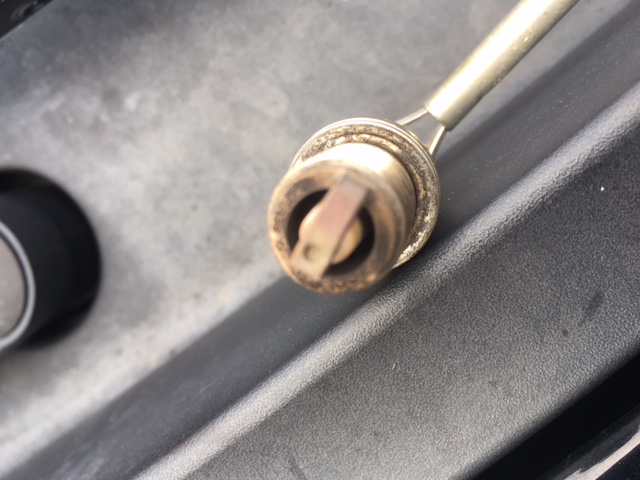

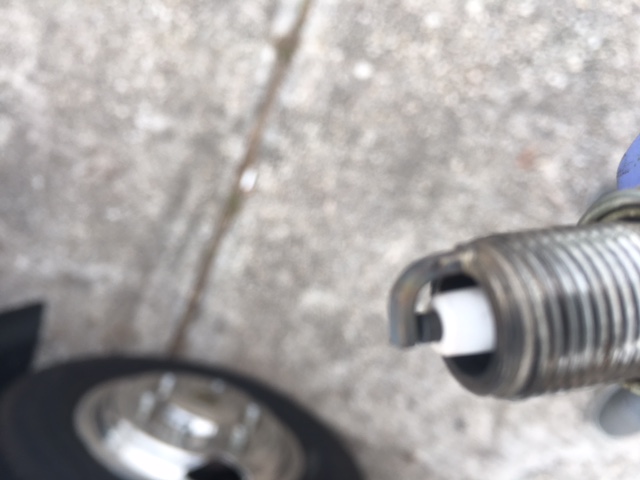

ok put 75 miles on truck last night.Check engine light came on,its flashing code 25,which I believe is lean condition.

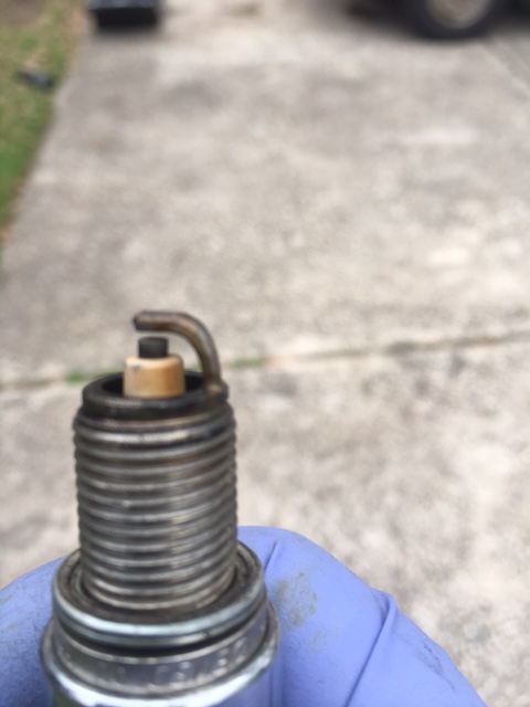

Took truck for short spin this morning and pulled plugs to get ready for leak down and found something disturbing.

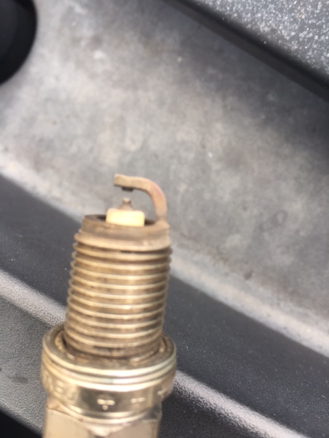

Spark plug1,2,5 and 6 looked fine,spark plug 4 was dark and had some oil on it like before,but sparkplug 3 is what is freaking me out.The gap in it was huge compared to others,it had a growth sprouting up from center electrode,and ground electrode had a round indention in it,wtf?

EDIT!! THINK I FOUND PROBLEM ON WHY PLUG ON 3 WAS ALL JACKED UP,ADVANCED AUTO HAD WRONG PLUG STUCK IN RIGHT BOX AND I DIDNT NOTICE IT WASNT THE SAME PLUG.THE OTHER 7 I RECEIVED FROM THEM WERE THE RIGHT PLUG

I was ready to cry for ya man, lean code and description of a melted spark plug, then I saw the photos and could have fell out of my chair laughing.
Always always check the gap on spark plugs before you put them in. And double check the part numbers stamped on them..
#4 is either oil fouled or showing rich. (Sorry I'm color blind) would you guys say that's more orange, red, or brown/black.
Try cleaning up the sparkplug threads in the head, if they look like the sparkplug it's getting a bad ground and loosing power. This will rule out if it's fuel fouled. If it's not fuel fouled it's ready to come apart and replace the valve seals, maybe even the guides. At which point you have to decide what your budget is, a new drop in head, full machine re work, or doing an in place valve seal replacement.

Whatever that was wet on the plug is gone now,dont know if it was gas or oil.All plugs and wires had already been installed before advice in cleaning threads,will have to wait another day.
On to the leak down test.Had pretty much the same leakage shown on gauge for all cylinders,30-40%,I got different readings depending on how quickly I could get hoses coupled together without air escaping.
So the main thing to come out of this test that I didnt get the last time is this time I heard where the air was escaping from.Cylinders 2,3,5 and 6 I could hear air escaping when I took off oil cap to the engine.Could not hear anything from 4 or 6.I thought I might have heard a little from 4 but now I think it was my imagination.So what does that mean? I dont know if that means head gasket or something else or maybe thats normal,I'm reading where a small amount is normal.Even with me being able to hear air coming out its not like the gauge was moving past the initial mark,maybe if I kept it hooked up for a long time it might have eventually moved past 30-40%.And you have to remember,on this Harbor Freight tester 30-40% is still in the acceptable range,with a different tester like a snap on 30-40% would be really bad.

You will want to get those threads cleaned up before moving on in the decision process. You could provide an alternate ground source but I don't think there is any room to get something on the plug like a jumper cable or big alligator clip.
The wet did it evaporate or did you wipe it off? If it evaporates it's not oil. That would be a good thing if it was just fuel, it indicates either the bad ground or a leaking injector as the cause both much more simple than valve problems.
