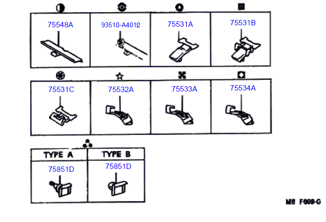

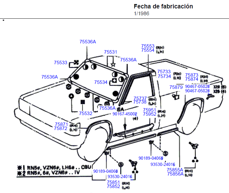

Images
ycmike here's the graphics:
Attached Thumbnails Water leak behind glove box!-windshield.png   Water leak behind glove box!-windshiel-2.png

Old 06-16-2010, 11:23 AM
ycmike's Avatar
Join Date: Jun 2010
Posts: 36
Received 0 Likes on 0 Posts
Thanks but everything I see in the pictures looks like the chrome trim, or plastic clips to hold the trim in place.
I was wondering what the "rubber band around the windshield" or "windshield dam" part might look like.
