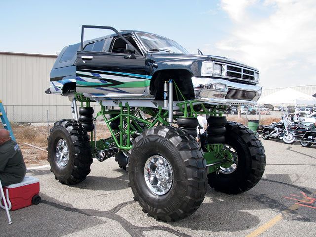

This guy has it all figured out ...
Name:  34358d1287268700-monster-4runners-monst4rs-0802mt_03_z-monster_minitrucks-toyota_4runne.jpg
Old 07-20-2014, 07:24 PM
Seeing how that thing would probably tip right over at the slightest angle, I'd doubt that thing has ever seen anytime off road but alotta time in the asphalt jungle...
Old 07-21-2014, 07:12 PM
rworegon's Avatar
Join Date: Nov 2010
Location: Columbia River Gorge, Oregon...east side
Posts: 5,125
Received 2 Likes on 2 Posts
Hideous, absolutely hideous.
Old 07-21-2014, 07:22 PM
daved5150's Avatar
Join Date: Jun 2008
Location: Buffalo, NY
Posts: 463
Received 0 Likes on 0 Posts
x2 on that dude....uugghhh!!!
