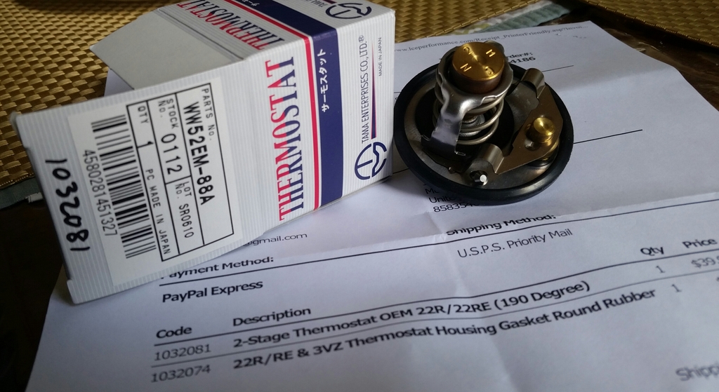

Received my two-stage thermostat fromLC Engineering today. T-Stat has 85/88 degrees C stamped on it and that converts to 185/190.4 F, which makes sense.

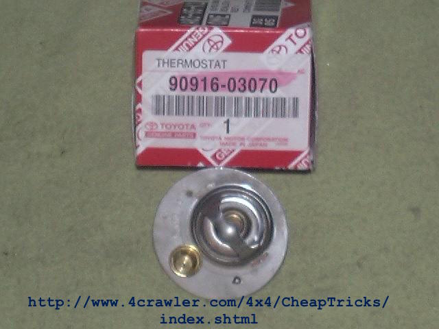

However, I'm wondering... Picture of Toyota factory part on 4crawler's site shows a Toyota package, while actual I got from LC Engineering has a Tama (made in Japan) package with Tama PN WW52EM-88A. Could this be that Tama really manufactures the part for Toyota, OR LC Engineering is selling less expensive alternative for the price of Toyota OEM?

Toyota Packaging Picture on 4Crawler's Site:

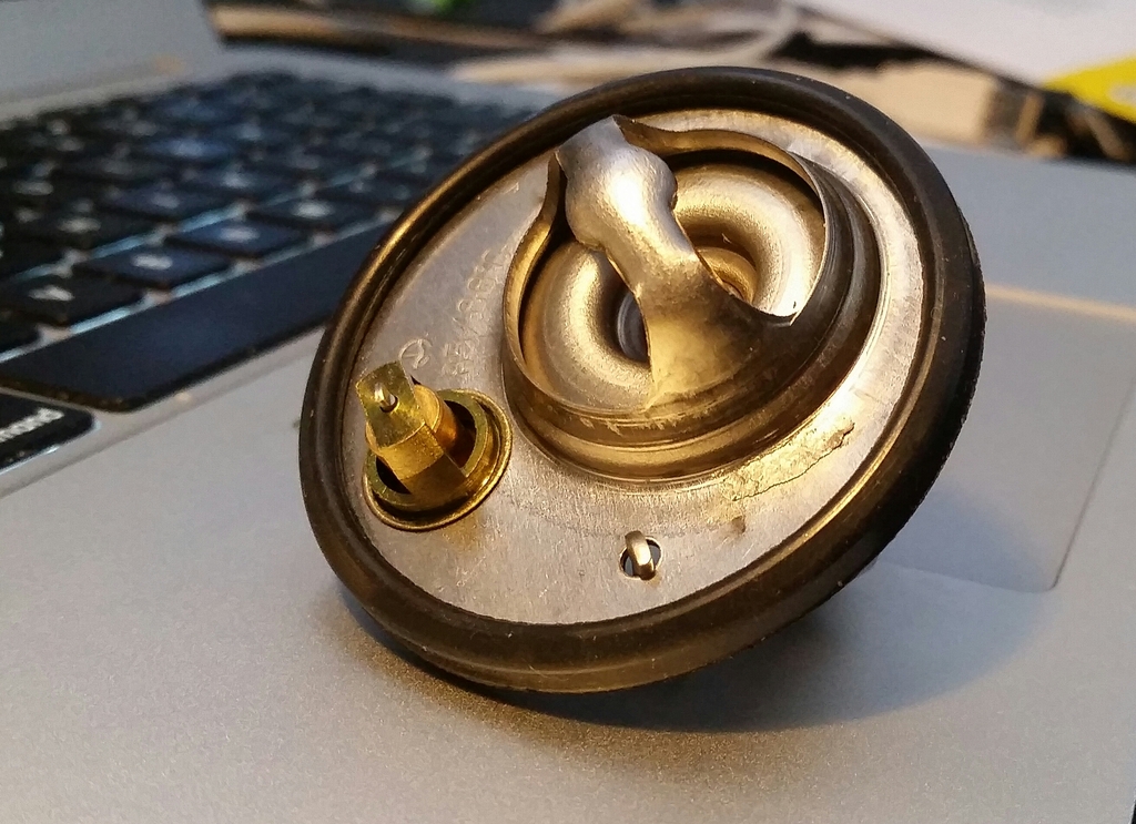

Also got gasket. It wraps around the edge of the T-Stat like below. Do you remember yours looking like this?
Originally Posted by chuckross1957
The original Mazda two stage stat looks strikingly similar to the Toyota two stage stat. http://www.clubprotege.com/forum/sho...age-Thermostat It makes you wonder if they were both manufactured by the same company.
chuckross1957,
Perhaps the above pic answers what you're wondering about?

I'm back to using the Stant 180 degree superstat. It seems to be a better choice for me in my climate and because I'm running such a large gap (.044) on my spark plugs. If I'm ever in a situation where I have frequent sub zero temperatures, I'll swap back to the two stage stat. I did find an interesting document linking the Tama part # to the Toyota part # ( it is in the cross reference section) and some Mazda p #s. http://www.nitomainc.com/npsp2.php?m...o=BP6F-15-171A

As far as the Tama brand, I don't know if they are OEM for Toyota. I just went to their website and can only go by what it states which is the parts under their brand are made by OEM's. And yes, the gasket around the thermostat is needed and my Toyota cam with one.
http://www.tama-e.co.jp/en/business.html
I guess if you were going to look into using a Tama it may be worthwhile looking into an NTC one that is made for Mazda. A friend of mine who is into RX7's had told me that NTC was the OEM supplier for cooling parts. Just a quick search brought up this part no.8AK1151719U which I think cross references to the Tama part no. However, I don't know if it comes with the gasket or not. I don't know how much you paid, but if it's close to the Toyota branded cost, then I would just get a Toyota one. If it's like $20 cheaper then.....I would probably try it! I had no idea about the options when I purchased my Toyota one so I didn't go through that dillema. If the one I have ever goes bad I'm going to pop in one of the KIA ones I got for super cheap. ***CHECK THIS OUT RAY!****
http://www.ntcl.co.jp/en/
***CHECK THIS OUT RAY!**** I know it's just amazon, but the seller is Toyota and says it's a genuine Toyota part, and the picture shows NTC on top!
https://www.amazon.com/Toyota-90916-.../dp/B00OW39HFA
