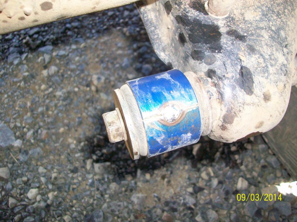

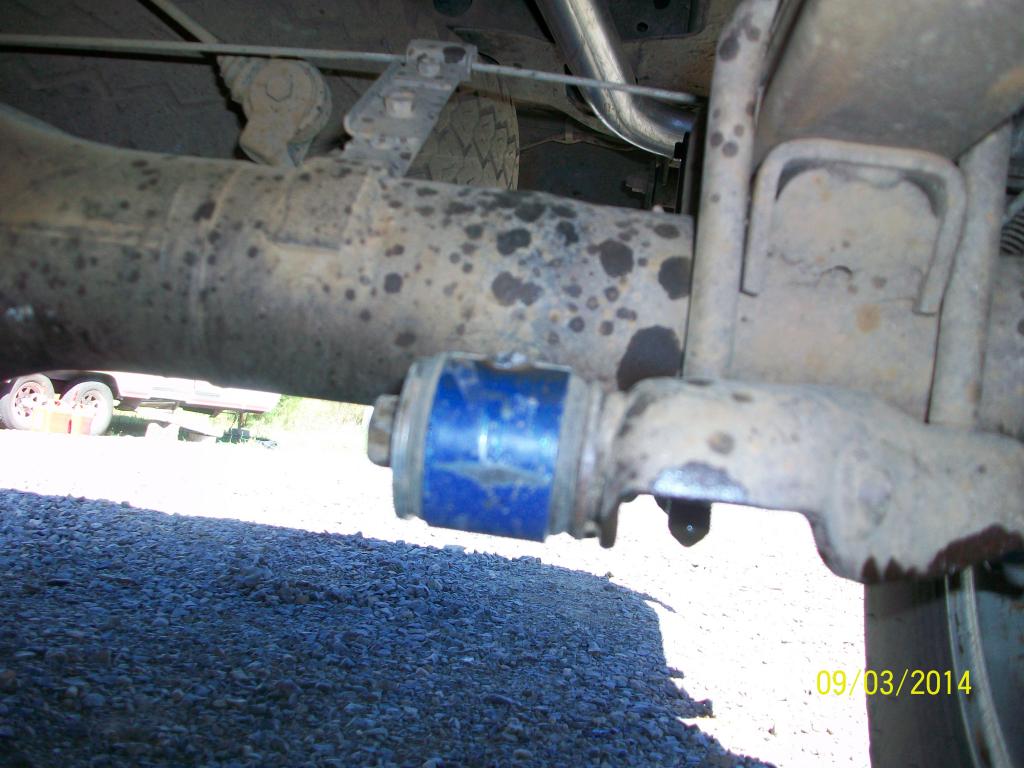

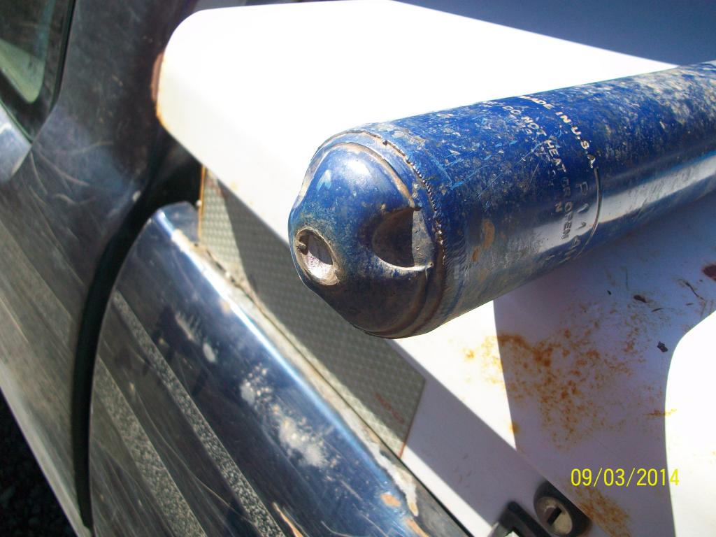

I'm new to this forum, ran across this thread trying to get answers myself. Here are some pictures of mine that has broke.

Thanks for the pictures .
It looks like the rear just dropped down past the the maximum shock extension and ripped the shock apart.
Then it looks like the shock was welded right on the seam where the eye was welded.
Interesting!!

Looks like awfully tiny joints!
Yes, bushings should allow sideways bending and shock should have enough vertical give, UNLESS, shock is too short or too long for the travel. then you put undue tension or compression on weld.
Got stock Height?
Checked actual travel (full-droop and compressed) versus shock specs?
