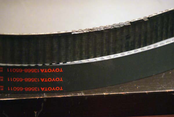

FYI, my truck has 225k miles on it, and the sticker on the engine says the timing belt was done in '92 with 87k miles on it. that means i am at 15yrs and 135k miles on that timing belt. i think its really time to do that timing belt.

and here's a picture of my timing belt (OEM part), taken out with ~135k on it. there are cracks on every single tooth section of the belt and the picture shows the worst part of the belt where it is beginning to deteriorate.
