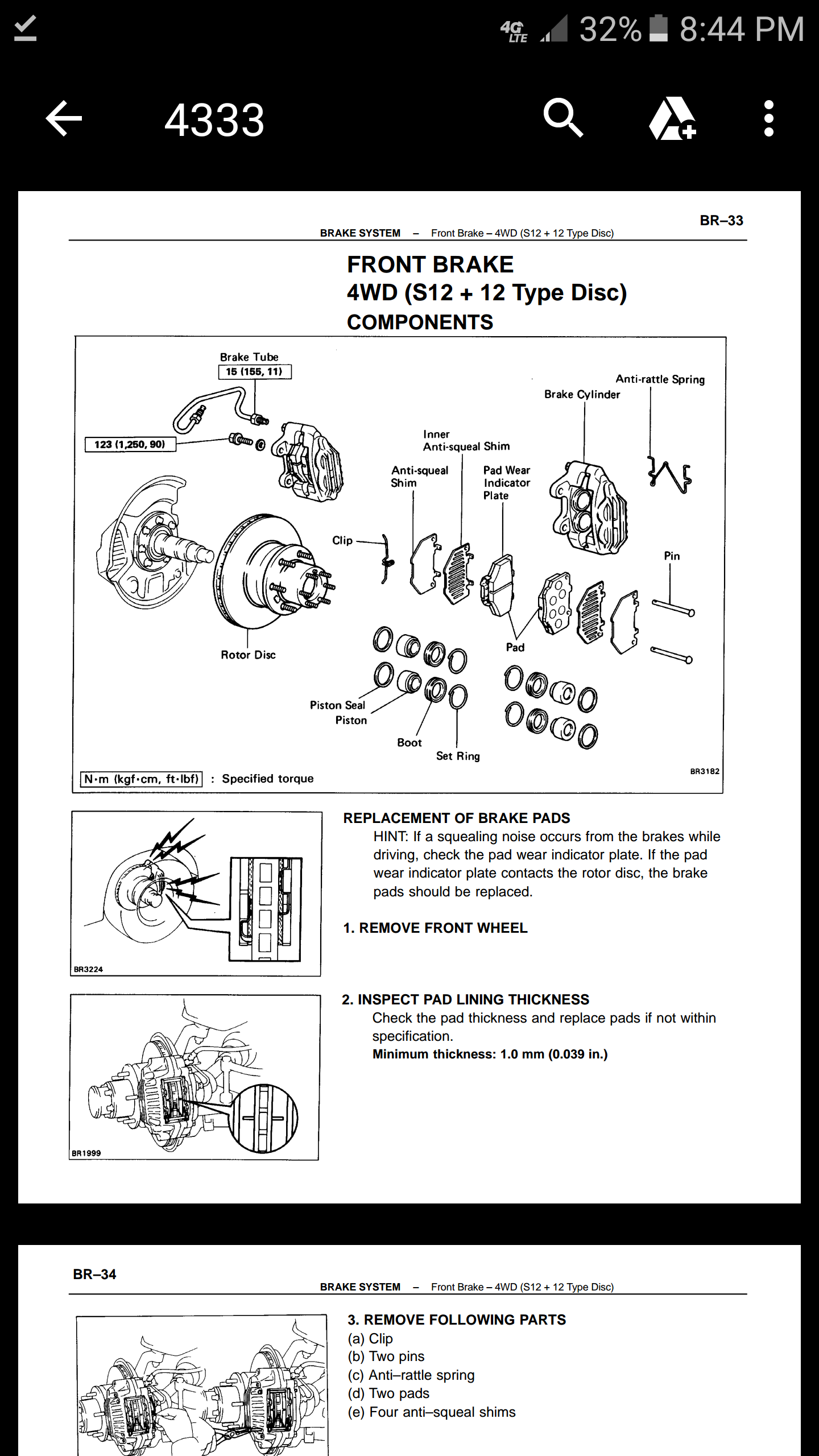

I believe the rotor is part of the assembly based on the manual (photo attached), but I assume they separate because they are sold individually? If you had some old hub assemblies I would certainly buy them, this is just my daily driver while I restore my 83, so I dont want or need brand new ones. ˟˟˟˟ maybe I can use the hub assemblies off the 83?

I was thinking it might be best to buy new rotors and would save a ton of weight on shipping assuming new isn't too bad of a price. I was thinking just the steering knuckle, but I think you'll need the calipers too unless you want to cut the rim off or something like that (assuming the caliper doesn't get too hot). I suspect a plasma cutter would be the best option.
I have a 89 and 90 frame that both frames are pretty bad, so don't really need the front end parts, I have a spare good 91 frame, all 4x4 of course. Looking online, it looks like each side goes for quite a high price. Not looking to get rich or anything off my old parts so I'll have to think on the price a little. Let me know what all you're going to need since right now it's a complete front end / suspension setup. Hopefully the bolts are not too rusted up, since both the trucks sat a while before I got them.... and now they are sitting again lol.
